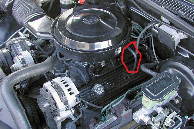

However, what is this hose circled in red? (not my vehicle)
I know it's not the PCV valve because that is on the passenger side and on that side it connects to the front of the TBI. This hose connects the valve cover to the throttle body spacer. I noticed that the elbow that connects that hose to the throttle body spacer is severely chewed up leading me to believe that if it's a vacuum line, this could be an issue. What are your thoughts? Thanks in advance!

its just a breather tube its not important. i had a pan style air cleaner on mine. until i took the time to add a port on the lower pan i left that hose hanging.
