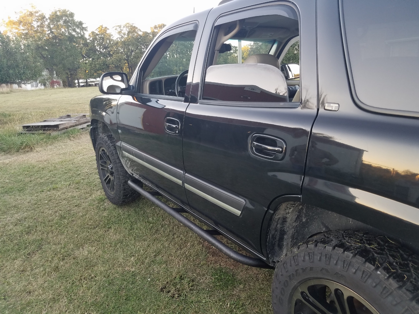

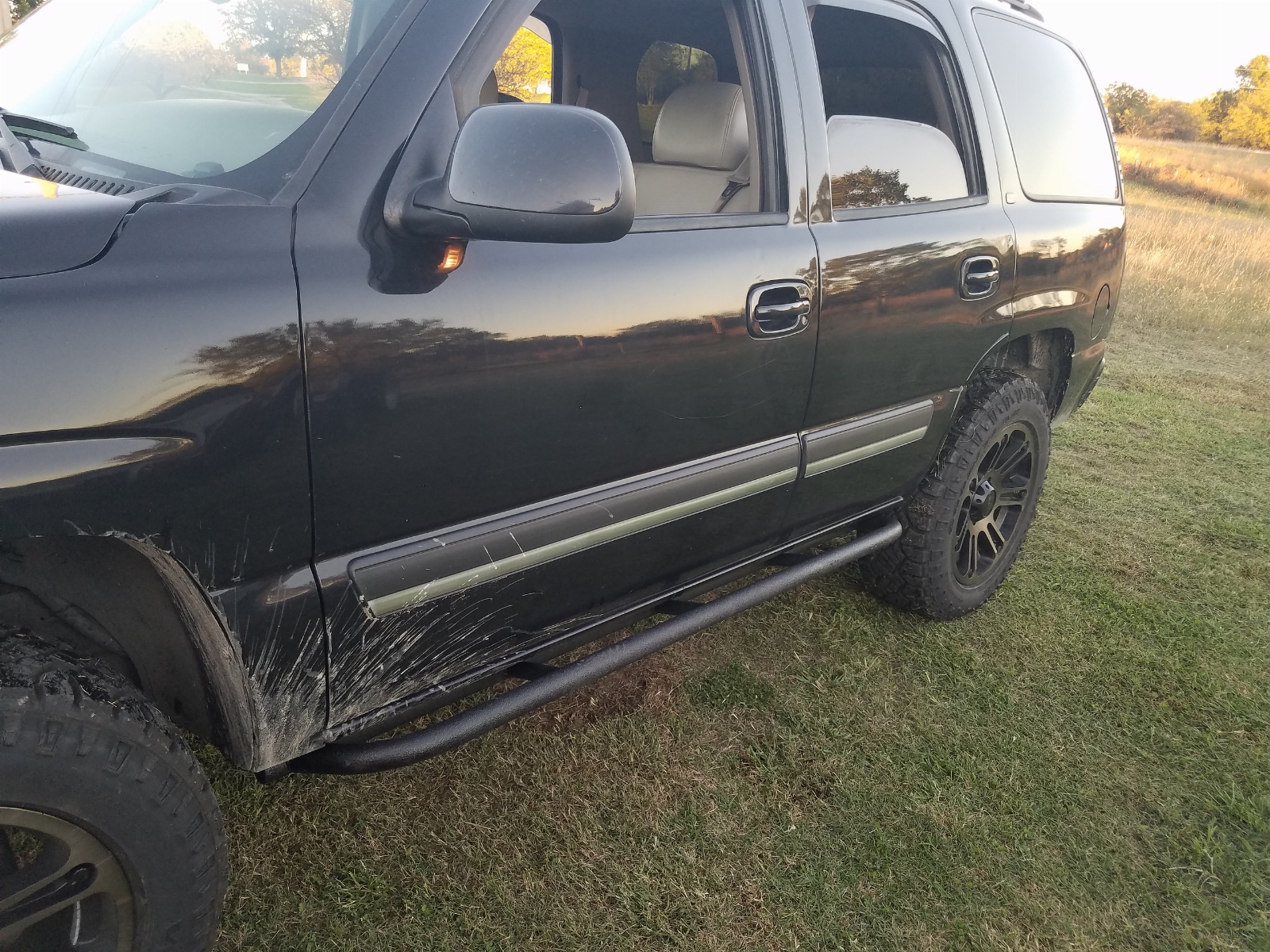

I am planning a set, but mine will be replacing my rusted out rocker panels. I plan on using 1.5x4 or 2x4 steel rectangle tube and then tying it into the frame.
I also started a set for my Silverado out of 1.25" black pipe using a Harbor Freight Tubing Bender. I've done a bunch of stuff with that bender with great success.
