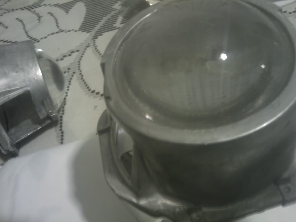

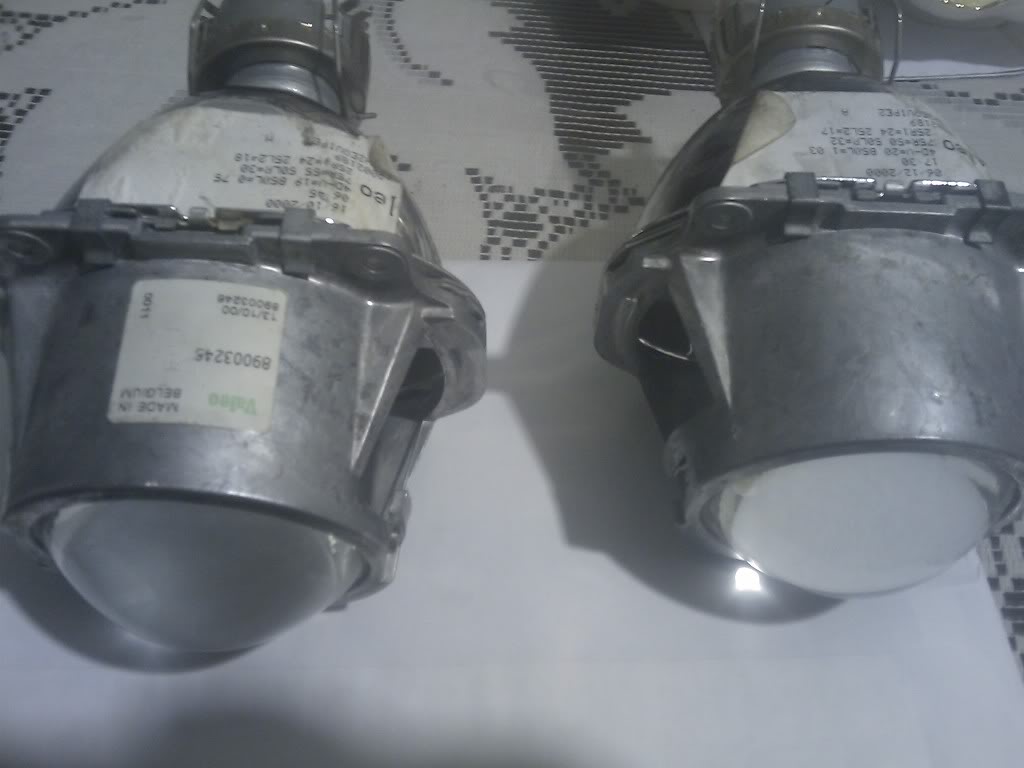

cool i got some D2S valeo projectors local fro $15 a piece :)
