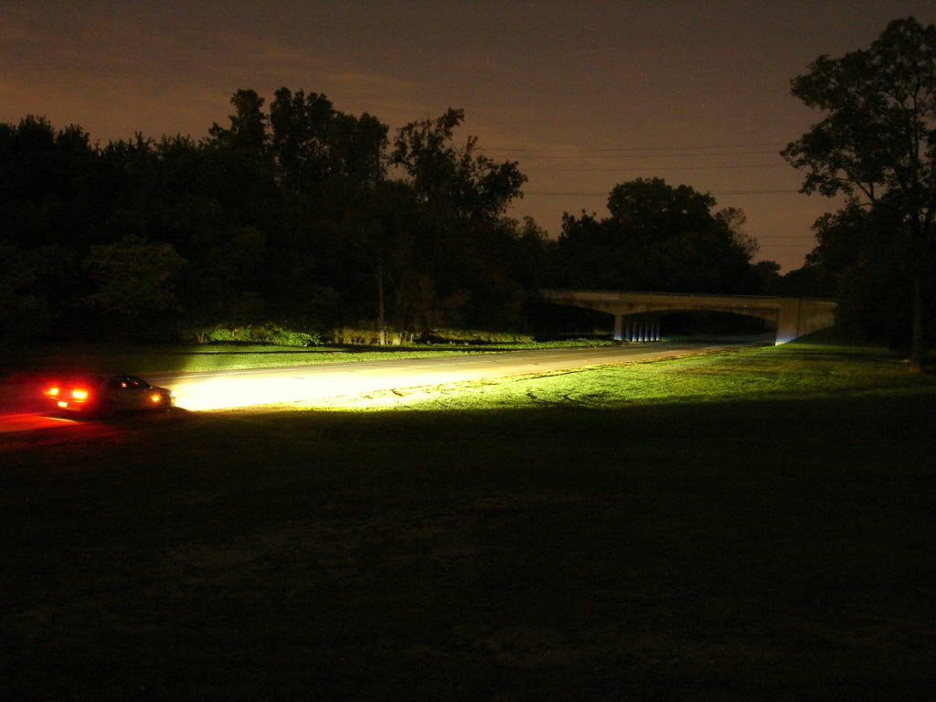

this is what i dont like.
and this is what i want.

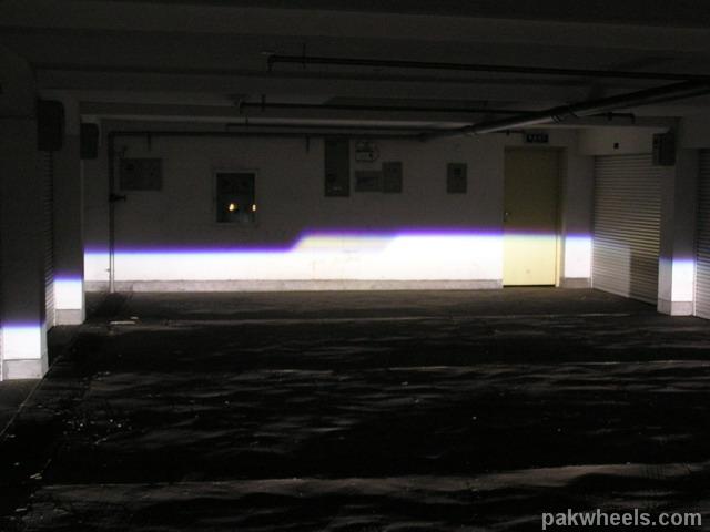

In the last pic, against the wall, your light appears to go in three steps, from left to right. Typical cutoff is one step. The confusing part is that you have two headlights, and the cutoff in the middle, the step, should line up from each headlight so they overlap. If you cover one headlight, you'll see the cutoff from the other. Then do the reverse, and you'll see the other cutoff. The driver's side should be a step lower then the passenger, but the cutoff point for each individual light should line up with the other on the wall. You can actually do all of this and mark it off. It's reallllly hard to explain this w/out pics.
This is a random google'd sample of a good cutoff, what it should look like in the perfect world:
Someone on here, might be Max, don't remember, has recent pics of an excellent cutoff in his jeep. This is an excellent link from another forum on how to align your headlights properly (HID or not): http://legacygt.com/forums/showthread.php?t=54740
Anyway, I think you could correct your alignment by either lowering the passenger side or raising the driver's side beam a little. Could be wrong, though, in which case you just have funky lights....lol. That light ouput you want, from that last pic, is pretty amazing. Fairly sure that's with high's on, though, but still....

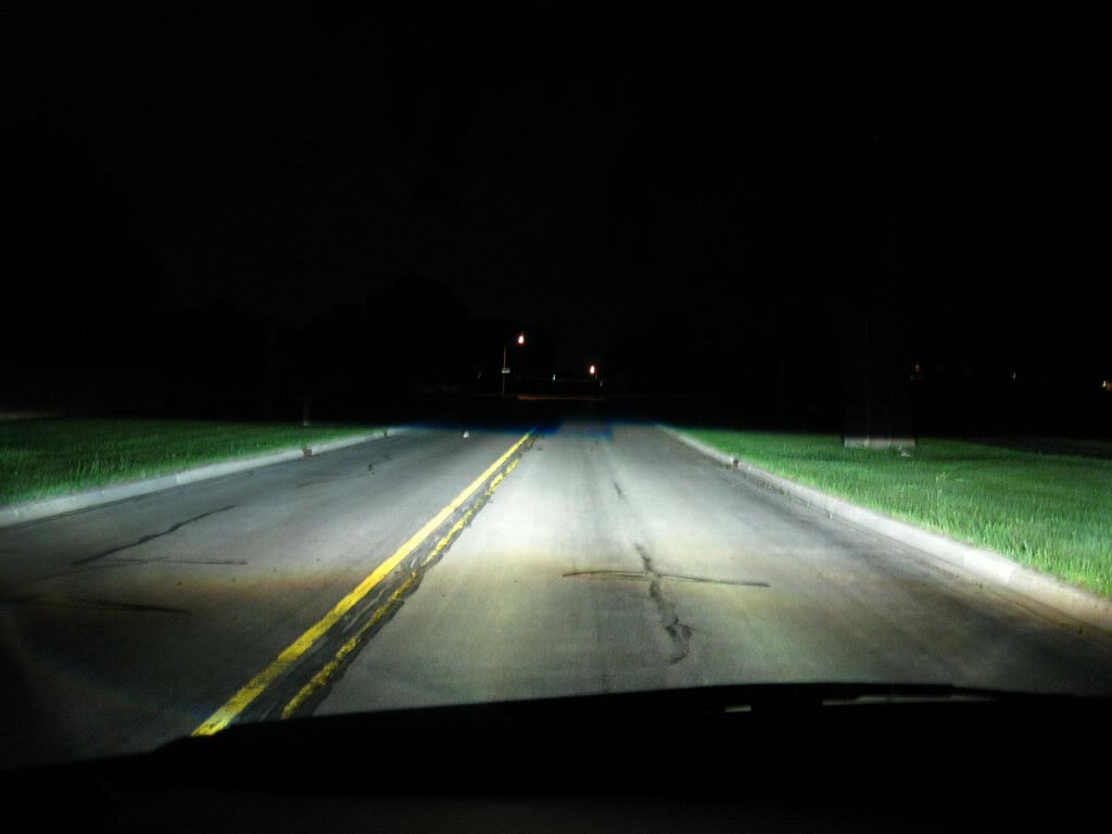

A couple of my retro results. Will have more to come when I have time for a full write up. Also have since adjusted the beams a bit for a little better cut-off, but you'll get the idea.
Front end look with the final product:
Output and cut-off shot:

They are aftermarket DEPO headlights for a Denali. Took the projectors out and swapped with TSX clear-lens projectors. I didn't mod the cutoff at all. It looks better now with a more defined step since I adjusted things more. Will have pics of that later, gotta wait for dark again.
The rest was expensive OEM parts:
Matsushita ballasts (come stock on Infiniti/Nissan/Subaru with HID...they are bullet-proof and should last a long time).
Morimoto 4300K D2S bulbs.
Other then a wiring harness, that's it. Didn't need a bezel as the headlights have it built-in.
