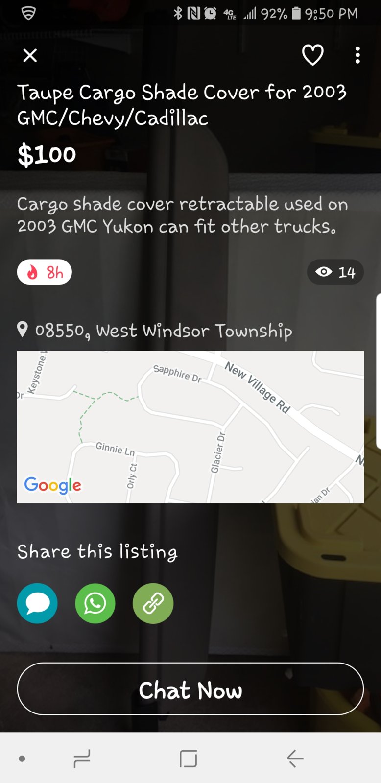

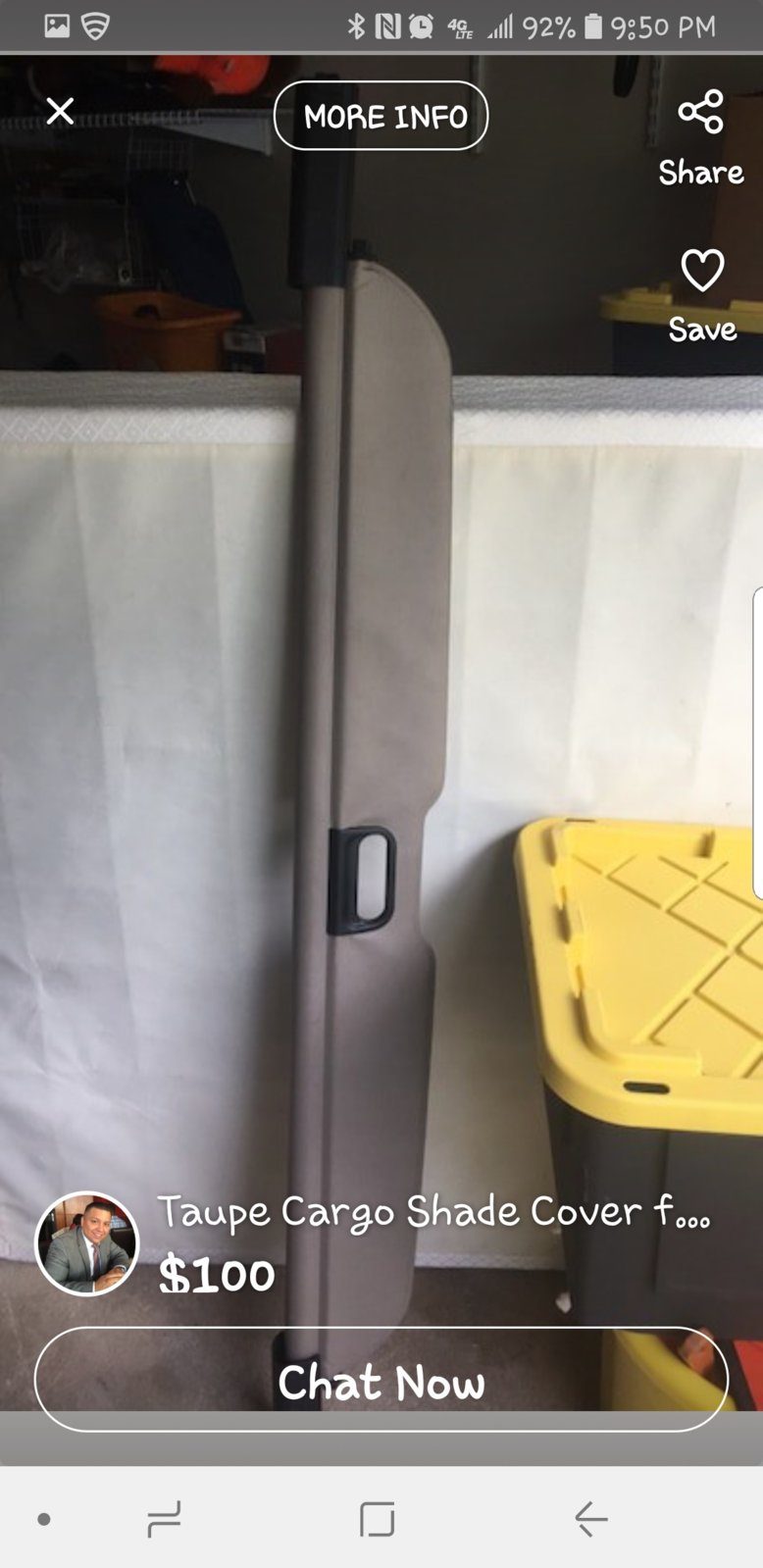

There's a guy about an hr from me selling one from a Yukon for $100. Overpriced imo, but they are out there.
