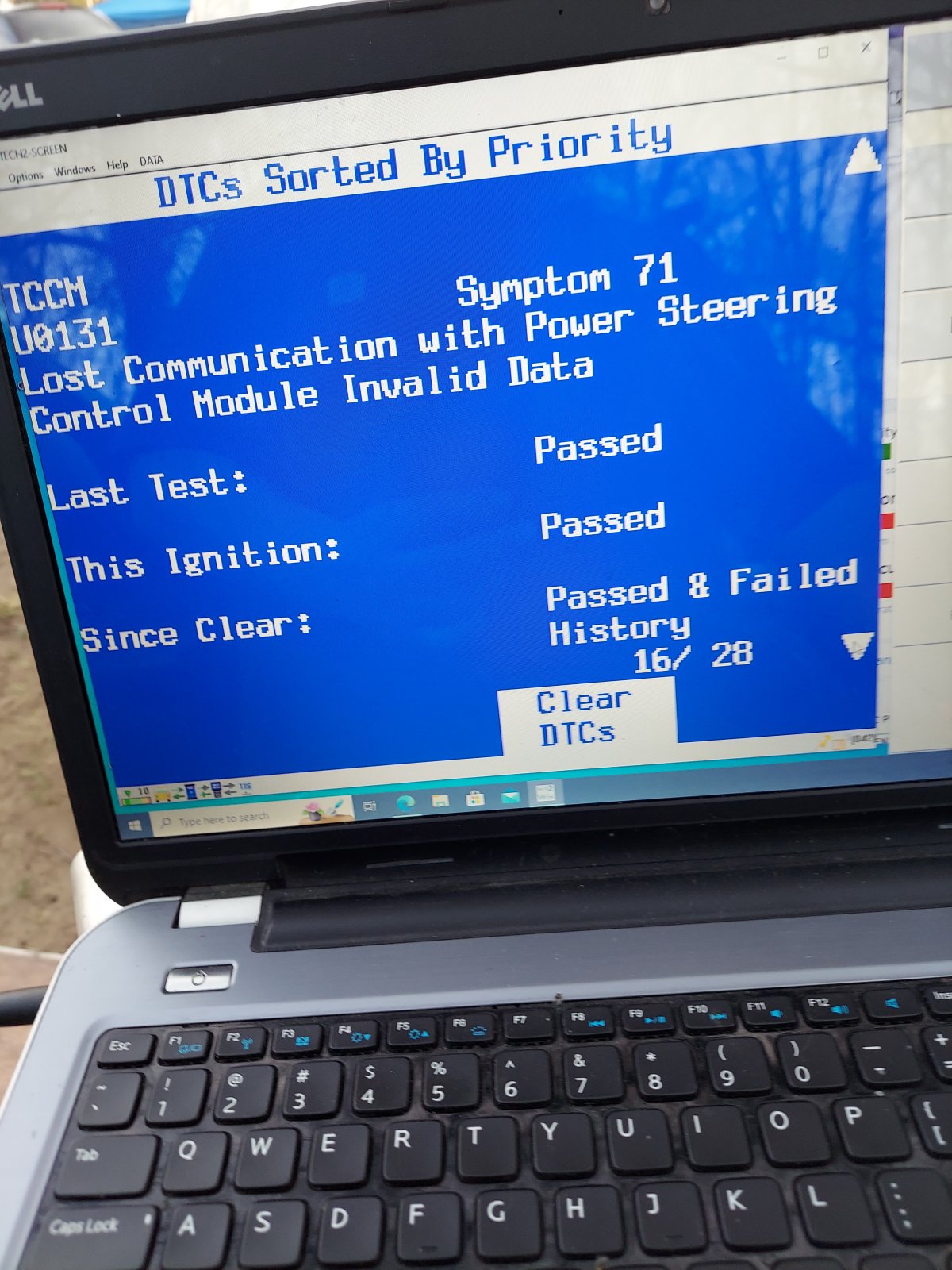

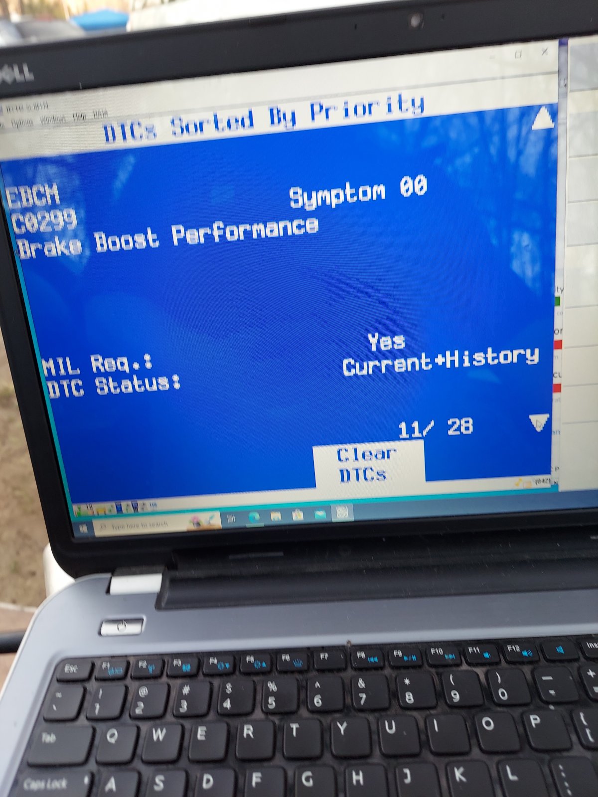

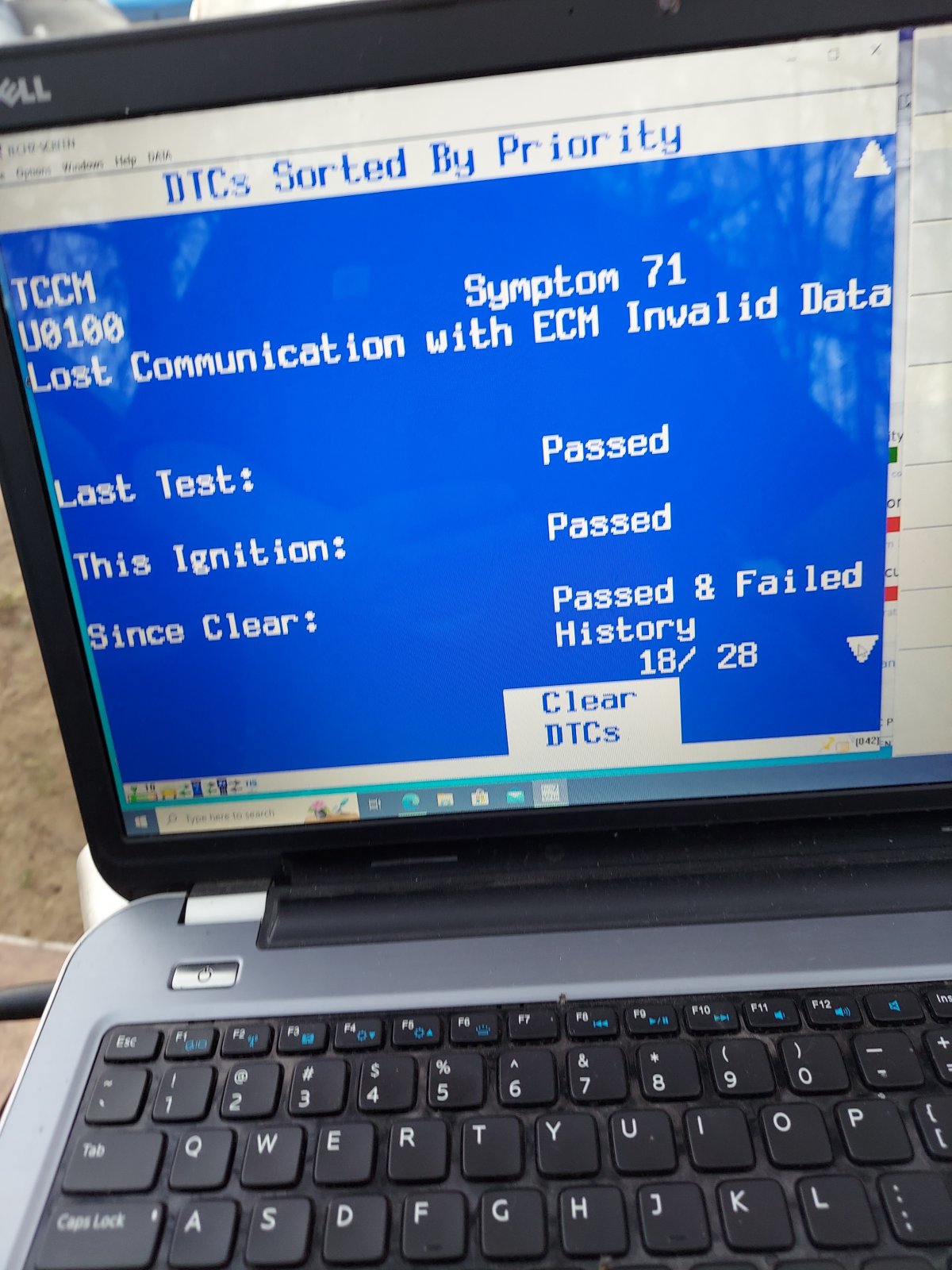

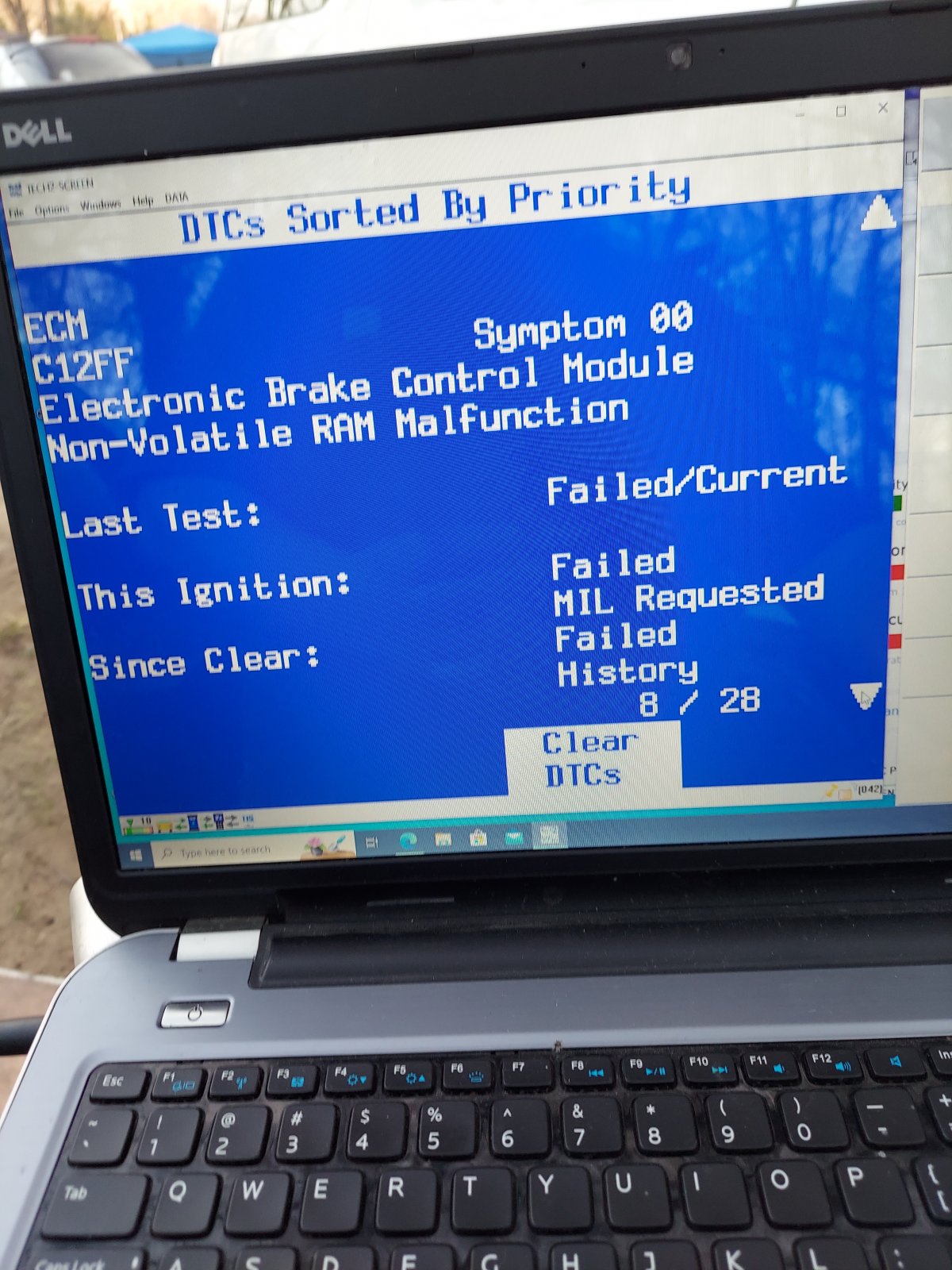

Soo... Now that it's warmer I've gotten back around to this months later. Uncle ended up getting a different vehicle. We told the dealership we were going to hold off on any more work and take the yukon home for now. We got it back in pieces, the inverter was in the back seat, air intake and other bits scattered around. All the nuts and bolts laying around the floor and engine compartment. Cover plates on the inverter missing and never were found, dealer was supposed to order replacements but never heard from him. One of the bottom plates that shouldnt have been removed was and gasket was sticking out the side with only 2 of 6 screws in holding it together.

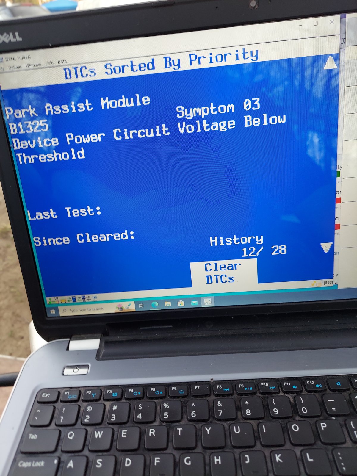

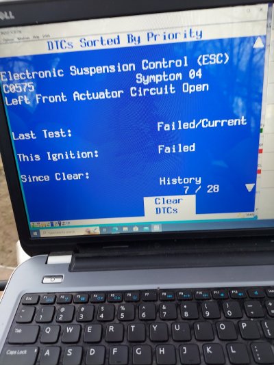

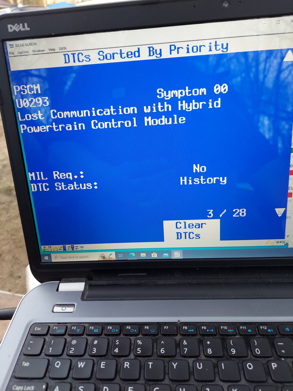

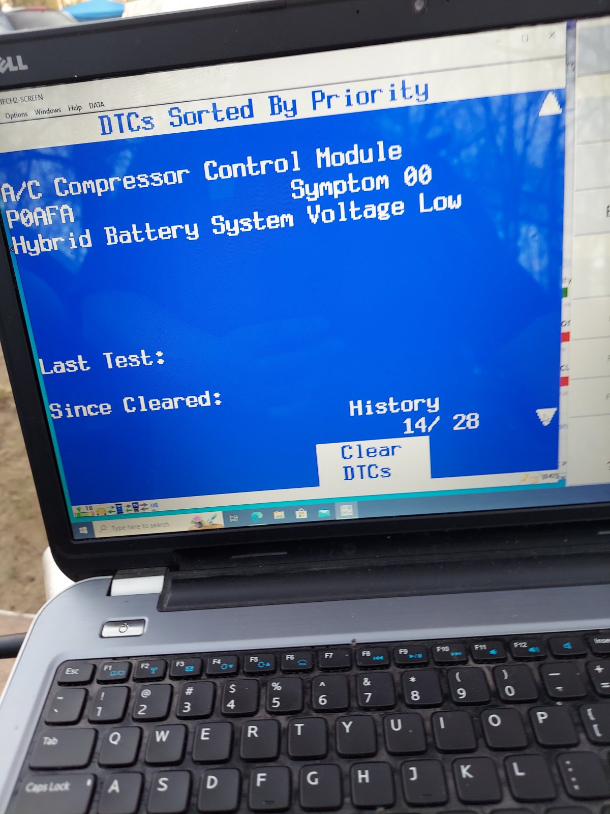

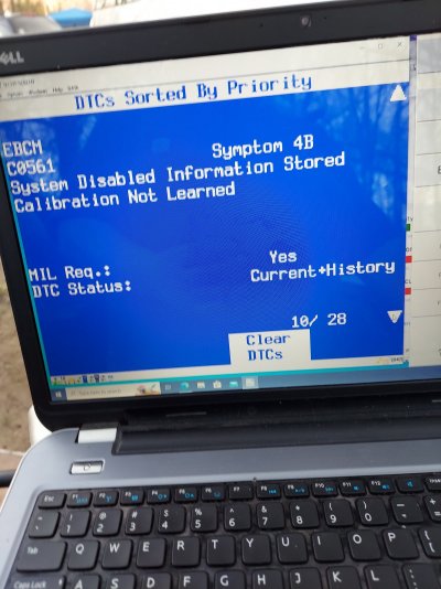

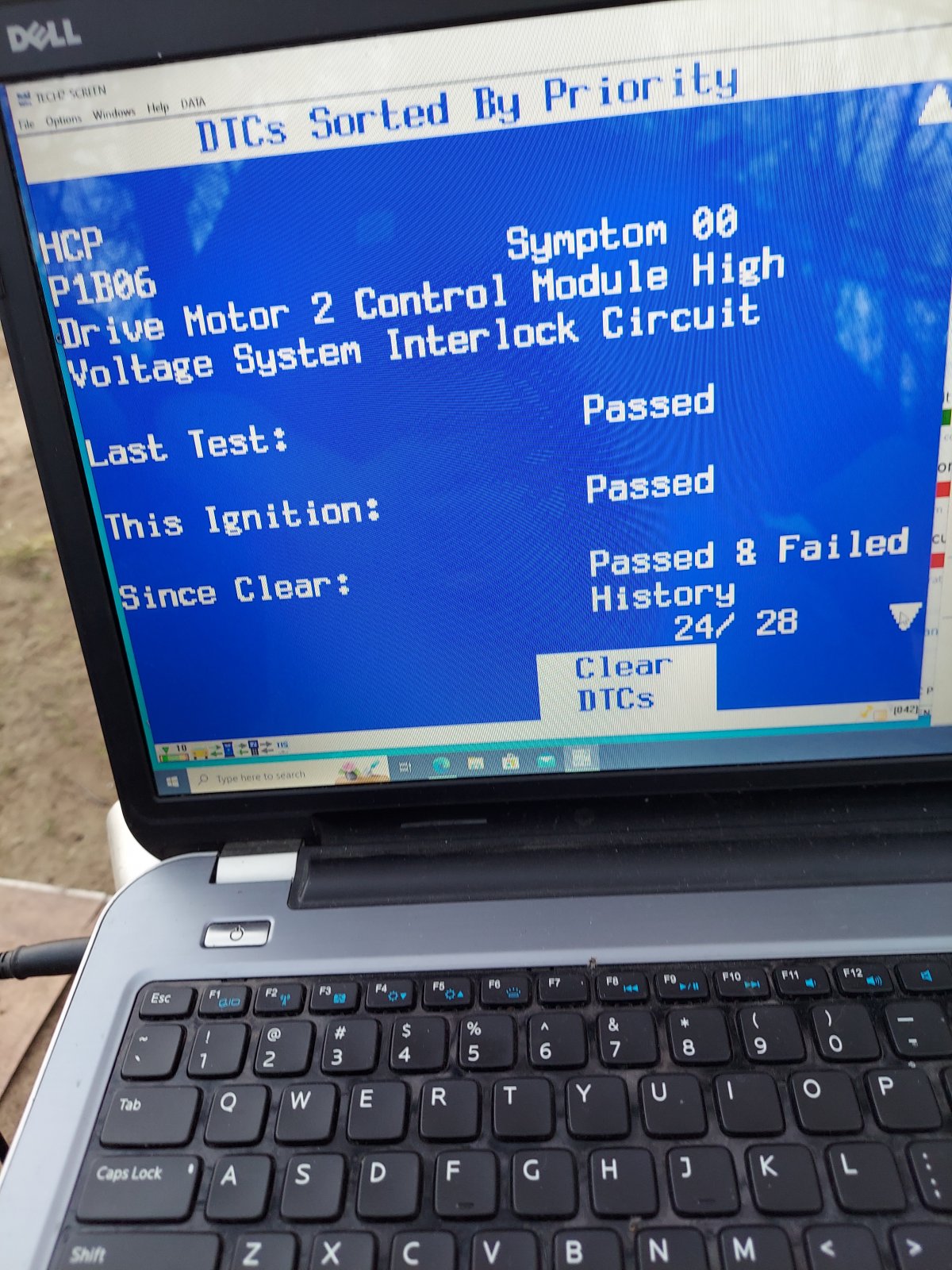

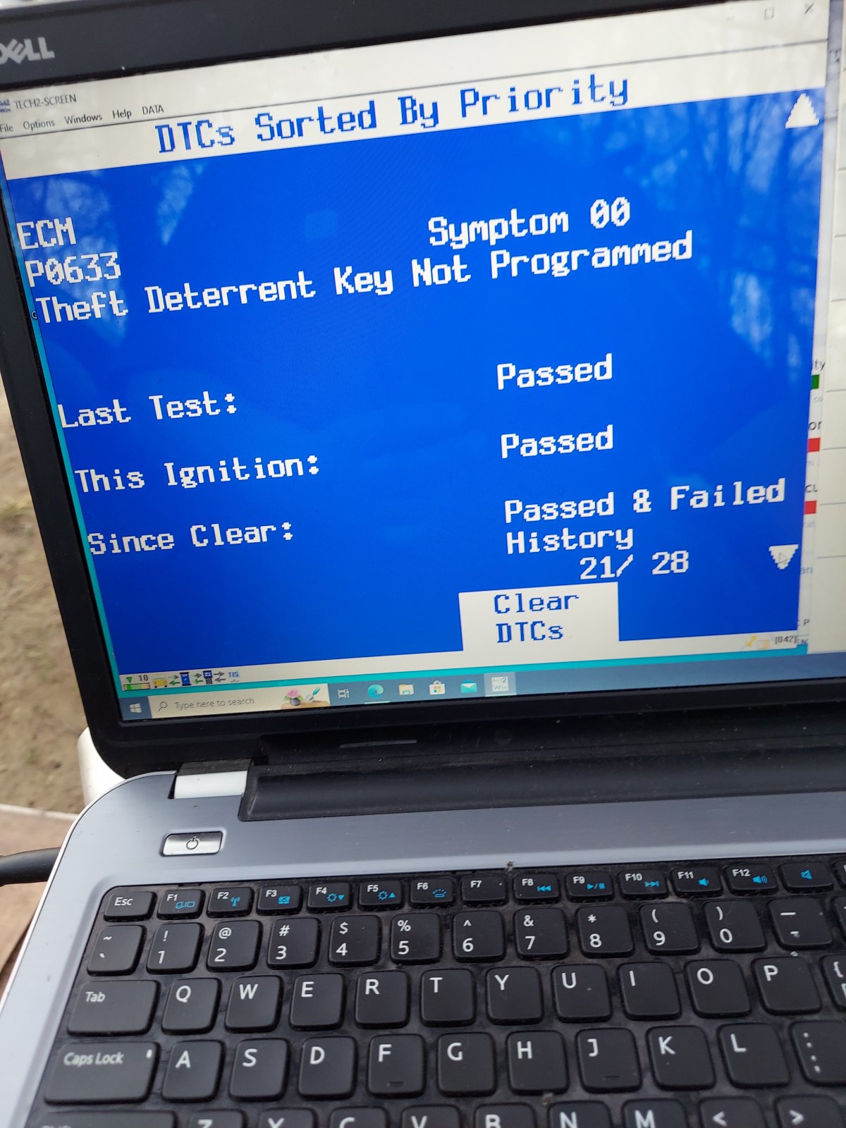

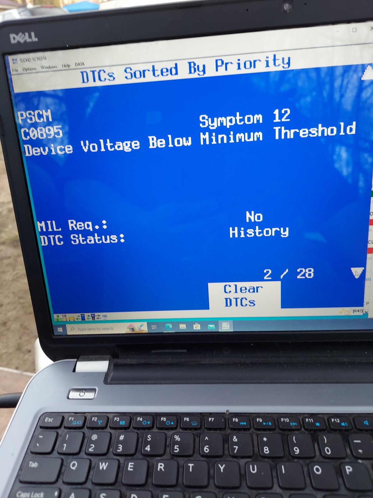

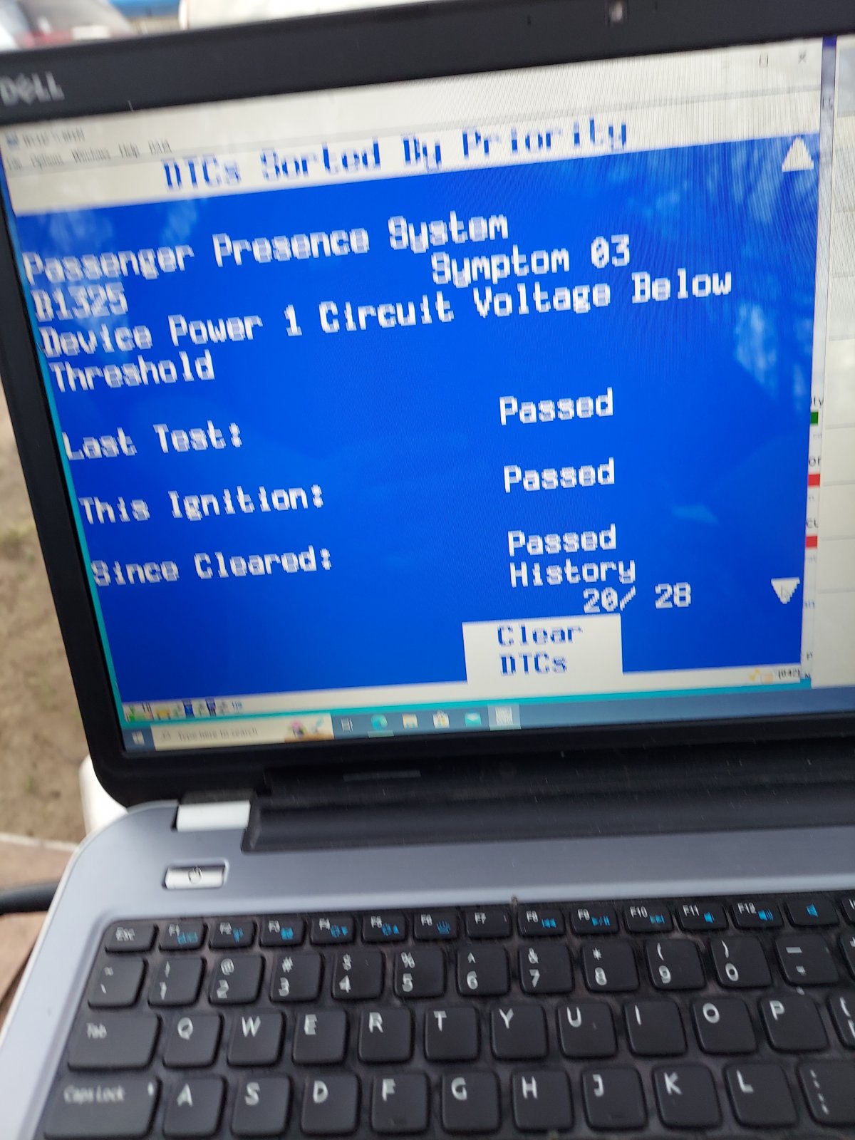

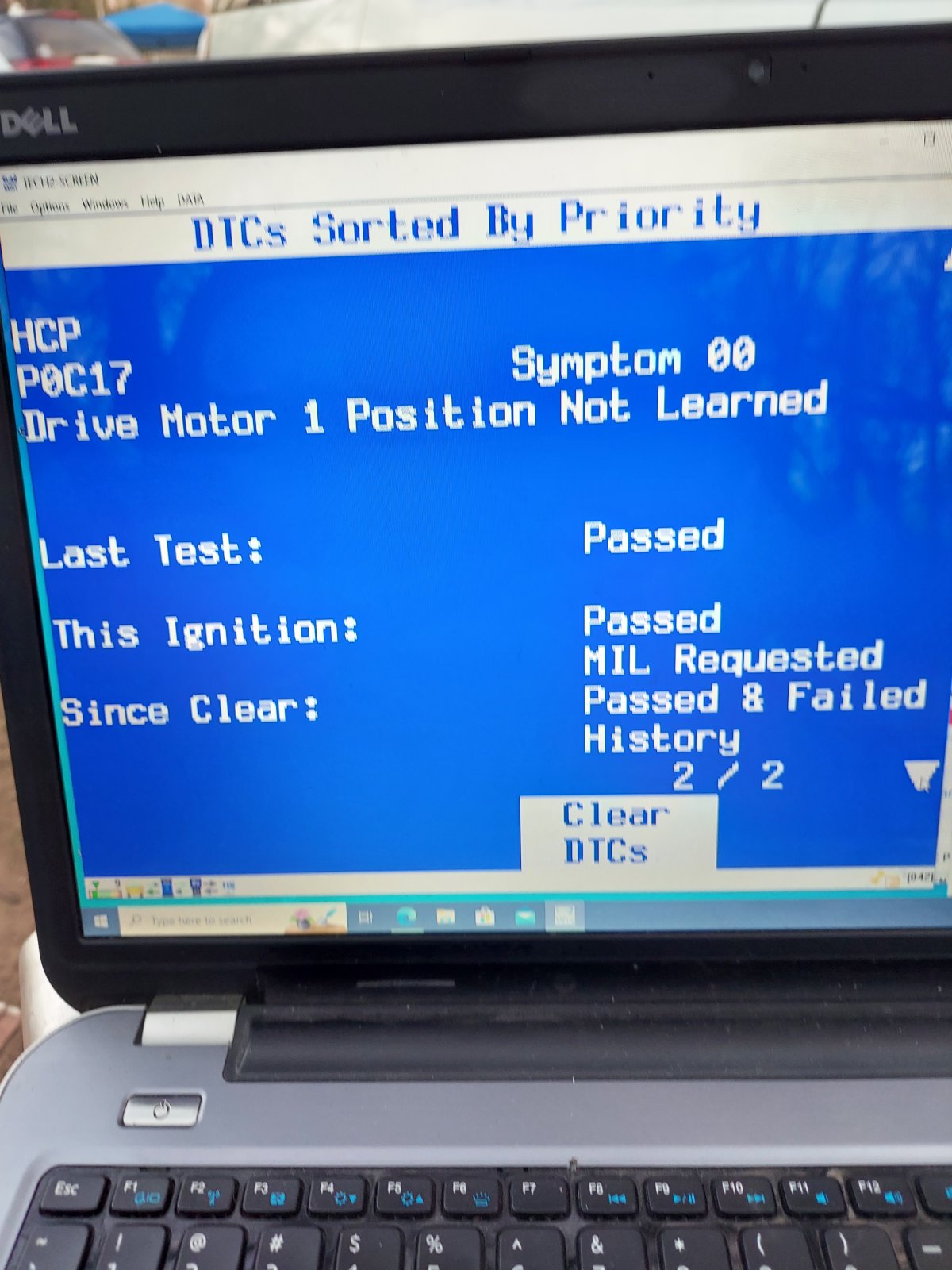

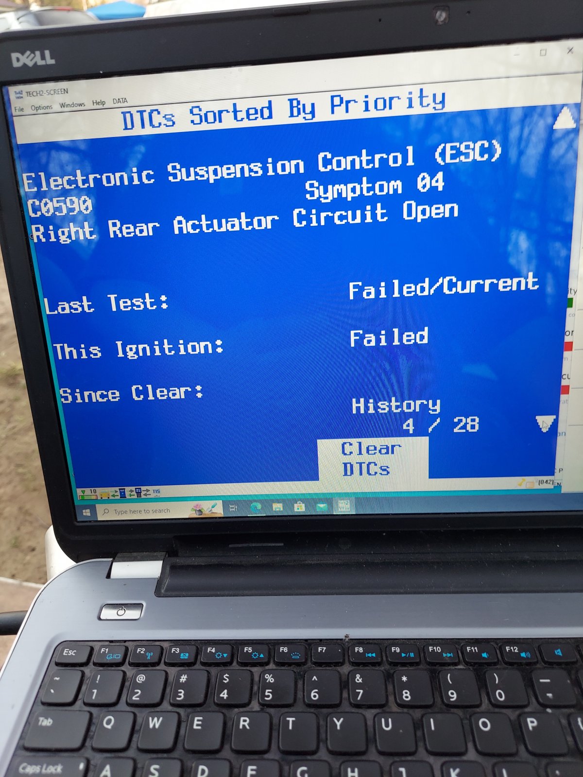

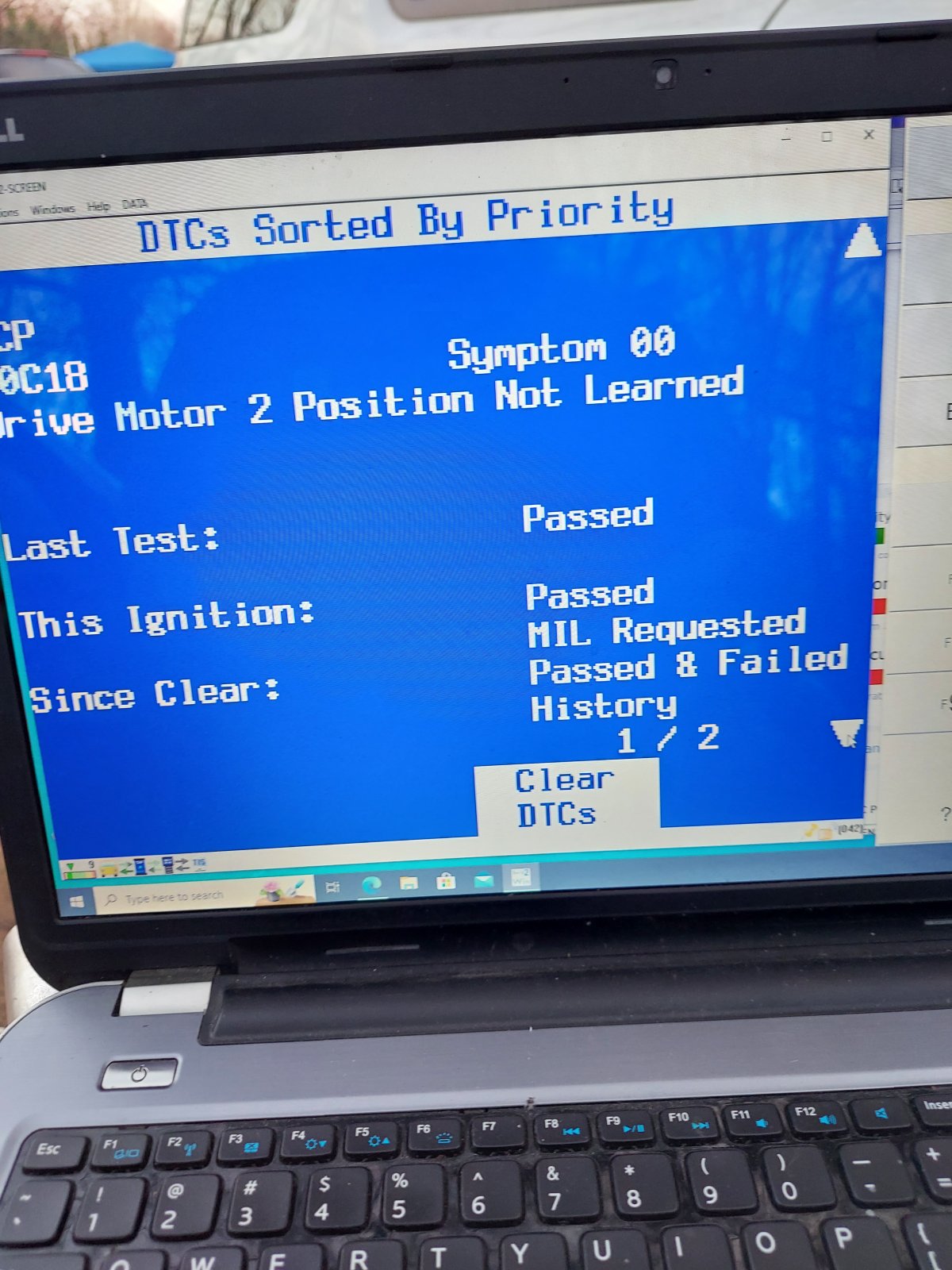

Took a while but I got everything back together minus the cover plates that go over the power connectors. I got the vcx Nano, A sub to SPS2 at acdelco and tech2 up and running after about 4 hard drive reformats and a lot of trial and error. I did the sequential reprogramming, it finished all the modules without error. Hit the key and nothing has changed. She started once for about 2 seconds but barely and stalled back out. Hit the key again and it just kind of made a grunting noise and did nothing. I've got more error codes than I know what to do with and no idea where to start. On the plus side the dashboard no longer says service hybrid system but it does say Service Stabilitrak, traction control and power low: start vehicle, which I would LOVE to be able to do. Lol The 12v battery was full when I reconnected it but then there is a high pitched whine under the hood and it drains the batter in a matter of minutes. I'd guess it's trying to recharge the HV battery off the 12v? It doesn't do it instantly every time but after sitting there a bit with the key on it will randomly start whining and draining the 12v. I left it on the charger over night and I'll see what I'm ready to face today. Needless to say I'm a bit over my head here but I am learning.
20230414_195227.jpg20230414_195233.jpg20230414_195234.jpg20230414_195236.jpg20230414_195237.jpg

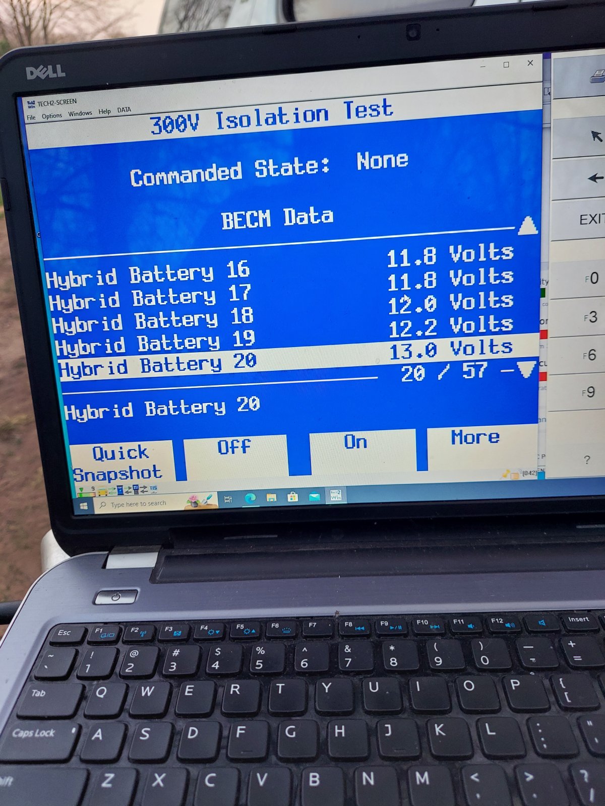

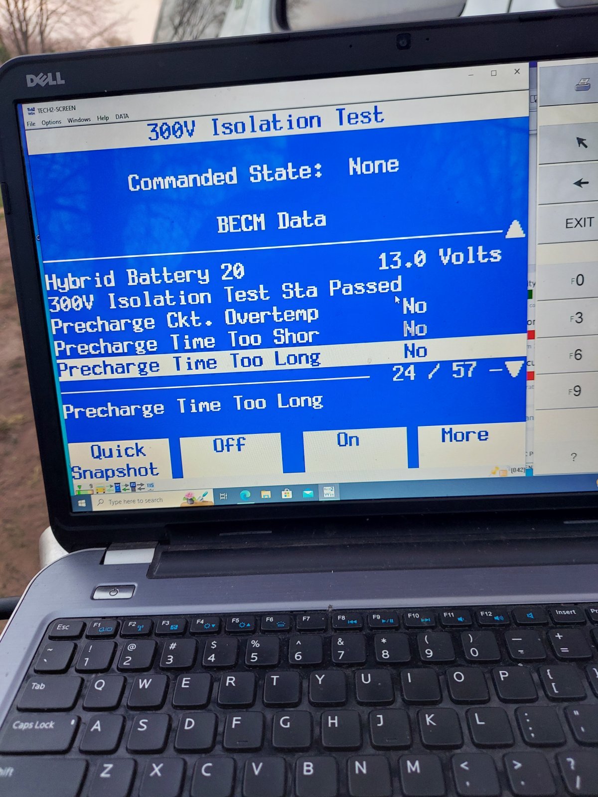

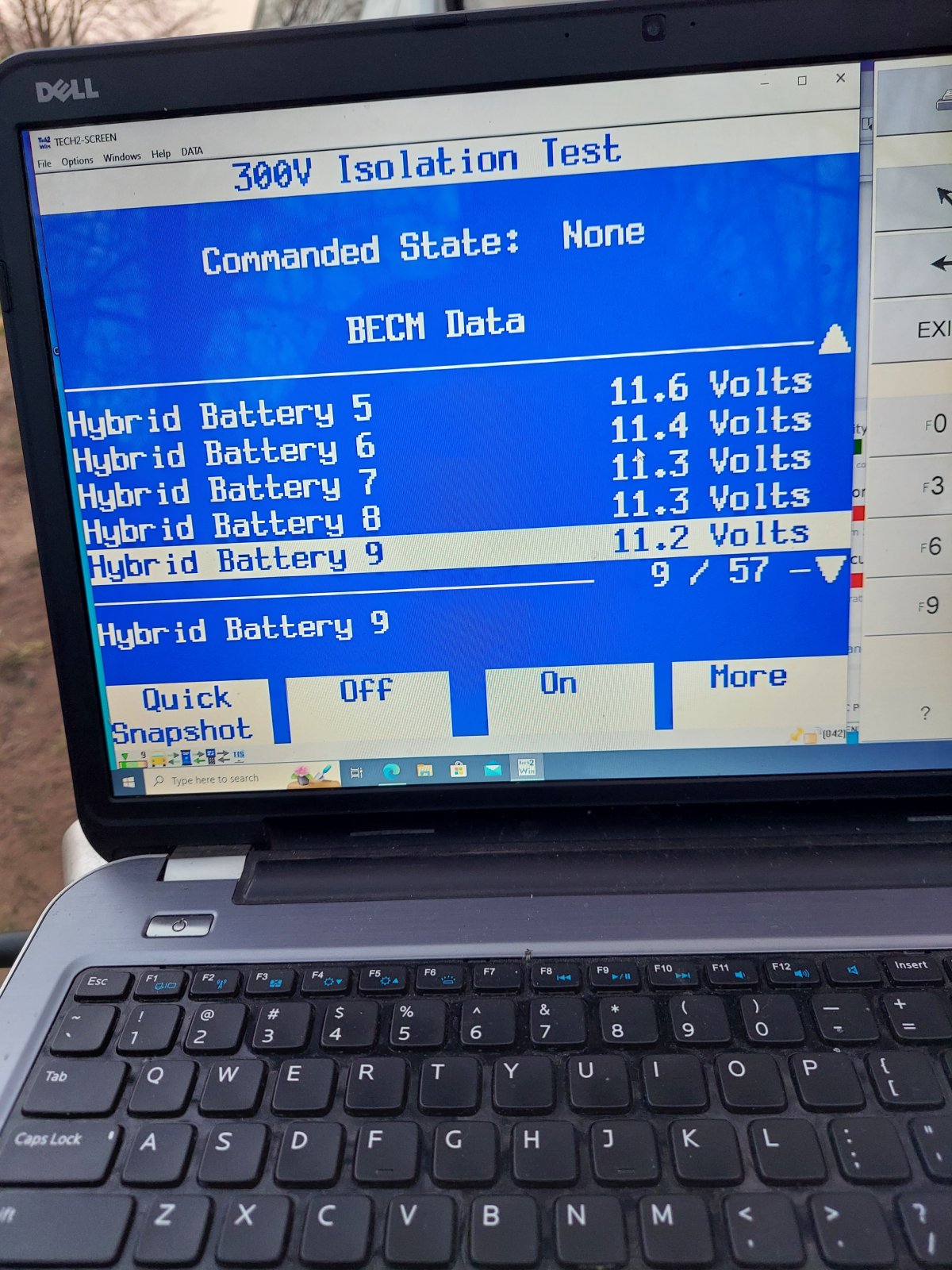

Hybrid battery pack 236v
Hybrid battery terminal 12.8v
Hybrid battery 1-20 range from 13.5v to 11.2v
Hybrid battery SOC 58%
contactor sys req ckt 70%

Check the transmission for a backed out harness connector or damaged harnesses at the brake peddle area let me get the TSB for it
There is also a large harness connector on the HV battery inspect pins for corrosion ...
  • GM CBN 08-07-30-021E.pdf

I got the voltages threw from the battery control module with Tech2. I believe its the original battery from 2011 with 200k miles on it. Some other things that i've learned. Tech2 has real time monitoring of the battery voltage. So with the HVBattery at 233v and the 12v at 11.8 with 3 percent charge I left the charger on over night. When I work up they were at 336v and 12.4 at 57%. A few hours later at 339v and 89% I turned the ignition key on. The box next to the 12v battery and radiator began to hum and the 12v battery began to lose charge. I checked it a few minutes later and they were at 248v and 12v was at 4%
I disconnected the battery, charged the 12v 80%, reconnected it and hit the ignition. The car rolled over and fired maybe 4 times then stopped. I checked and it had dropped back to 331v and 12v 40%. The 12v batter loses no charge when not hooked up to anything. it sat around unhooked for a month with no noticeable loss. I have not directly stuck a multi meter on the battery itself though.
Here is the read out for the battery
