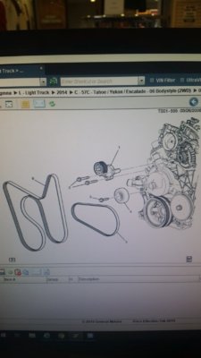

this is an illustration of the pulley and belts, hope it helps you out.

It should also be in your owners manual with a good pic. it is a simple task, i consider myself an accomplished mech but i can absolutely confuse myself on the belt routing without the diagram! you can do this with the diagram.

You are right about the serpentine belt. It was easy once I got to it. The AC belt was a bit more difficult but I used a zip tie to force the belt on the crank pully while I turned it. Thanks again for your advice.
