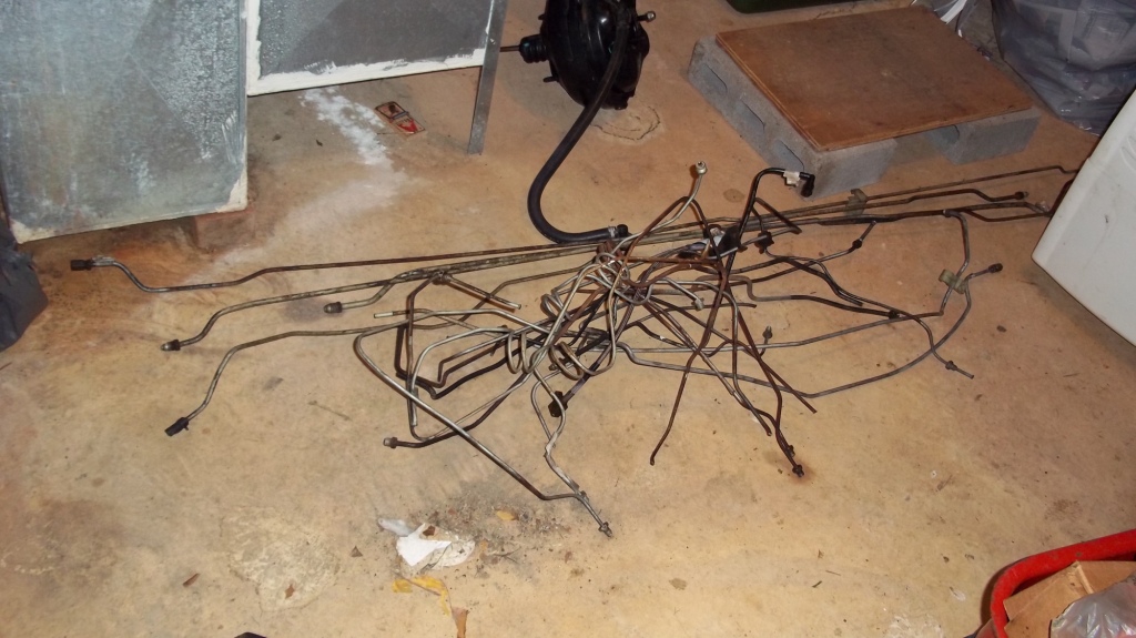

I replaced all the brake lines in my '98 K1500 Suburban last fall as the lines were shot:
The truck came from up north and I was going to buy the kit or a few rolls of line. Then I realized that cars in SC aren't really exposed to road salt so I hit the pull-a-part and scavenged lines off 2 Tahoes & a Suburban to come up with almost everything I needed. I did, however, have to make the RF line from scratch.
Other than some special (goofy) flare nuts, the lines are all standard 3/16" or 1/4". If nothing is available locally I'd buy a few rolls or straight lengths of line and start copying the lines, a few at a time. They don't need to be 100% exact, just close enough to work. You can copy the axle lines, lines from MC to ABS distribution block , and LF line without pulling the old ones off the truck. It would also be a great time to upgrade the Master Cyl.
Here's what I pulled off. Most of my lines were terribly rotted in spots and great in others.

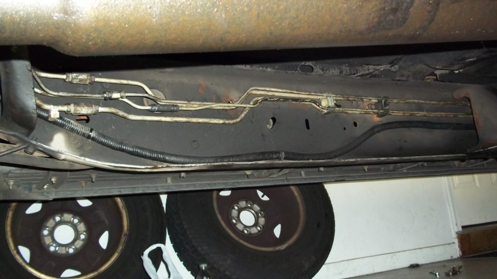

New lines on the frame rail:
