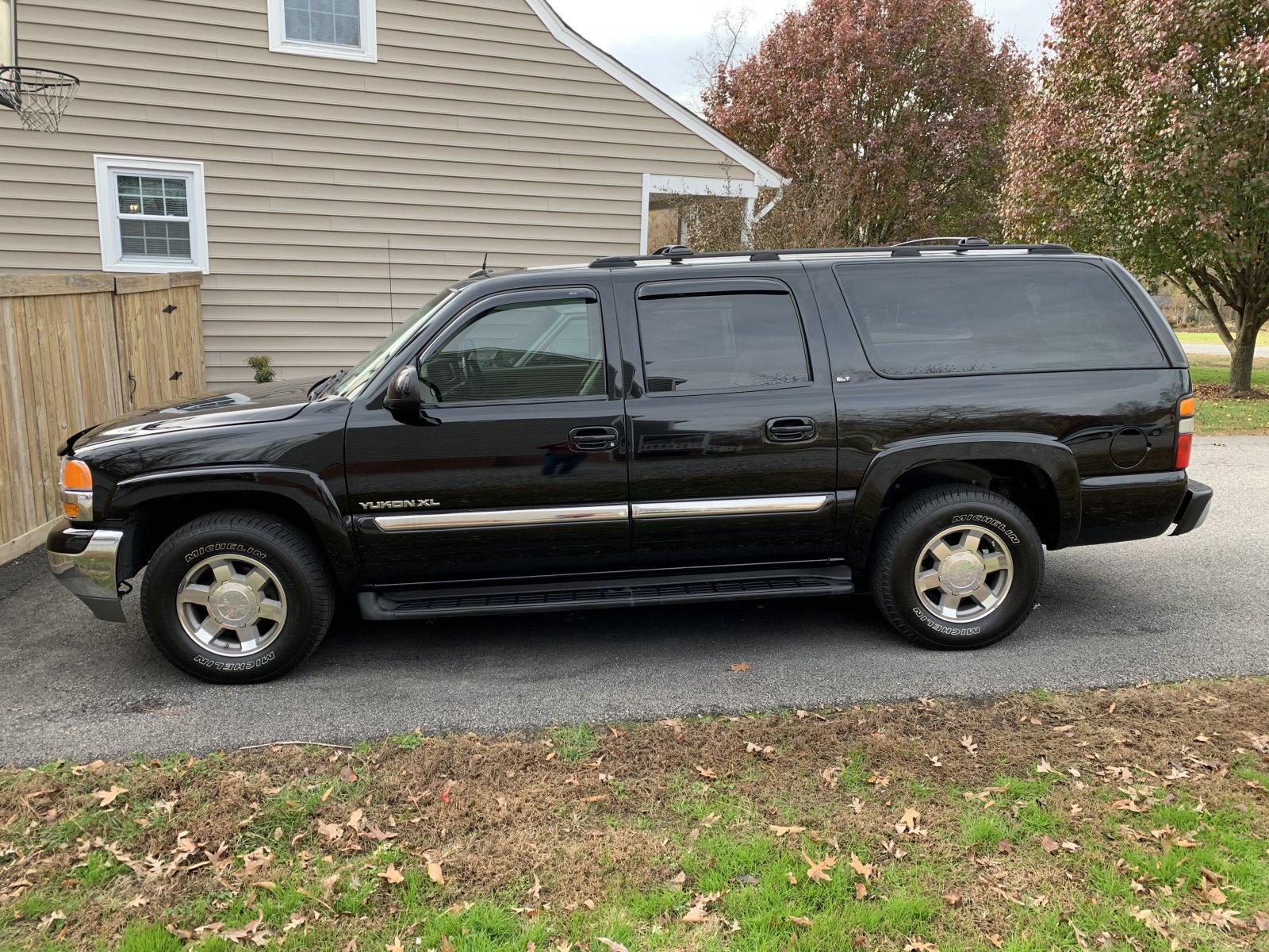

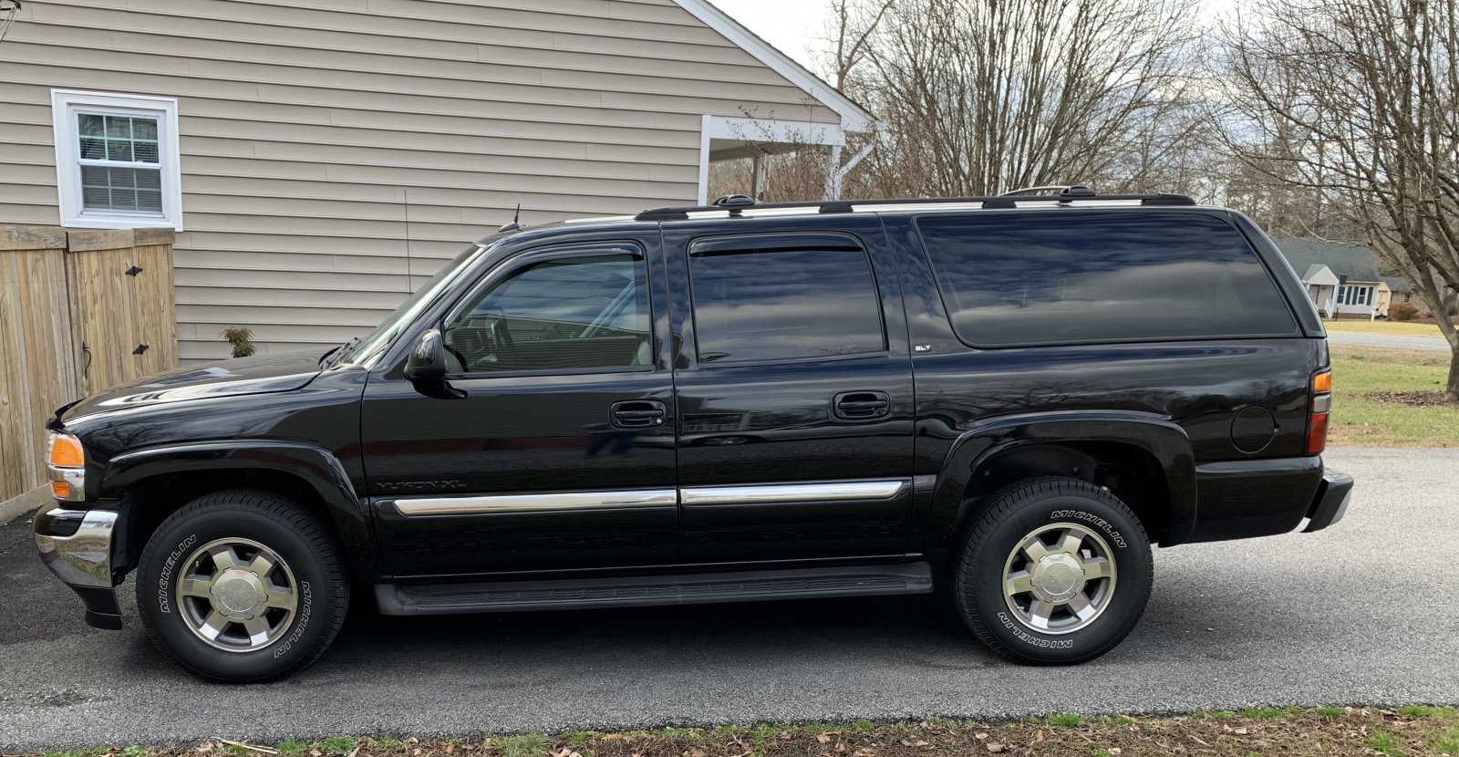

I’ve only ever seen 2 options for Moog springs. 81069 for heavy duty, 81071 for “normal” duty or if you have nivomat shocks. Same with ACDelco shocks. 45H2164 for heavy duty, 45H2165 for normal. I have KYB gas adjust shocks on my Yukon XL. Replaced the factory springs with normal ACDelco springs, but didn’t like the sag when loaded, so swapped them for heavy duty ACDelco springs and it raised the rear about 2”, then settled down to 1.5”. I ended up turning the torsion keys up a couple turns to raise the front just a little. Then got an alignment. Still a little lower in the front but not bad, and good for towing and loading it down.
1st pic is normal springs, 2nd is with z71 springs. Driveway isn’t level so rear looks a little higher than when it’s on level ground.

Thanks Mike and Chase! What you're describing (Mike) is the exact thing I'm experiencing. I'm going to leave well enough alone for now. I haven't done any real highway driving since making the changes. If any problems arise, I'll dig in further. If no problems, I think I just have a little more rake since I don't want to mess with getting an alignment right now. Once I'm done with replacing the back brakes and tracking down some minor noises here and there I'm gonna just drive the thing for a change!
And I wish mine was even half as clean and sharp as yours looks!
