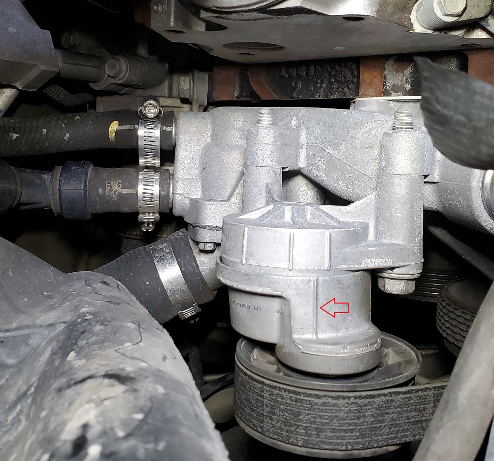

Looking from the top of your engine compartment, does your tensioner have marks (like below) and where do they land? Post up a pic of yours.

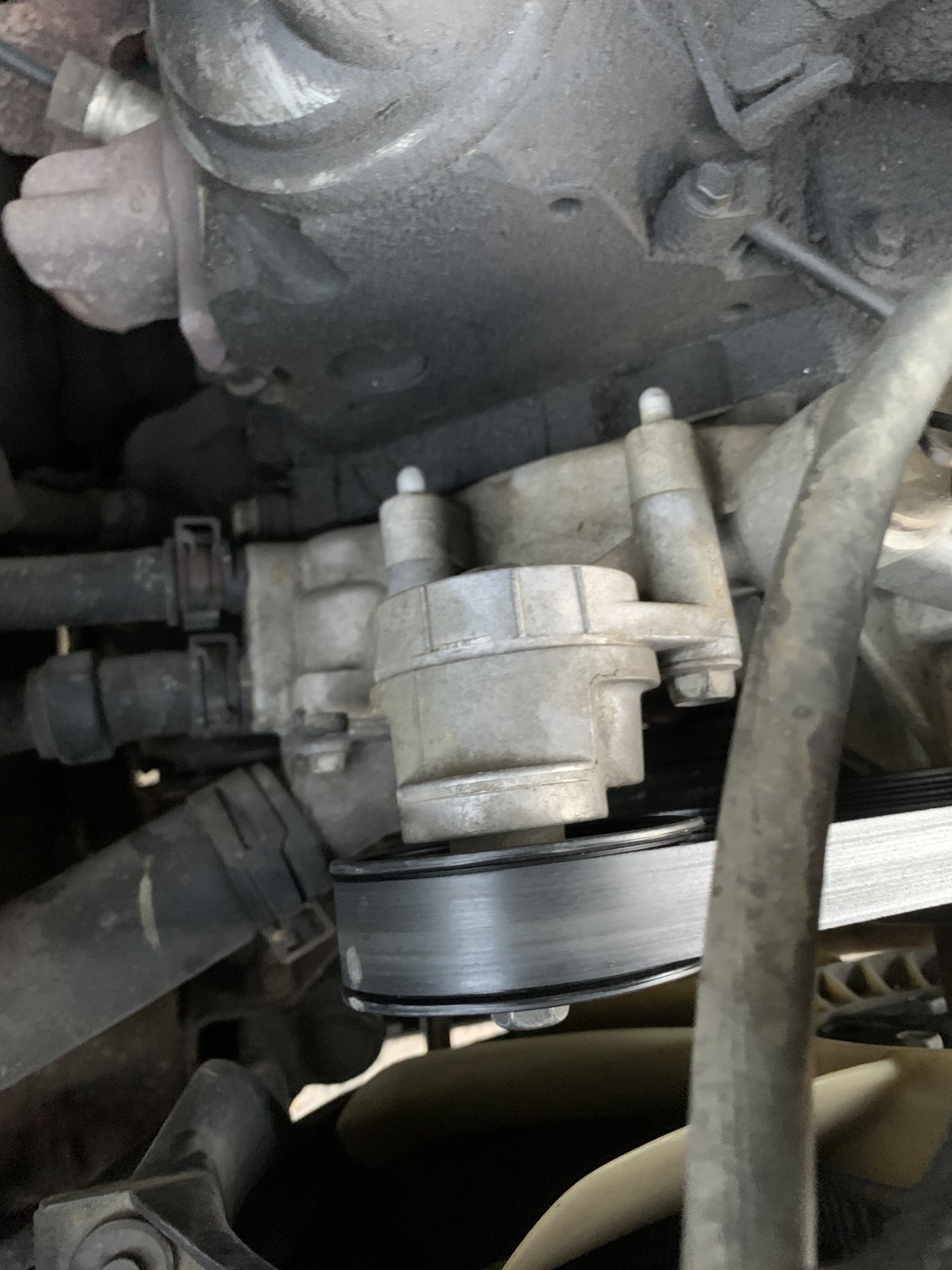

1) The alignment on my tensioner is pictured- it is definitely off compared to you guys'. However, I can't adjust it any more without it loosening- could this be an internal spring or necessary tensioner replacement?

The lower righthand pulley should be your power steering pump. And that tensioner looks like it's shot unless the belt is too long. What part number is your belt, and what alternator do you have (105A or 130A, maybe)? It should be stamped into the alternator body.

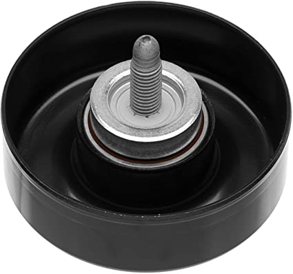

Aftermarket pulleys often come with nothing else in the box, just the pulley.
Spacers or any washers would have had to been transferred over from the old pulley.
I have used Gates idler pulleys on other vehicles. Great product, but you have to use the bolt, spacer and any washers from the old part.
Here is what an AC Delco pulley looks like. New Delcos do include the whole thing.
There is a pretty good sized spacer you can see behind the bearing.
I'll bet an aftermarket pulley with no spacer was used and the original got tossed in the trash.
About $22 from RockAuto.

So, the idler pulley I took off had a spacer just like the AC Delco, but it still rides on edge.

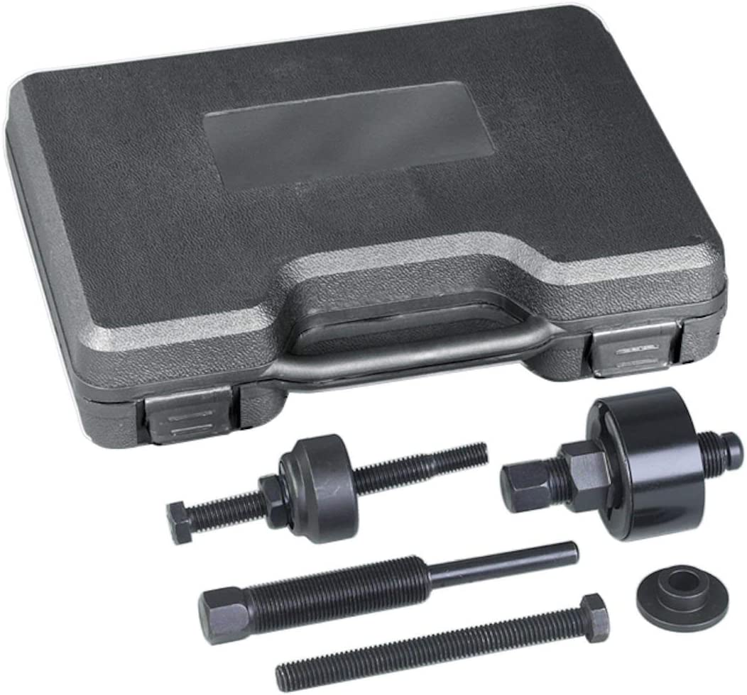

I know I posted this before but,...
It sure diagnosed the misaligned power steering pump pulley on mine.
And this is what I used to adjust the pulley...
