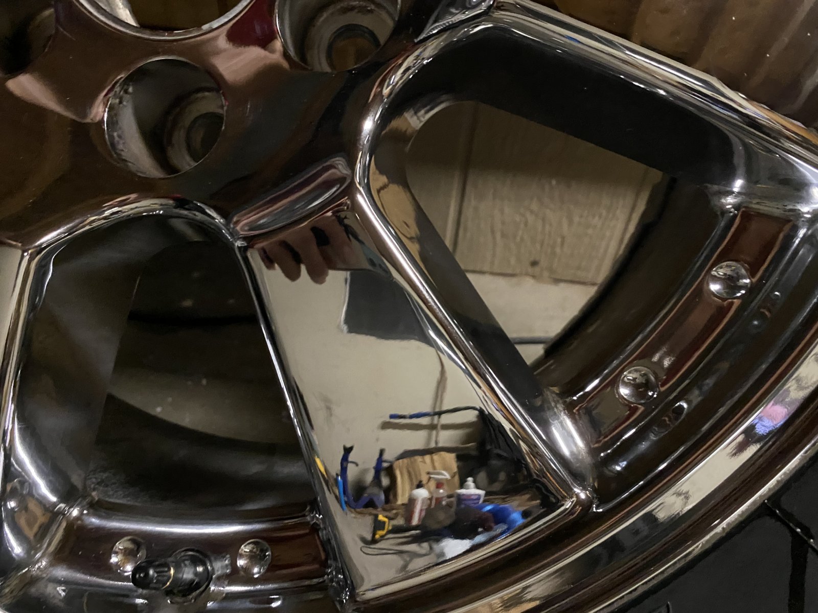

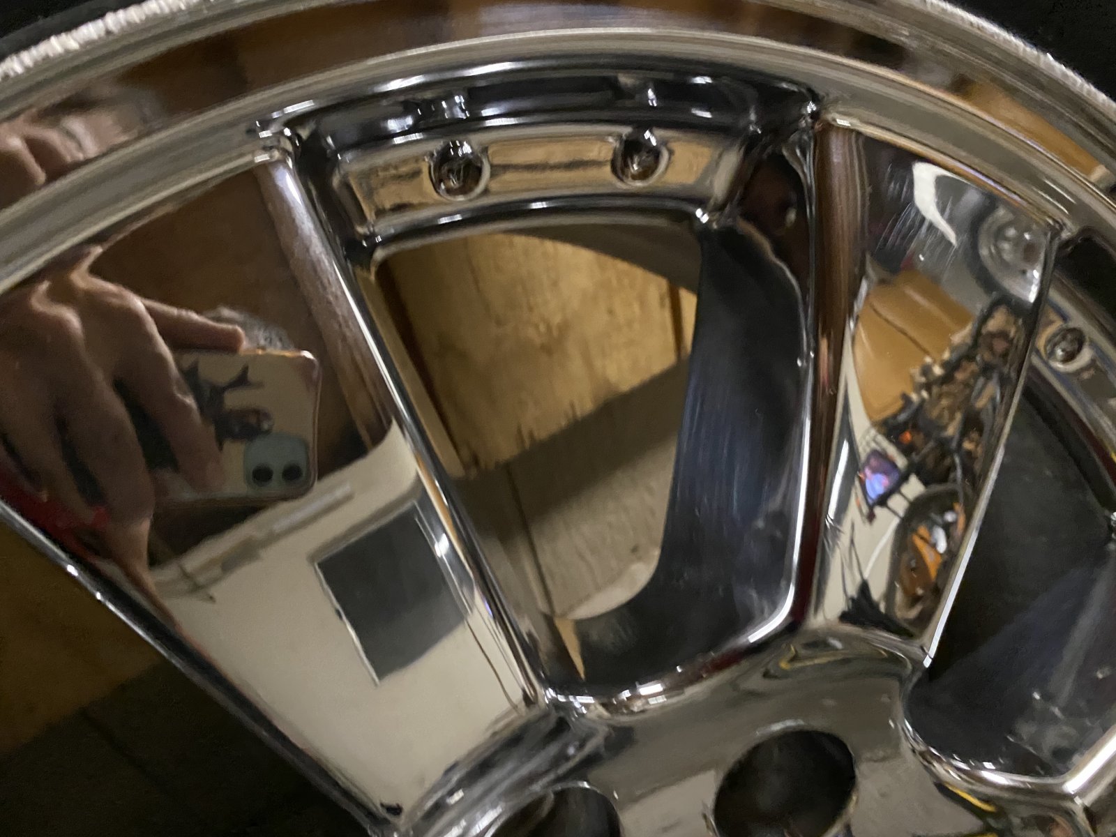

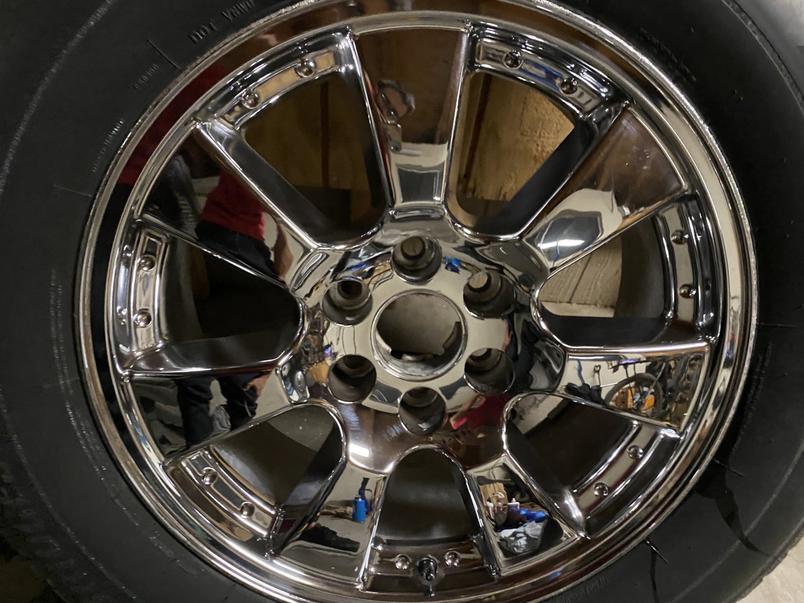

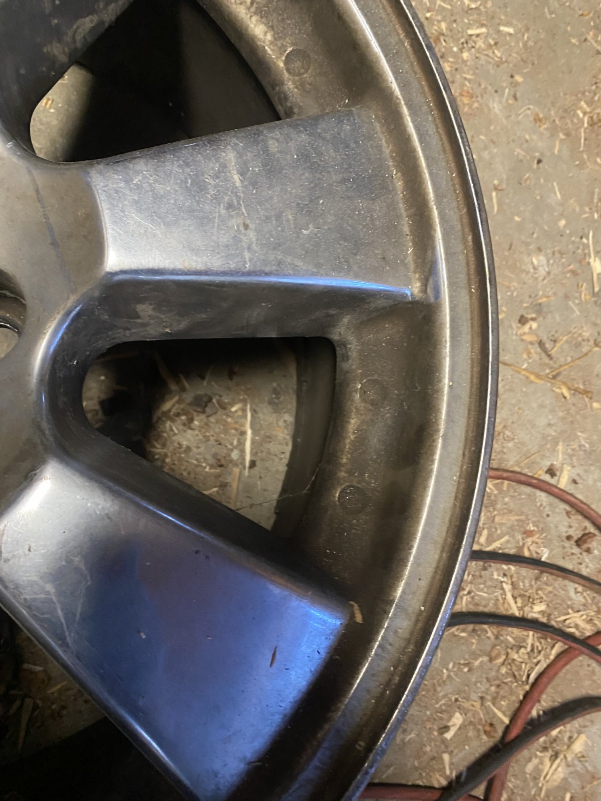

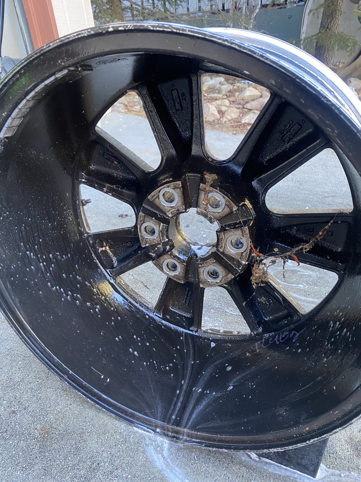

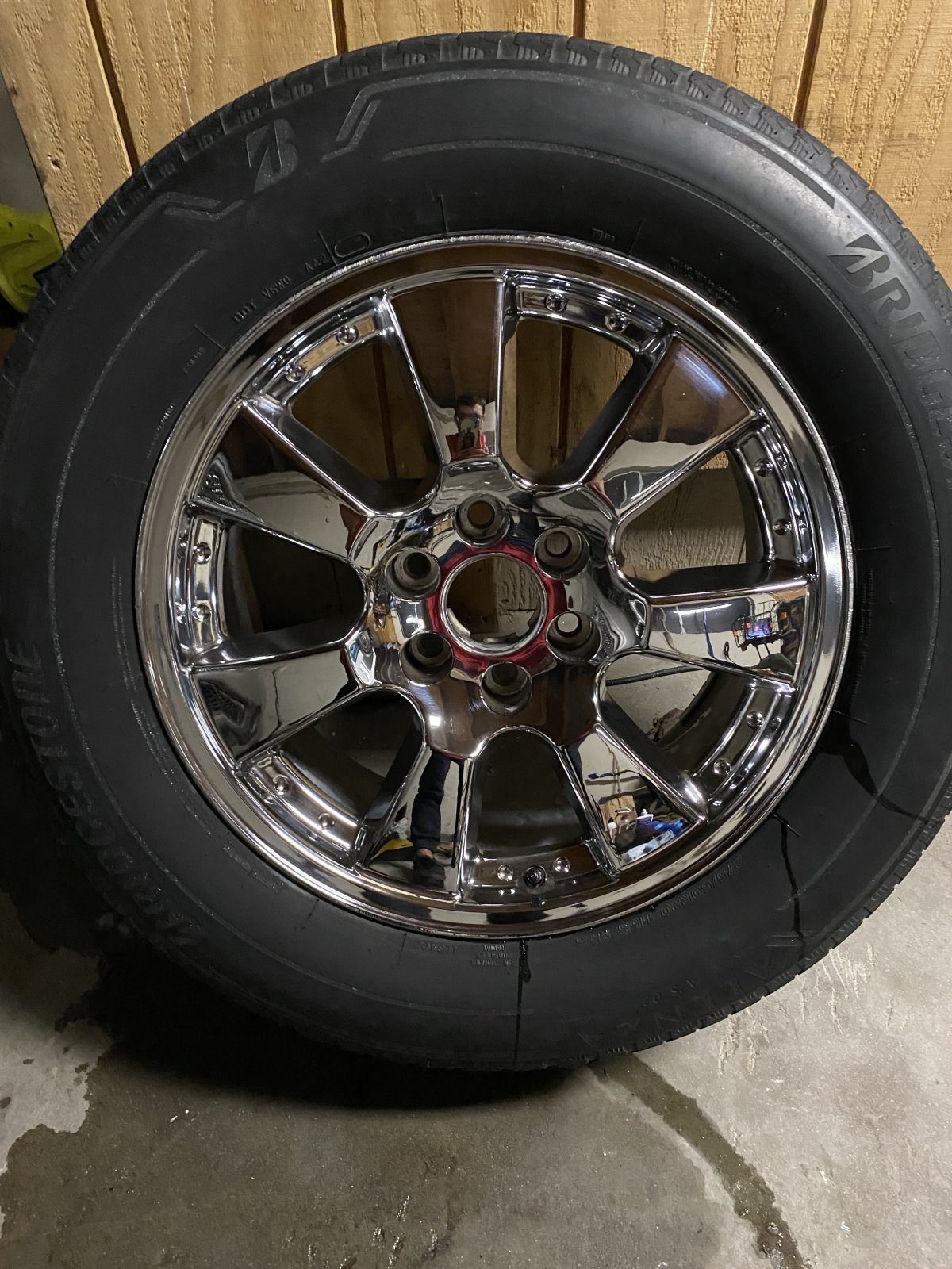

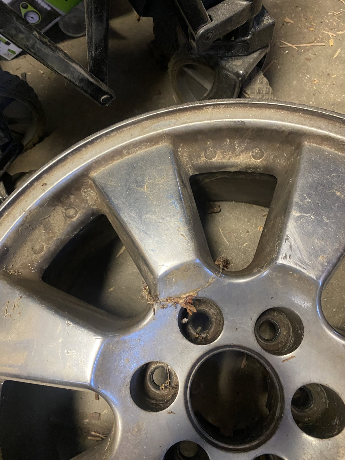

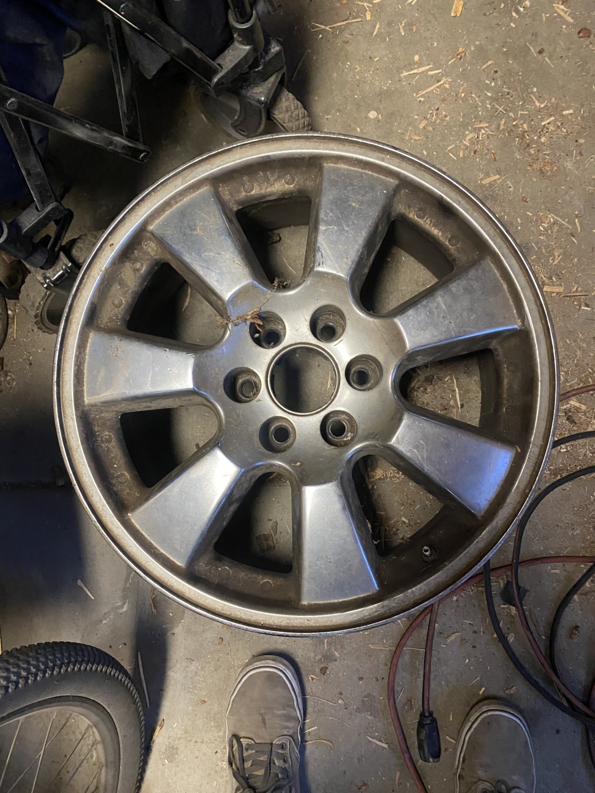

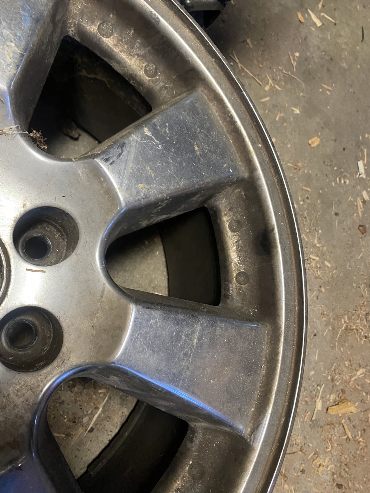

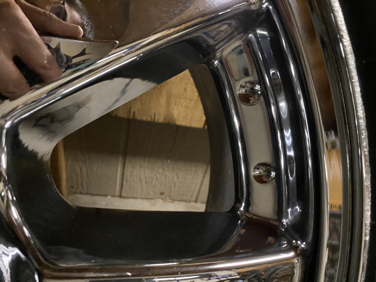

Knew I needed to to get the spare sorted before heading out to Utah so I got my behind in gear and polished the snot out of it. Could see good chrome under all the crap so I hit it with tons of steel wool and metal polish and many rounds of polish on 3 inch pads on the impact gun. And a big fluffy cylindrical shaped polish brush on the impact to get into the arches inbetween spokes. Was a lot of work.

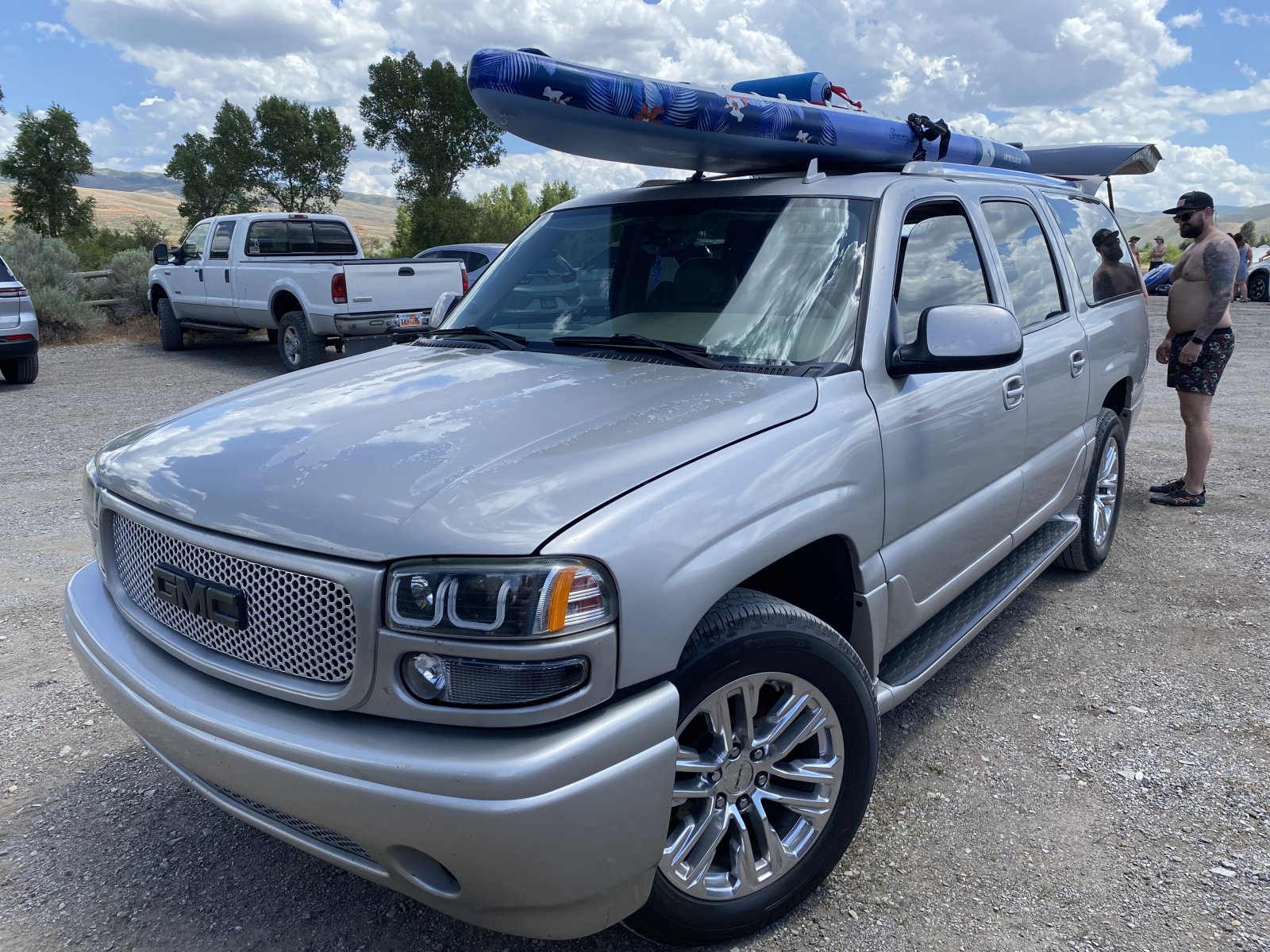

I was a bit worried that the Escalade racks wouldn’t work as they’re not as beefy and “functional” as some of the other factory racks and are more “for show” as many have told me in jest over the years of having them. I still like them either way. lol. But they worked perfectly. The paddle board wasn’t heavy so it sat totally fine on the cross bars, and I have some nice ratchet straps always on hand, one strap holding front of the board to the forward cross bar, one strap holding back end of board to the rear cross bar and it didn’t move anywhere and sat perfectly in place for the not too far drive back up the canyon interstate to the top drop in spot. I was like heck yeah… Escalade racks for the win!! Snapped a quick photo at the top drop in spot just before we unloaded.
Here I am with a 19 year old AWD SUV and it’s jsut out here being a jack of all trades!! I come prepared baby!! Hahahah :chewie:

The spare tire hoist fought me and made it I pain in the behind to get up in. In addition to brake pads being wrong it delayed my trip to leaving Wednesday afternoon on the second instead of driving through the night to avoid holiday traffic and high desert temps. But the wheel cleaned up and nice and finally got the hoist to cooperate and spare in place. Brake pads beaded in and in place and I set off for Utah. Fits perfectly with a used Bridgestone dueler 275/60 tire in the spare location. Forgot to take a pic of it up under the back end. But works.
Wow, you got that wheel cleaned up great!

Nice work on the that wheel polished out. Looks great! Homemade always > than store bought. But no tubing photos? lol Sounds like a great trip.

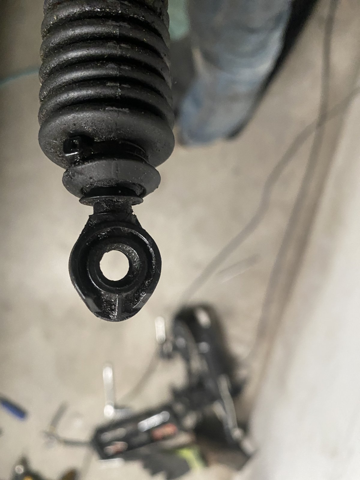

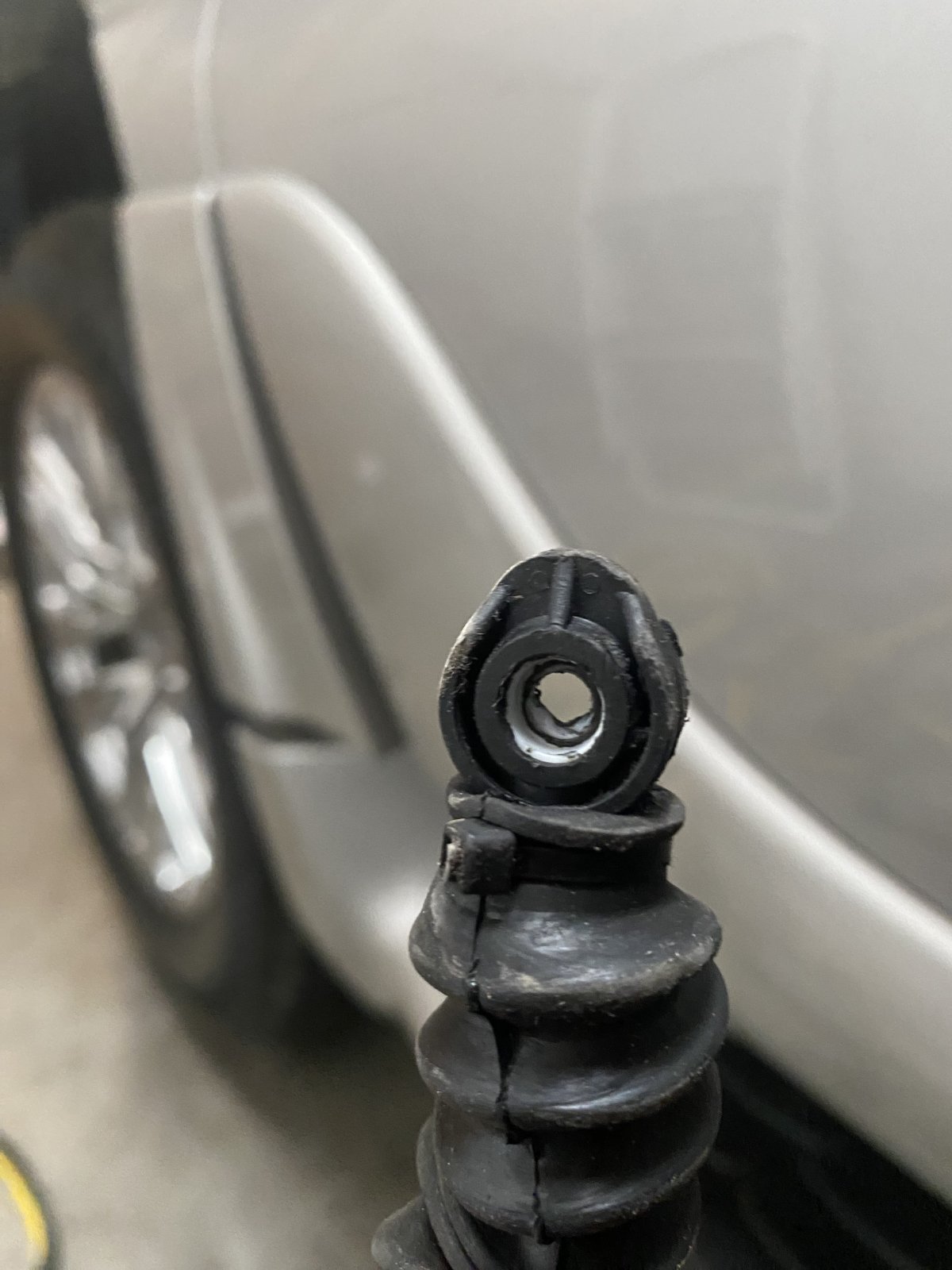

Welp…. My return trip from Utah through the night was eventful given that the grommet type thing on the end of the shift cable securing it to the lever on the the side of the trans is supposed to have a snap ring type bit inside it that secured it into to the lever. Yeah mine was missing that second but and made for multiple shift cable freeing moments….. :rolleyes: :banghead:
Apparently there’s rebuild kits for those grommet things?! I didn’t know and bought the whole two piece shift cable…. Swapped it out and now cable and shift lever on the trans stay connected.

Life has just been hectic lately. Two Saturdays ago late afternoon, after finishing up a maintenance detail on a 2020 navigator L for along time family friend, went to back the Denali out of their driveway and the shift handle lost all tension…. Shifting was no dice…. Got out and unclipped the lock collar that covers the connection point of the upper and lower cables in the shift cable assembly. It was all still connected and the grommet on the shift linkage lever at the trans was still attached. Turns out somehow the upper cable snapped and had zero tension in it. Thankfully Denali wasn’t parked blocking their vehicles in and she said no problem leave it overnight and deal with it in the sunlight….. so I called around after 7 on a Saturday and autozone could get me another shift cable but two days from their hub….. F***!!!! :banghead:
Autozone in Victorville, which technically is the shortest drive time wise off the mountain had the shift cable in stock, and was open til 10pm!! On a Saturday!! I was shocked! She gave me a ride home and a little after 8pm I fired up the samurai and booked it as fast as that little 4 banger could take me down the mountain. Now….. the highway that leads down the north side of the mountain, goes from 7,000ft elevation where big bear valley sits, to 4,000ft elevation into the high desert region in just 12 miles of twisty windy mountain roads. 6 very sharp hair pin turns, 3 of which are back to back corners about half way up the drive and many very steep sections of grades. Denali handles it fine. Samurai… well it was a slow and steady ride…. lol. At any rate I was able to book it down, the store held the part for me so no one else could purchase it and I bought it and rolled back up to big bear. It’s about 50ish minutes each way, and I decided to hit Panda Express to have some food right when I got home. Good choice cuz I was starving by the time I made it home. lol.
Got the cable swapped out the next morning in friends driveway but couldn’t get it adjusted right so that the gear handle had full range of motion to get to all the gears. It was either park-2nd and not going to first or shifting all the way down to 1st but not going back into park on the other end. Her driveway isn’t flat and while I was parked at the top with it mostly flat I still knew the decline at the rear wheels wasn’t helping. So I got the cable set to be able to shift out of park, drove it the half mile from her place to my house, pulled into the garage, flat and level, neutral, parking brake set, got out and threw my wheel chocks behind the front wheels, reached under and put the shift lever on the trans to park and then pushed the handle up and was able to shut it down. After like 8 tries I finally got the cable adjusted properly. All gears good and back into park. Not thrilled that the first shift cable replacement only lasted two months…. Gotta crank out some more work this week but wanna get a better quality part, OEM or like quality so that inevitably when this dorman replacement fails prematurely I’ll have the right replacement on hand.

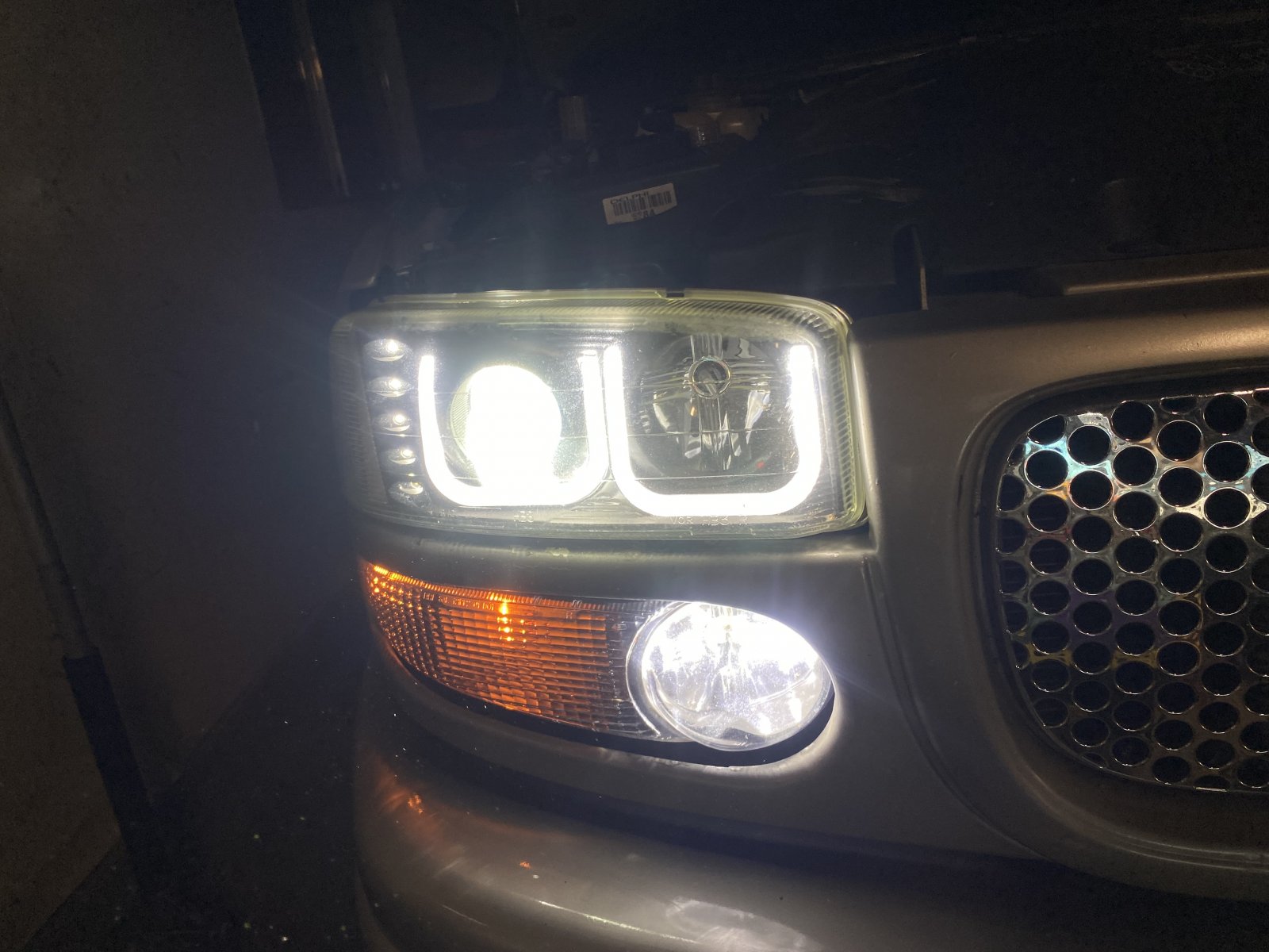

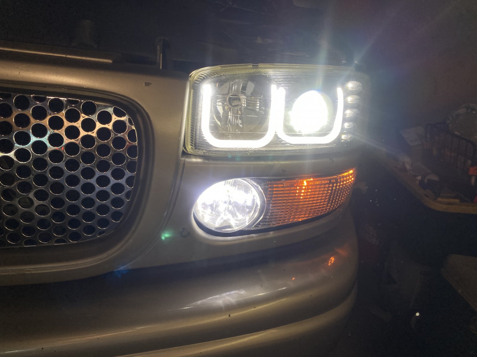

My drivers side lowbeam HID bulb has not been kicking on for about two weeks now. It’s been wonky because of the diodes ran in the under hood fuse panel to connect up the DRL circuit to the low beam circuit to keep DRLs on at night as my anzo u bars are tied into drl. Quit all together and so I took the fuse panel out only to find no pins or wires out of place…. Was chatting with one of my line dance buddies that’s got a 2002 Tahoe and he was like “did you take the bulb from the passenger side and plug into the drivers side to see if it works there?” I’m like no…..that’s too easy! well I’ll be dammed…. Swapped the passenger side into drivers side and it lit up as it should. Put drivers side into passenger side and no dice. That’s disappointing because two summers ago I bought Morimoto HID bulbs to run in the mini H1 8.0 projectors. The original HID bulbs that came with my retrofit kit were supposed to be Morimoto and showed up as Chinese knock offs. I ran them and they worked totally fine but decided to buy the morimotos….. well last summer when the Morimoto bulbs were only a year old the drivers side failed… started going pink and then not igniting. So I reached out to Morimoto and they shipped me out a replacement bulb under the warranty…. I will say that their customer service is absolutely fantastic. They were quick to respond and got a replacement shipped to me in like three days. Well that same bulb failed at roughly the year mark. So I’ve had two Morimoto bulbs fail in barely a years worth of usage. Weirdly though the passenger side bulb is the original Morimoto bulb that’s two years old now and hasn’t had a single issue. I highly doubt they are going to replace it again but I’m going to email them and see what they say. But sadly this has led me not to be impressed at all with Morimoto quality which sucks cuz I’ve heard nothing but good things about them.
At any rate I have the original Chinese HID bulbs on the low rams right now and both are working as they should. Haven’t had an issue with these despite being Chinese products lol. Will run these for now.
