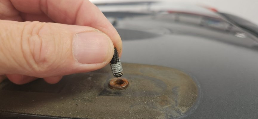

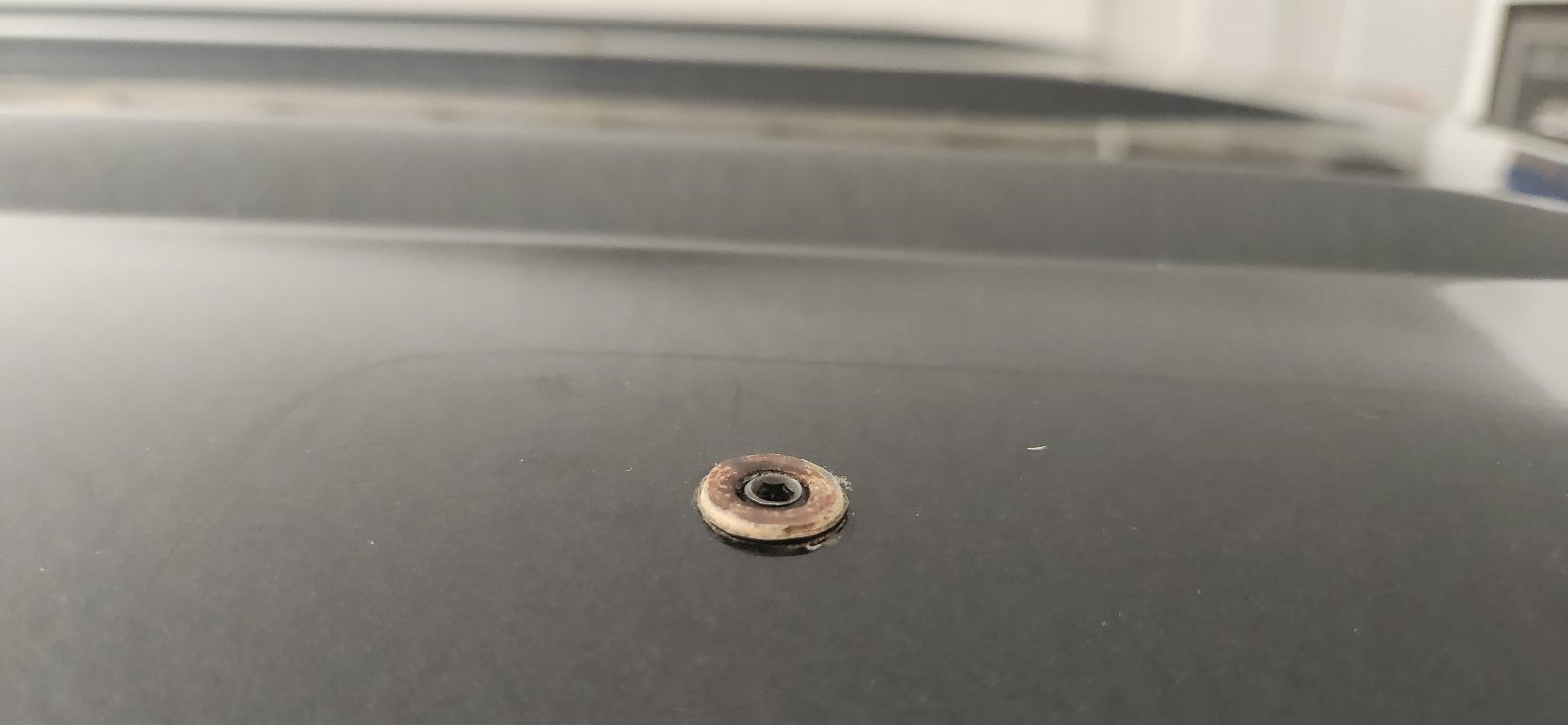

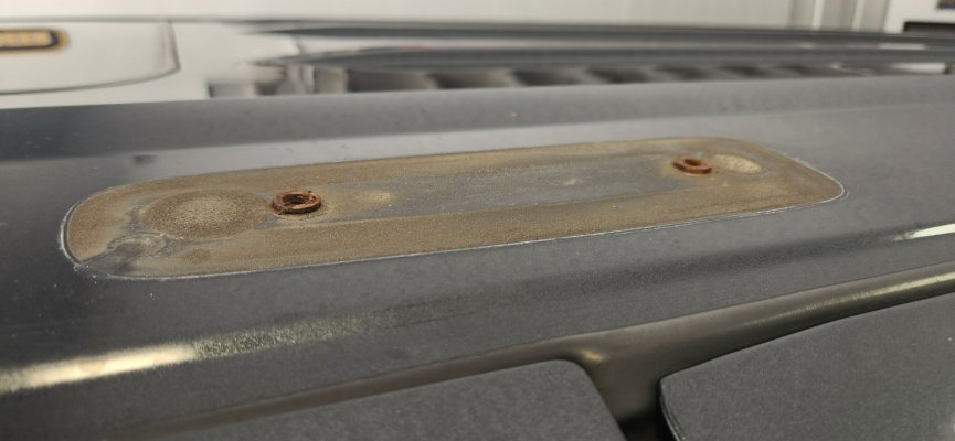

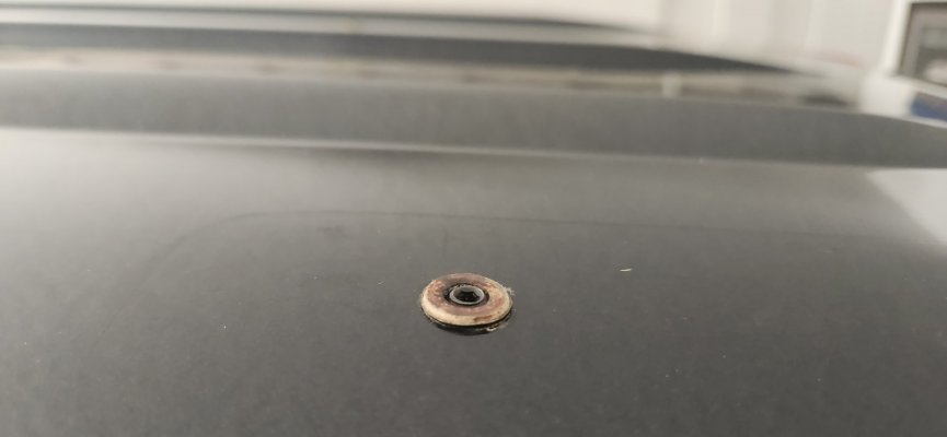

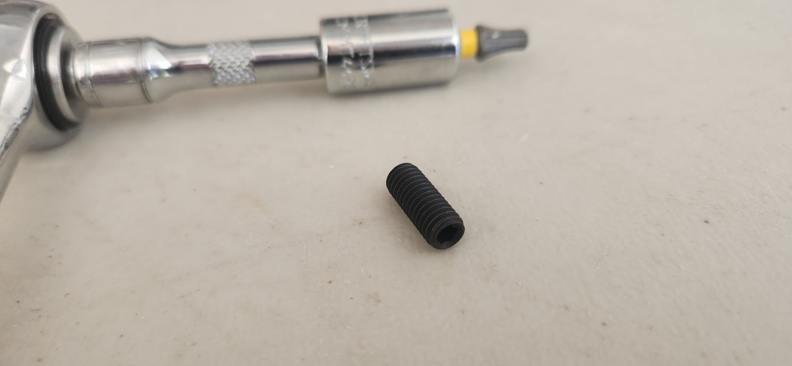

I like the idea, using a M6x1.0 - 16mm stainless set screw & good sealer to avoid water/dirt to accumulate ..... So, not noticeable.. ?
On those photos, it's hard to tell the screws are even there, so I would say not noticeable at all. I suppose you can also just leave the screws out and add a dab of RTV to the holes?
I removed the roof rack to paint on my 06 and the PO added a ton of silicone to the mounting pads (also cut off the bottom layer off them, so I had to replace them). The truck has a moonroof and it sometimes leaks, so I'm pretty sure he did that thinking it was probably the roof rack. The screw holes are actually blind holes, not through-holes. Kinda like a blind heli-coil insert IIRC.

I was planning to use set screws.. they will be flush to the 'hole'..... with a dab of sealer )
There is stuff, better than silicone..... ( don't remember what it's called at the moment, but it's for a marine use )
I want to keep the bumps as flush as possible.

I used anti-seize on the inserts...... Next, I'll clean & paint the 'cap', then a coat of a black marine sealer on top..

I just took mine off yesterday funny enough. Unfortunately I had a few bolts that were severely rusted and snapped in the hole. One was so bad it pulled the entire rivnut out of the roof.
It was definitely a smart idea to use anti sieze.
