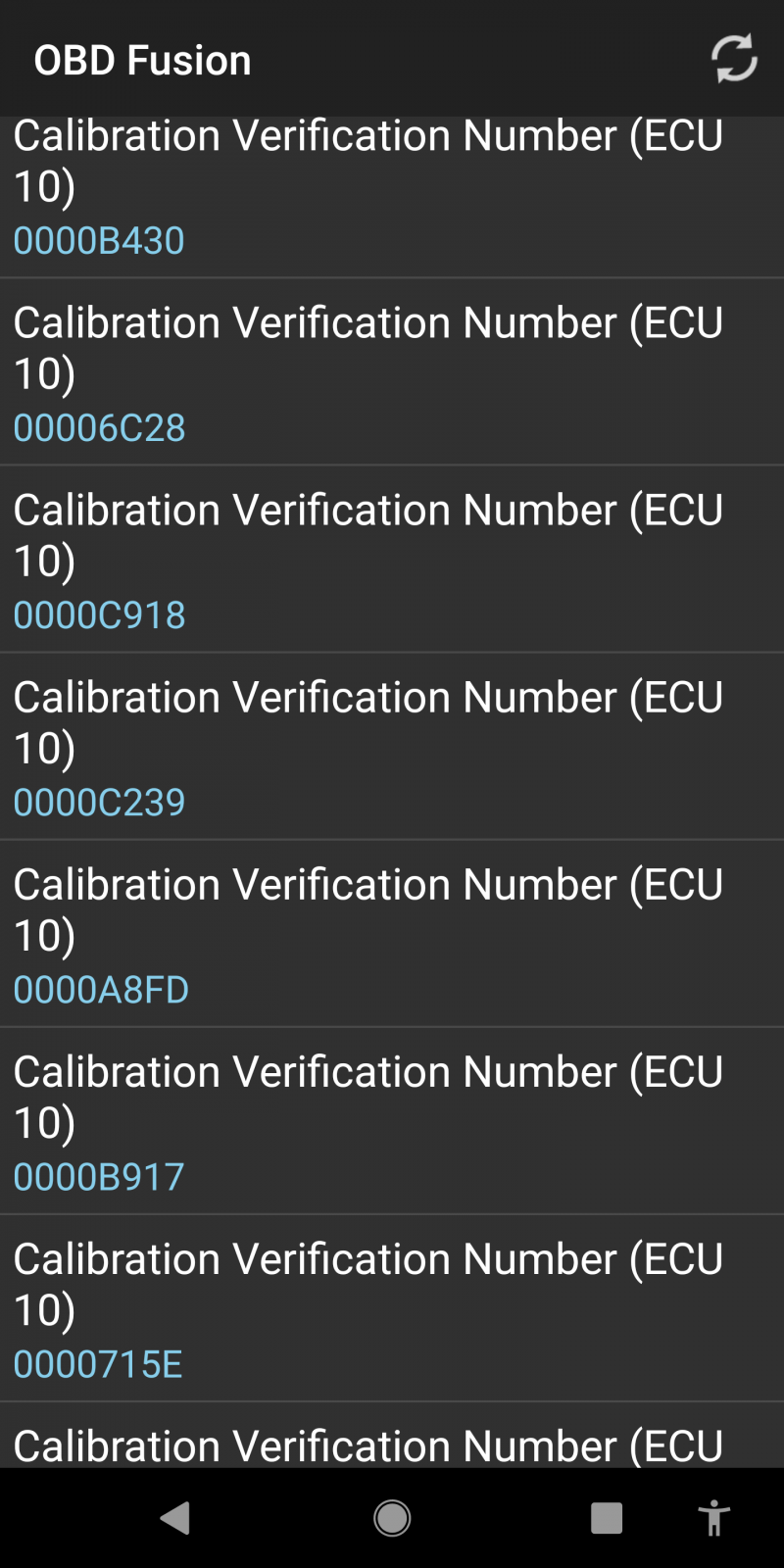

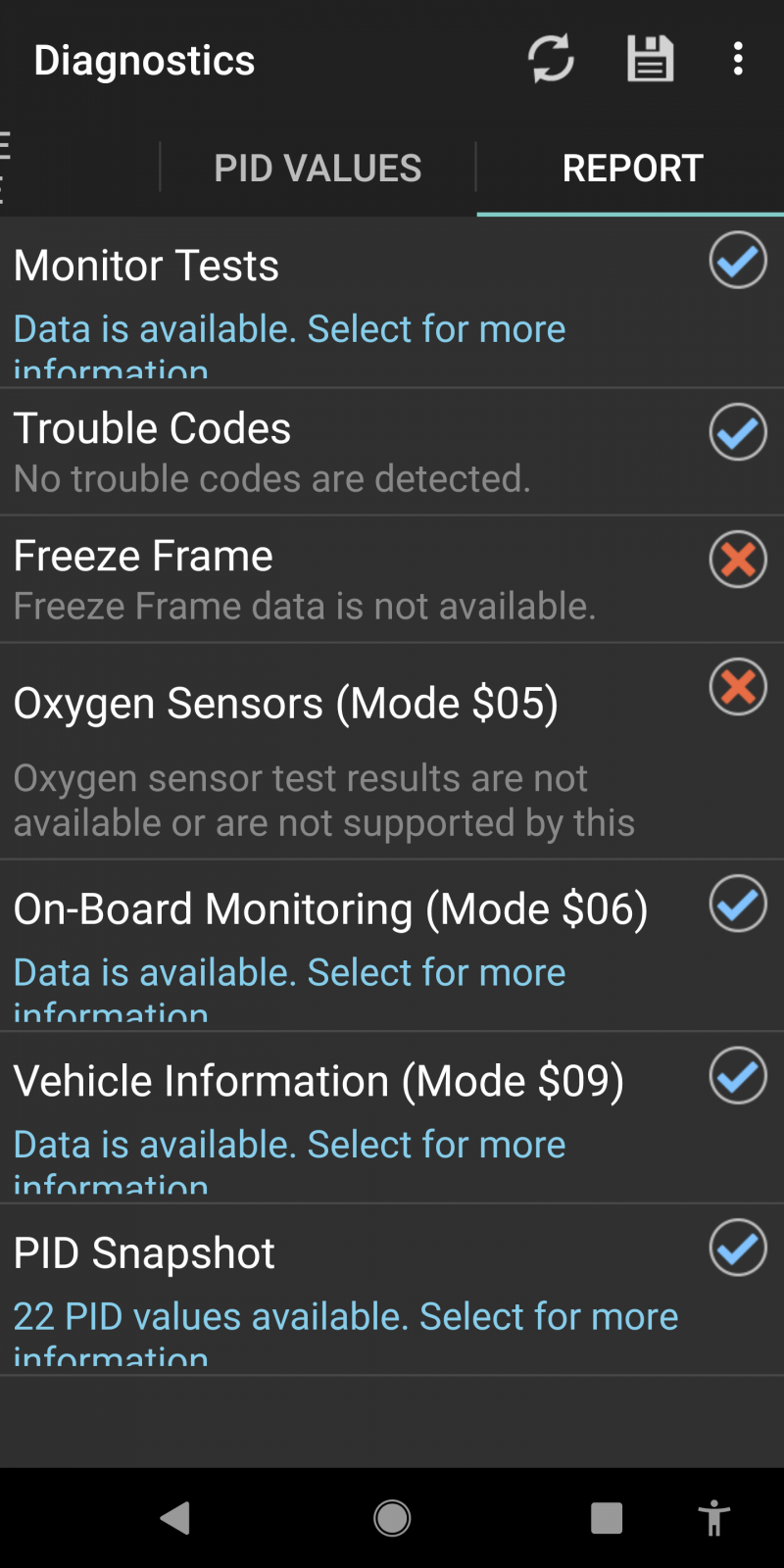

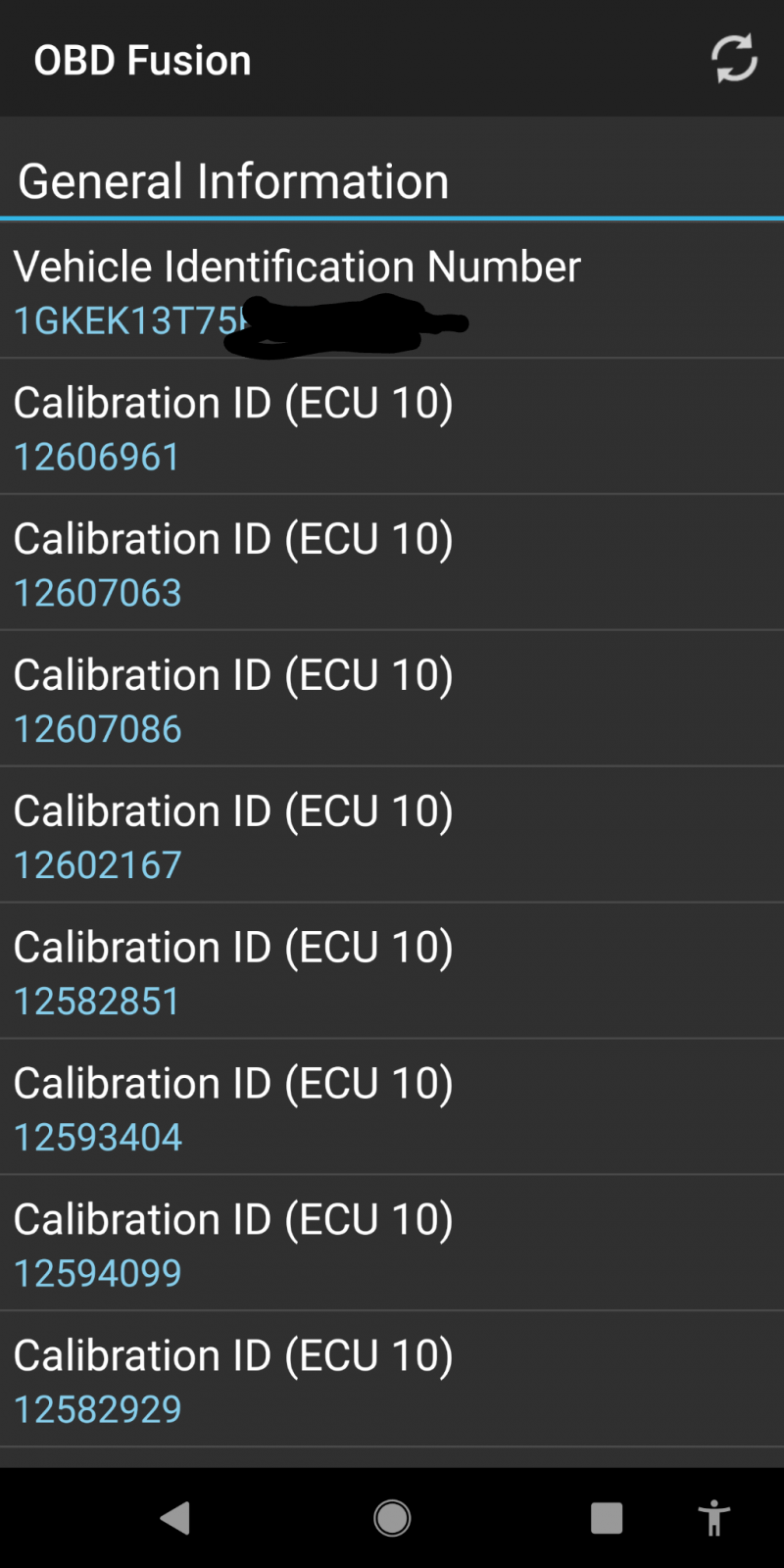

Some scan tools will display what your current vehicle software is
With regards to getting this information you don't necessarily need to spend more than about $20. A Bluetooth OBD2 adapter and an android app can read this. It is a standard service $09 request to the ECM. (This device will NOT do the Crank angle sensor error relearn)
I use a VeePeak Mini Bluetooth adapter and the OBD Fusion app for this.

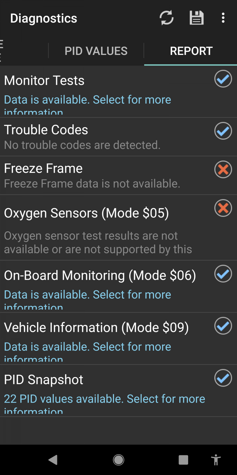

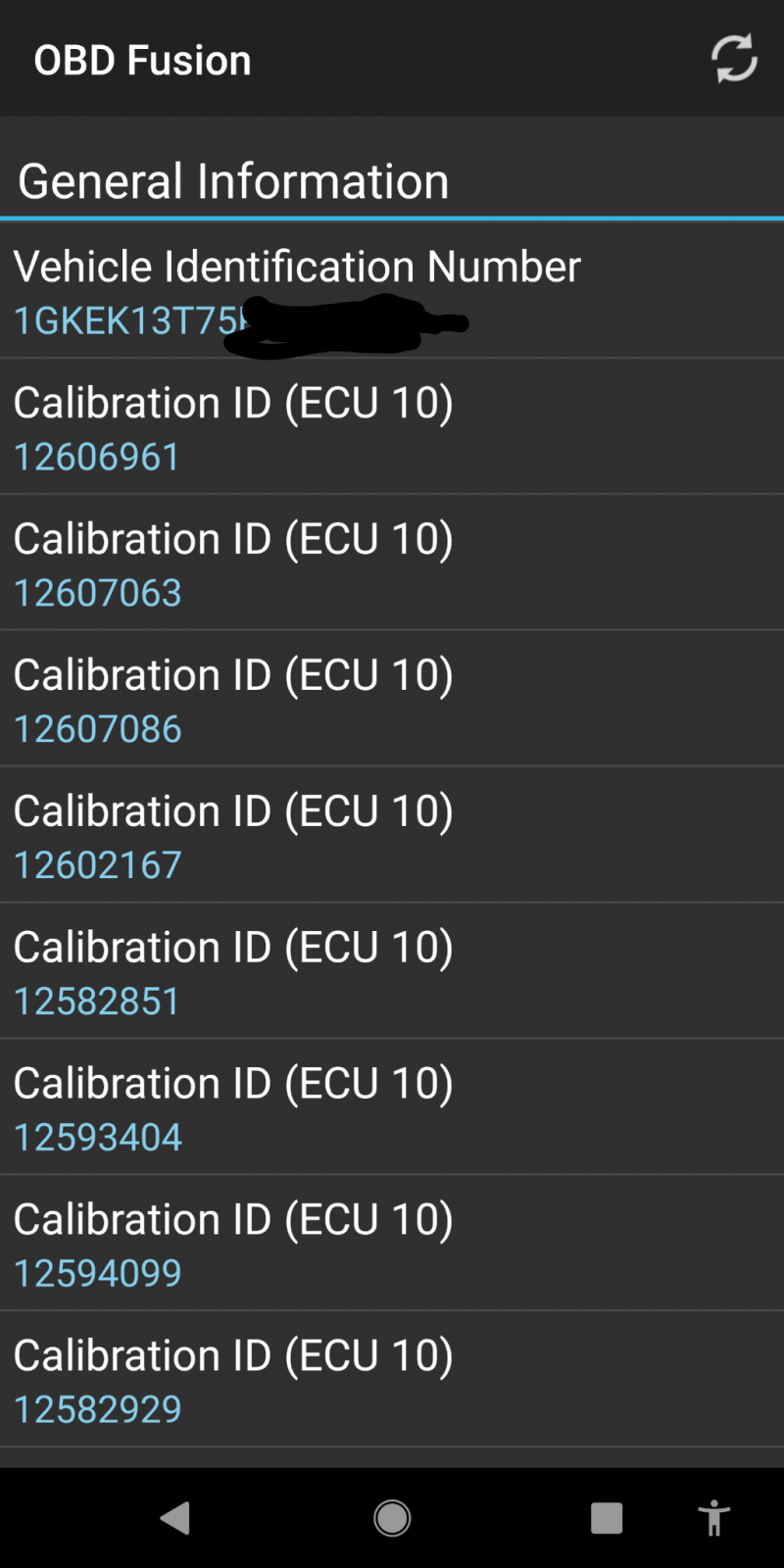

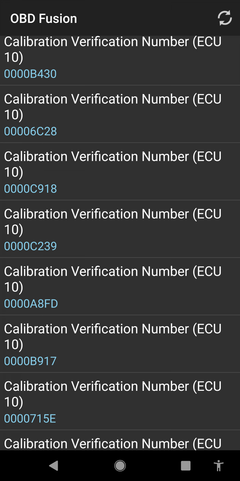

View attachment 273348 View attachment 273349 View attachment 273350
