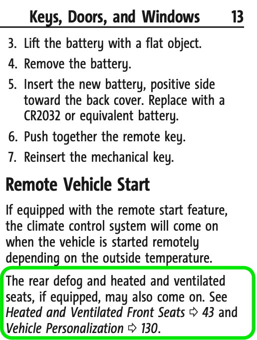

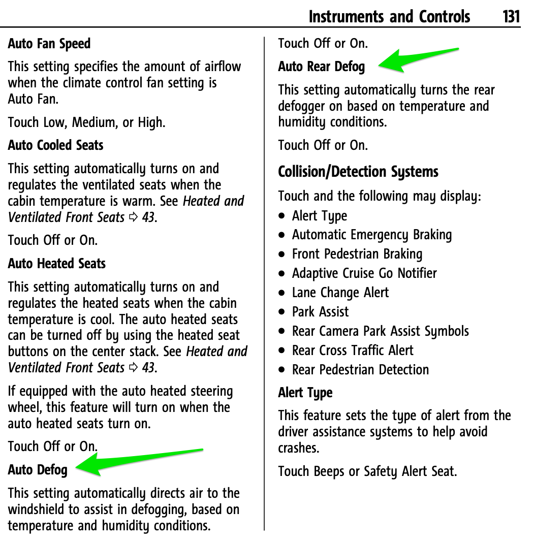

@Berkdog, According to the owners manual, Front and Rear Defog should come on automatically if the outside temp is low enough...since the heated seats and steering wheel come on, I would expect you to get front and rear defog as well. I know on a cold day, my Denali powers up the front and rear defrost. I am not sure the indicator lights on the HVAC controls illuminate when remote start activates them though, can't recall. So, maybe do a remote start and hop in, but don't hit the start button and see if you feel warm air coming out of the defrost vents. Unclear whether the vehicle personalization settings for Auto Defog and Auto Rear Defog affect the remote start settings, but try switching them on if they are off.
