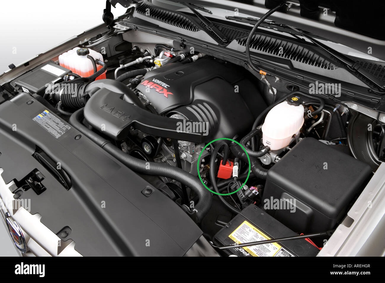

The positive battery cable goes to the starter. FWIW you could see if there is a connection issue at the starter, or a bad solenoid that is contributing to the drain. Have you tried disconnecting the cables from the red junction box to see if it changes anything?

I disconnected the starter solinoid and drain remains. Also checked alternatior and connections, same. What I'm asking for is advice on a good, reliable remote battery disconnect switch I can install until I can get the truck to an electric repair shop. There are only two in our area, and both are backed up at least 6 weeks.
