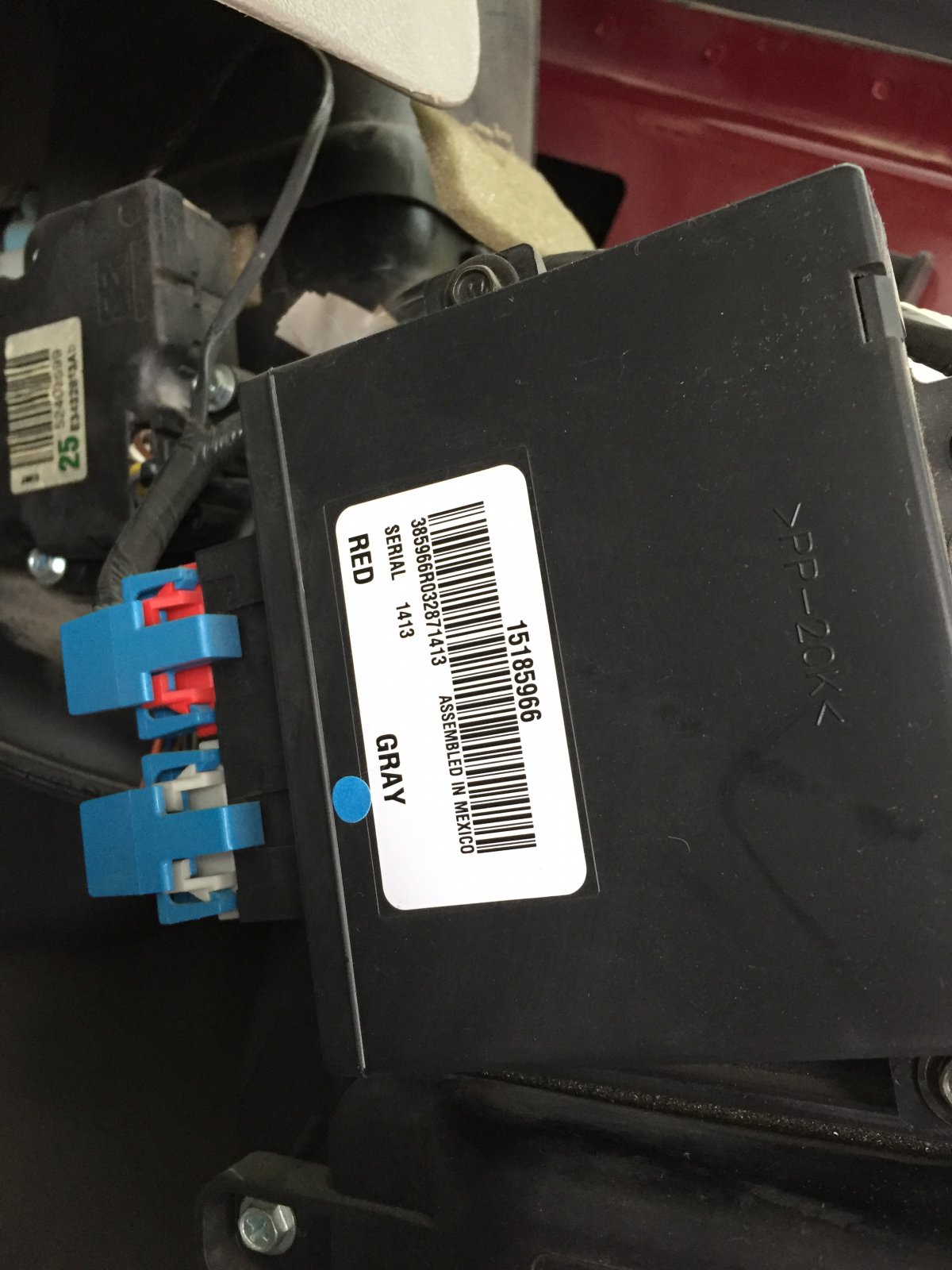

I followed what this guy did and tested the voltage at each wire. All of mine were good except for the yellow wires on both actuators were reading 0 (or very close to it). I'm thinking the control module is bad (part number 15185966) Can anyone help with this?
I don't have any real info to add, other than in my research on rear heat not working, it seemed the control module was the common culprit.

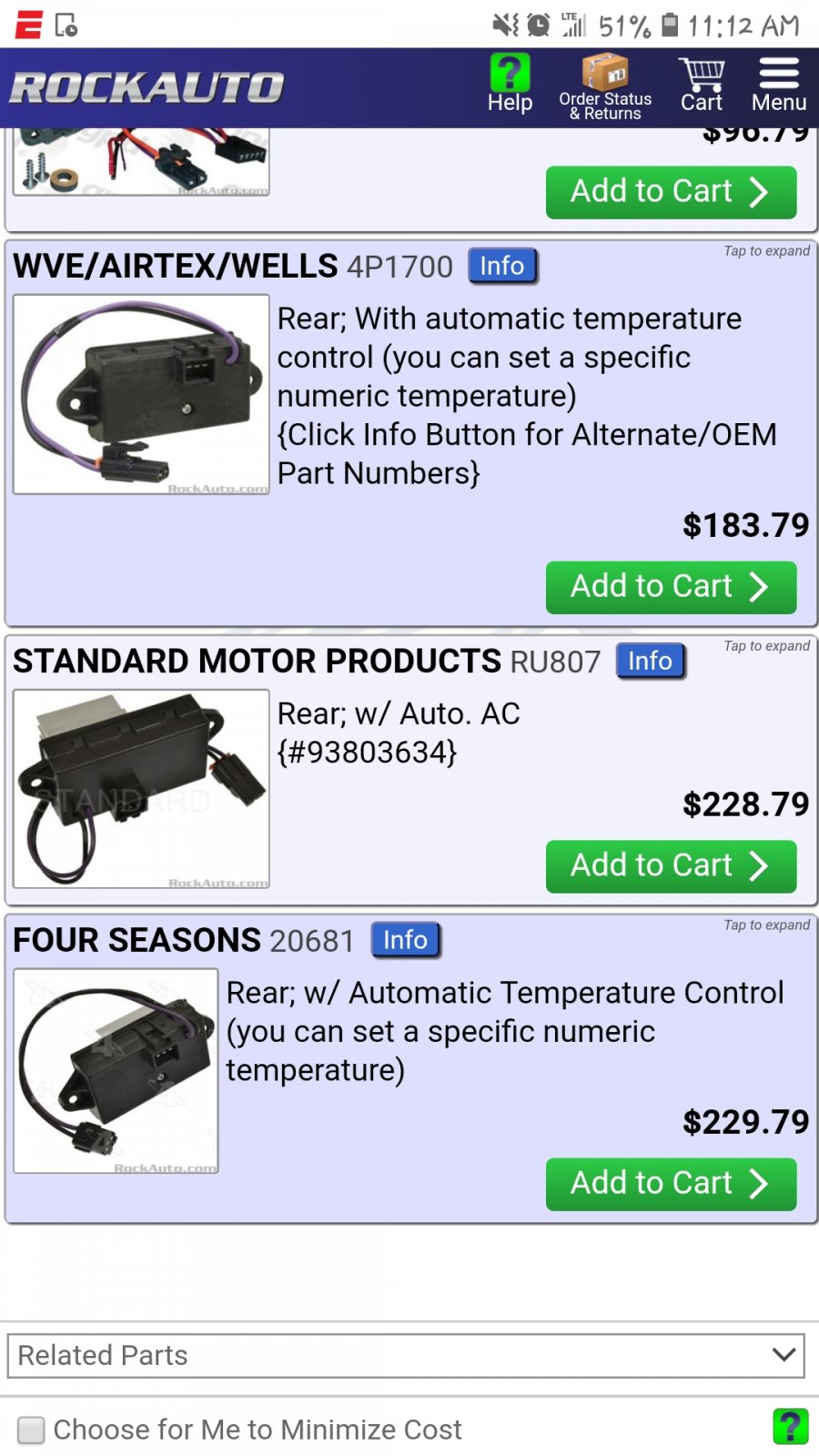

Not sure if you have the digital control or not, but I think it's one of these. There are a bunch....
