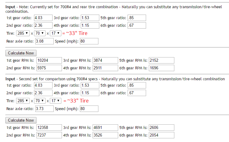

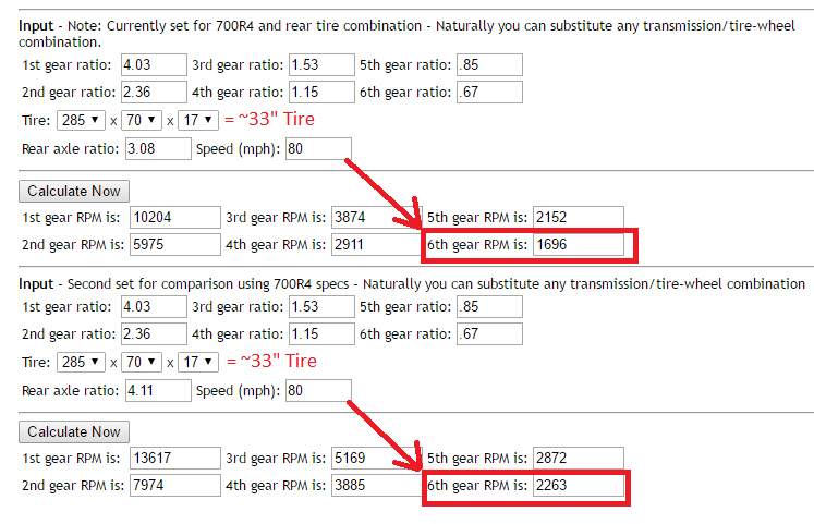

One thing you should do is take a look at a transmission + rear gear calculator as one found here:
http://chevellestuff.net/tools/rpm_calculator.htm
GM 6-Speed 6L80 MYC Hydra-Matic Automatic Transmission (Standard Typical tranny on a 2014)
First: 4.03
Second: 2.36
Third: 1.53
Fourth: 1.15
Fifth: 0.85
Sixth: 0.67
Reverse: 3.06
You can see the final input / speed here in the attached photo.
3.08 vs 3.73 gears + 33" tire
Note: This does not take into account tranny slippage etc so your real world values may be off +/- ~100-200rpm
Note: I changed the gear ratios and is NOT using a TH700-R4 transmission and is using the 6 speed transmission gears that come with our rigs.
Hope this helps in gearing!
