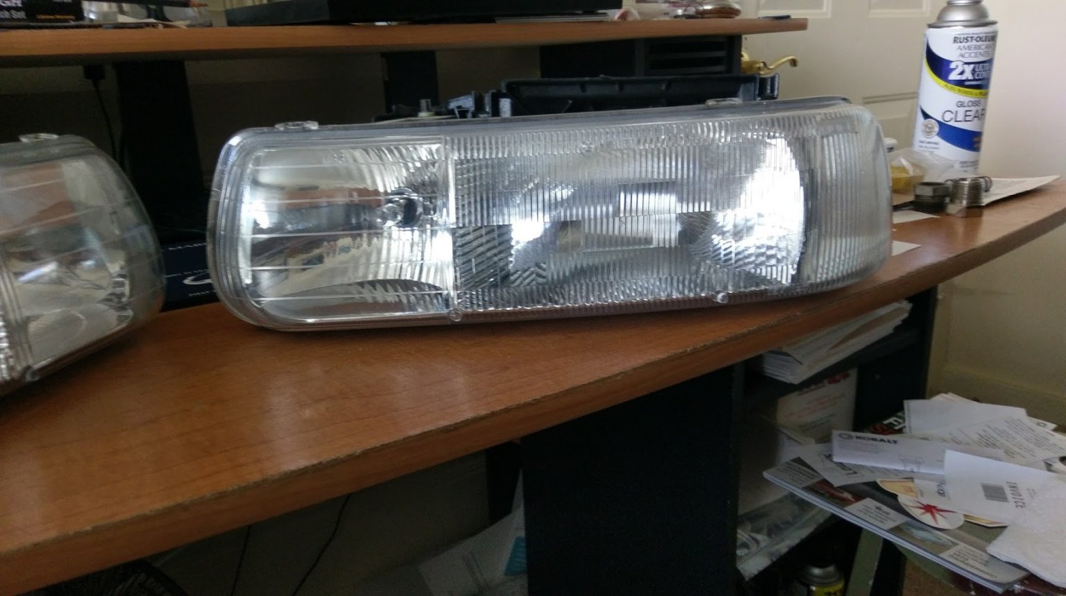

this was my first attempt at a headlight restoration on my brothers college beater. I used a 1000 grit/2000 grit and horror freight da with black 5.5" hex logic pads m201 and m101. Protected with aerospace 303 and then collinite 845. Significant improvement in light output.
I should've used a more durable pad as the black ended up pretty worn out.
Aerospace 303 has UV protection, but its a short term solution. That might last 6 months with collinite 845 on top, Maybe, but it was just what I had on me.

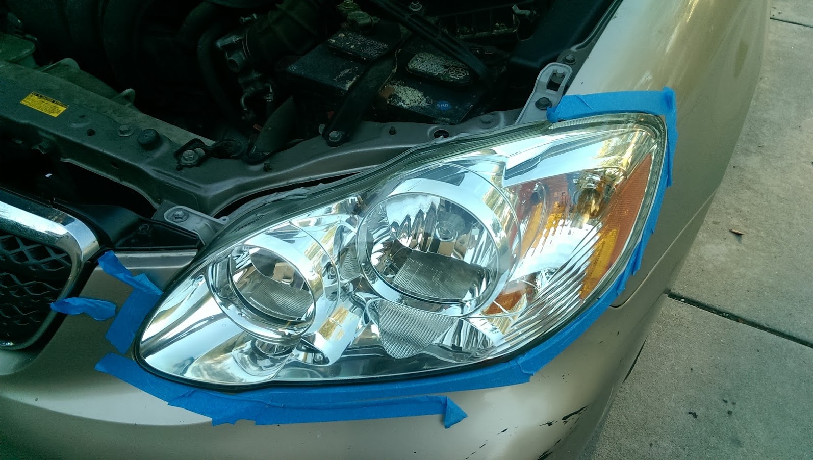

I wet sanded mine from 400-800-1000-1500-2000-2500 and then clear coated them with a clear coat made for plastic

i used rust oleum american accents ultra cover 2x gloss clear. i have buffed and waxed headlights and i would have had to rebuff and wax them by now. this is the only way i will do head lights now.
this is the day i painted them about 6 months ago
