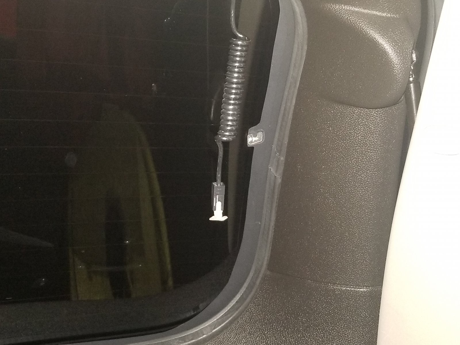

Look familiar, I watched a bunch of YouYubes and think I am going to go with the epoxy fix instead of the solder. I think the dog knocked it off, I will let you know how it comes out.
All done, solid tight with epoxy

It came out perfect, I took a little 2000 grit sand paper and very lightly touched it up. Then followed the directions, it is very solid.
