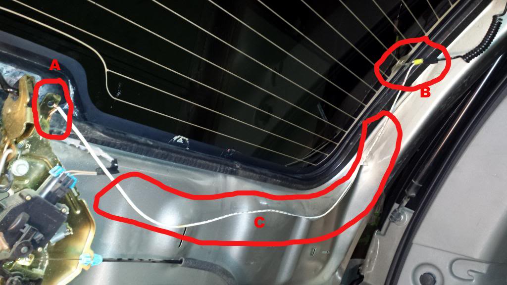

Hi I had the same problem I would hear the "click" but no heat at all. What I found out for my problem and I don't know if it would work also for you but it was the rear window not getting a good negative connection.
Here is my post with my fix
http://www.tahoeyukonforum.com/forum/showthread.php?t=56248
Its just running a wire from a metal part of the rear door to the driver side pin of the window defroster.
