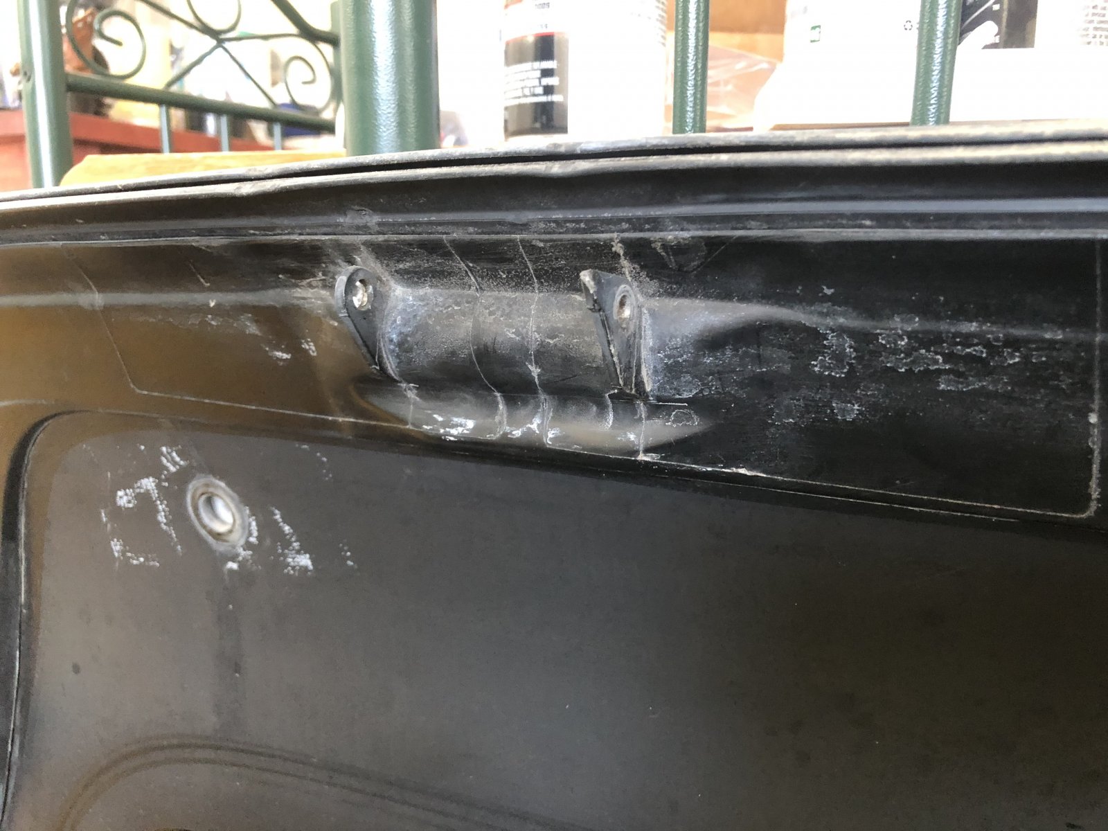

View attachment 258126 The "trim" is actually a structural urethane adhesive. Unfortunately, after a number of years of service, it can break away.
So, how is the hinge actually attached? Is that glass that it is attached to? Is the glass attached to a metal frame? What is that hole to the left of the hinge I see?
I have seen online many examples of this hinge giving away. Unless I can find a 2006 glass soon, I'll do another urethane repair.

I have no idea how the hinge is attached on the 2006 setup. There’s no metal frame that I can see. I’d guess it’s got adhesive right to the glass structure. All I know is that I was on my truck until a couple years ago when I swapped for an Escalade hatch and it never gave me any separation problems while it was mounted. Not like the other hatch. Anyways, the hole to the left you see is where the large black plastic trim that comes on every 2005 and 2006 tahoe, suburban, Yukon, and Yukon xl mounts. That’s where the screws go through the glass that mount that plastic piece. There’s three holes across the hatch just like the Escalade.

All the glass hinges from 2000-2006 will fit those year suvs. However in 2005 the rear hatch changed. The older style has a trim surrounding the glass and those were the ones that were prone to the hinges separating from the glass. The 2005 and 2006 glass didn’t have the trim surround the glass and just had a small handled bolted through the glass at the base. Not sure how the hinge setup is different they’re not prone to separating like the older ones.
Edit: I just figured out why the hinges are different and why the 2005 style glass hasn’t separated. I’ll post a couple pics.

I saw at a junkyard an 02 Escalade with the 05/06 glass. Must be true. The pictures look deceiving, but the 02-04 has a rubber flap glued to the top of the glass, the 05/06 has that plastic molding mounted to the glass. I'll see soon enough I suppose, when I find one.
