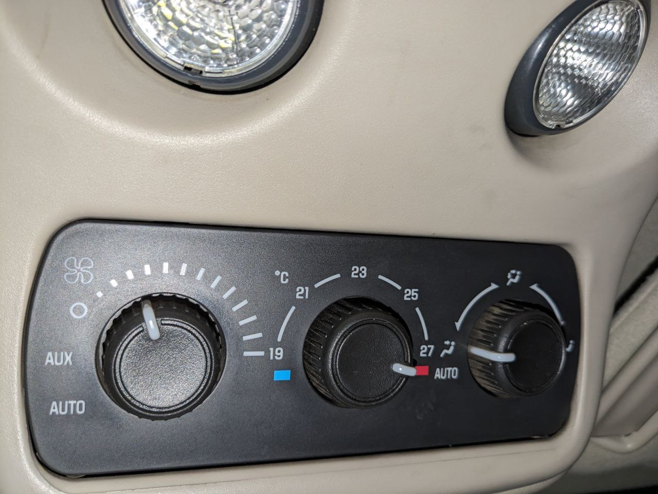

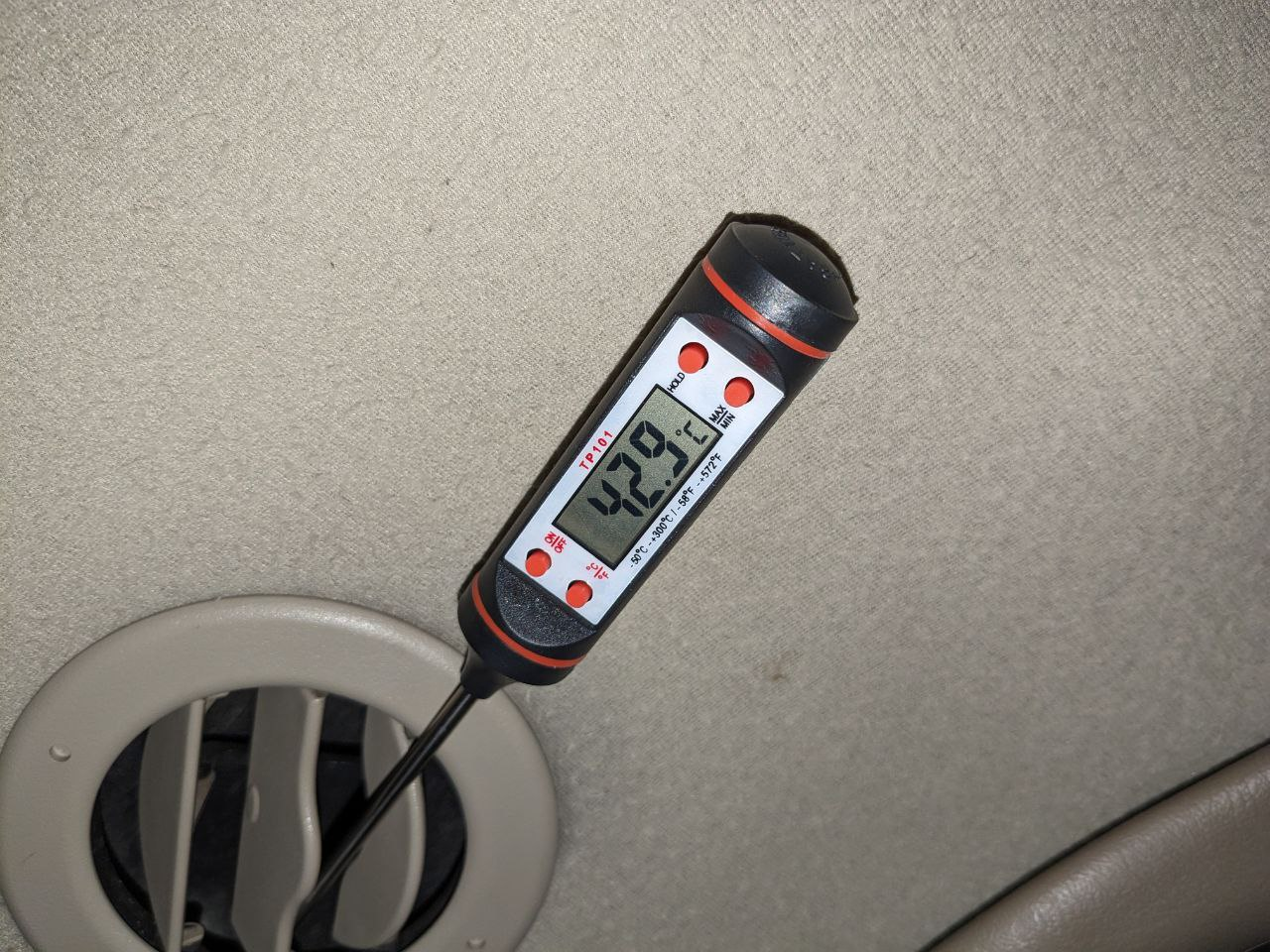

just for the history if someone will be curious:
tahoe 2004 5.3 idling
it is -16C (3.2F) outside
rear heater vent is little below middle position, temp is set to red, ceiling (see attach)
temperature became 42.9C(107.6F) in about 15 minutes from the start (but it wasn't cold start, the car was little warm)
pump is new and original
antifreeze is full as should be
