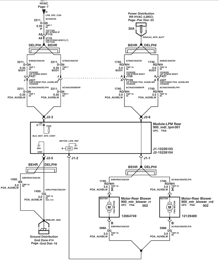

Im pretty sure the rear blower motor resistor might be the problem but i'll ask anyway.
The rear blower motor blows very little air out the vents. Is there any setting i don't know about that adjusts the speed of the motor?
mikez71
Mar 9, 2023
3,355
4,159
The rear controls should adjust speed, and the front ones too with 'rear' button on...
although they can become de-synced with front controls if the rear controls get used, but will re-sync with an off/on press of the 'rear' button.
Think you're right on the blower module..
