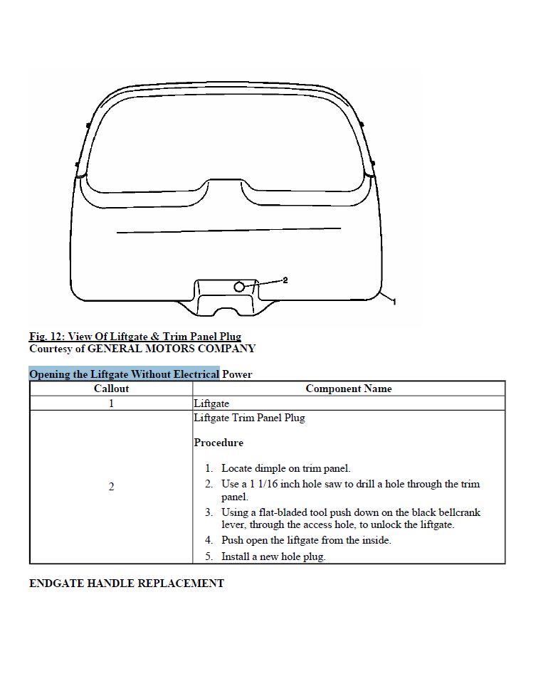

There isn't one since according to the government, nobody is supposed to be back there.
There is a dimple in the plastic cover which denotes where the actuator is for manual control with a flat bladed screwdriver. On my 2009, it is called the Inoperative Liftgate Modification by GM.
The part number for the ebony plug is 20986933. Again, this is for the generation after yours. When the guys wake up later and have their coffee, more will chime in.

Whats wrong with your outside button? Seems if you are going to need to get into the hatch to do a interior release mod then you might as well fix the button mechanism if its broken instead???? Most of the failures on these type of release is the plastic connection on the actuator rods. The plastic breaks or the plastic bushings on them split and fall out of the plastic connector.
Because of the weapon locker in thecopcar, I’ve done a preemptive drill of this hole to reach the lever. There’s just enough space to reach it by hand between the locker and closed liftgate.
