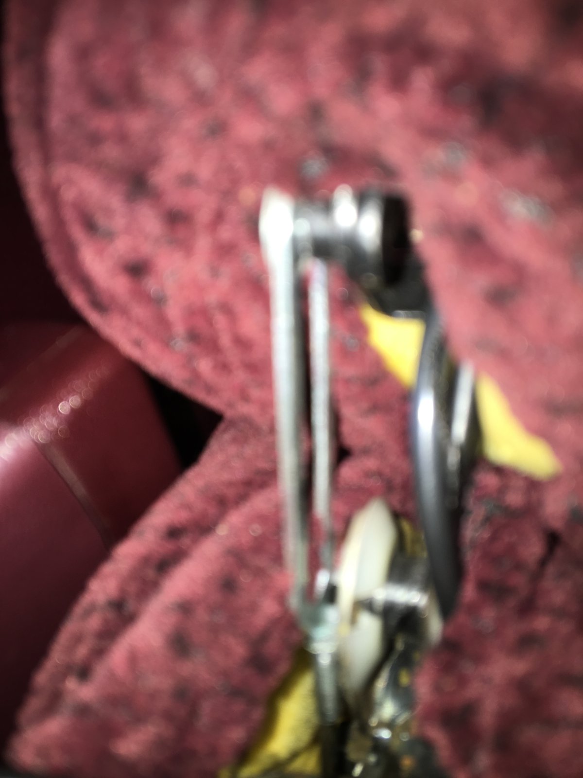

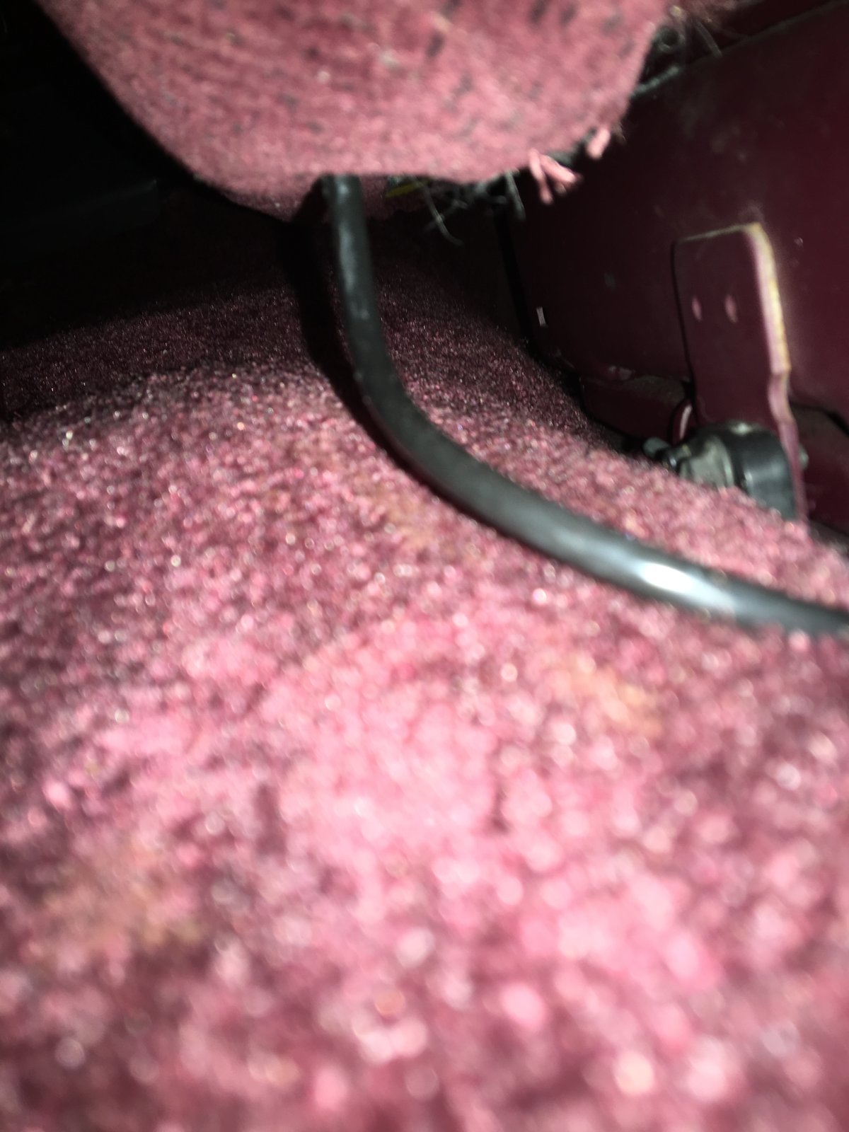

My seat doesnt slide up all the way like it used to for the rear entry. Anyone else experienced this?
This seat has a two stage seat bracket one operates on springs the upper is operates on a cable. Cable is broke I posted pics at one time lean seat forward look inside twards console you can see cable I found cable on extended cab pick ups bought a few for 5 bucks
the the second stage that doesn't work. i have a feeling you know exactly what is happening to me
