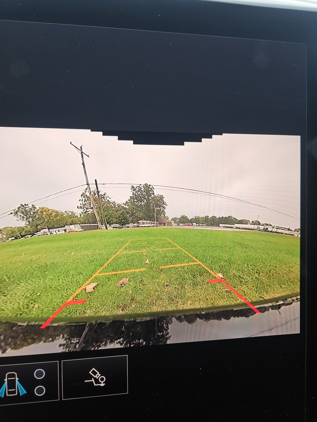

Is it normal for the rear camera to have the stair step effect blocked out on the top like this? This just showed up in the last few days. Camera issue or software issue?

Take off your license plate frame and that problem goes away. License plate frames are not compatible with 2025 and 2026 vehicles, they torque the camera and its aim.

Did not know that.... thank you.....
