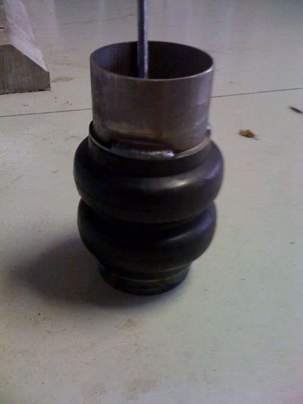

does anyone have pics of the rear air bag brackets,( or pics of them installed.
i've looked around and all i've seen is the bottom bracket. would like to get a idea of what the upper looks like and how it installs.

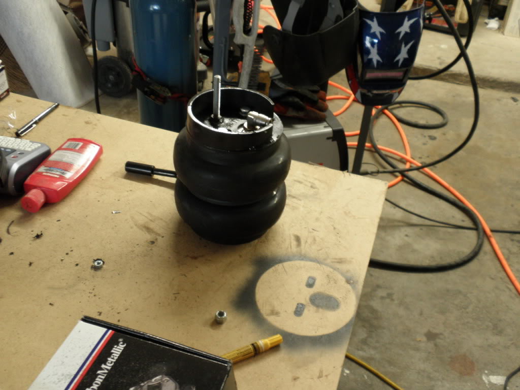

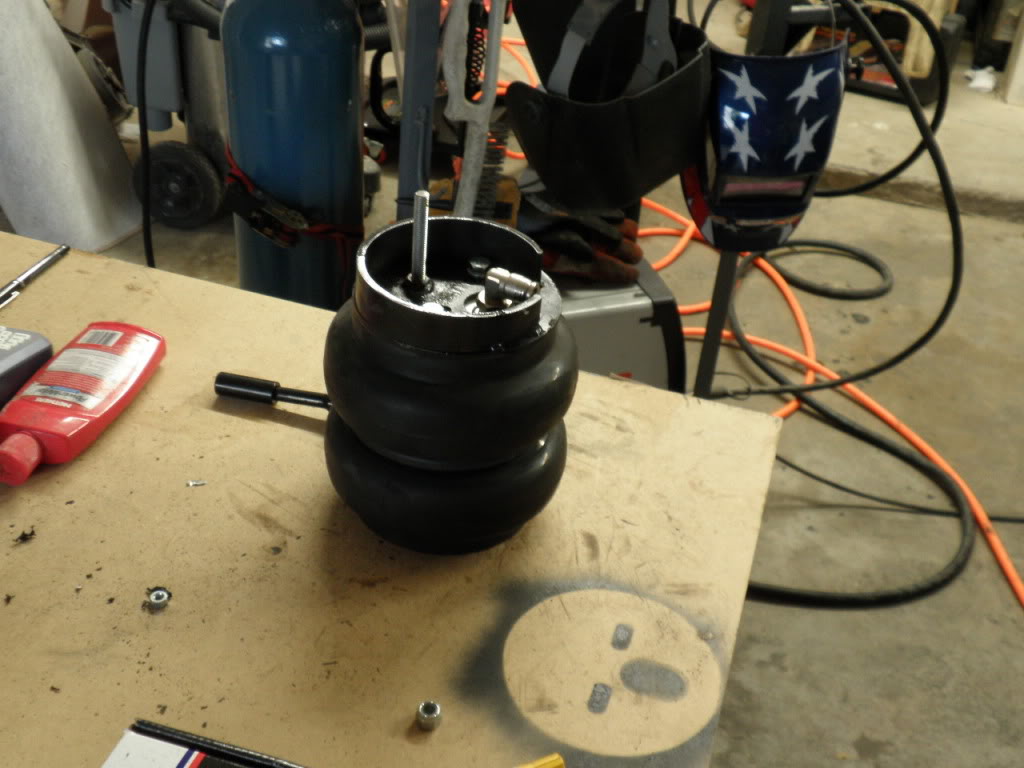

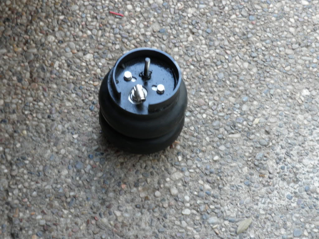

There are a few different types of brackets you can get, but you're mainly looking for bag cups. Attached is the picture of the ones that I got from CoolCars. They are a pretty simple install, and you can cut them down/modify them if you want some more drop. The top bracket mounts by the threaded stud that you put through the top spring mount by drilling a hole and then attaching a washer and lock nut to hold it down. They won't get you super low... but will do the job if your looking for something simple.
