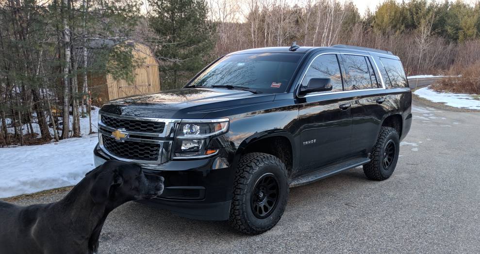

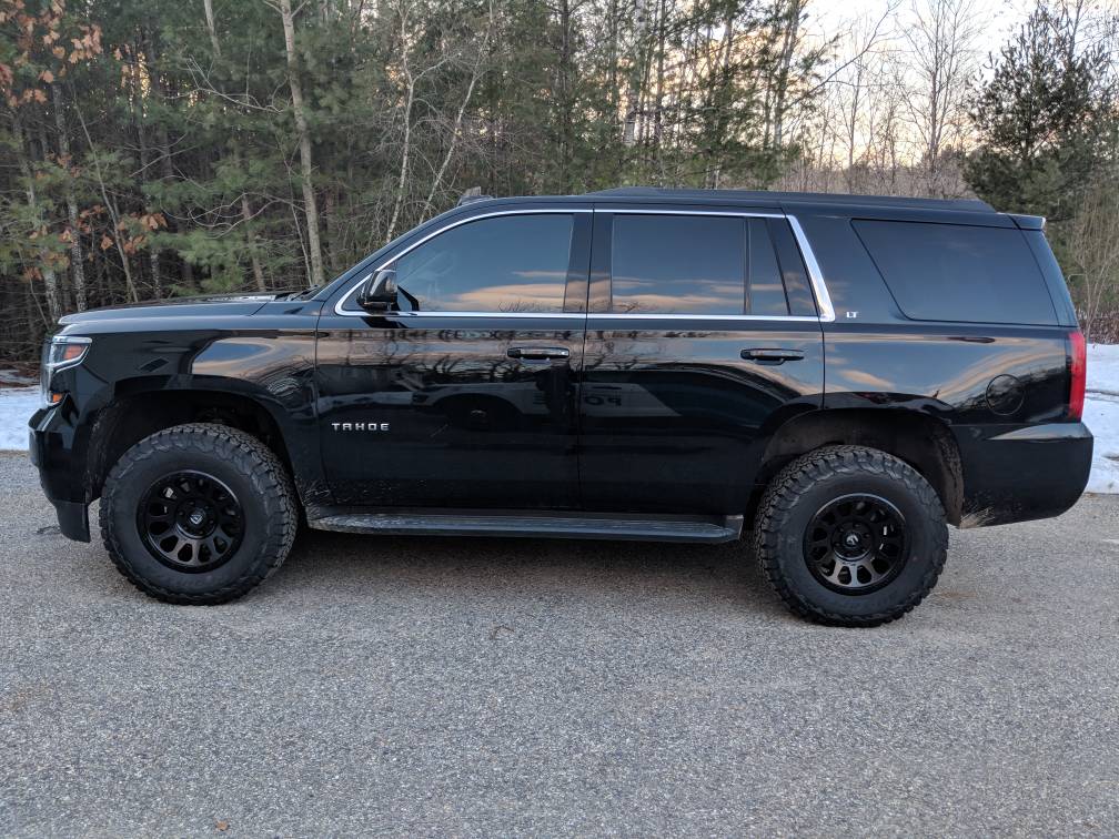

Went with the suspension Maxx 1.5 rear for magnaride.
Sent from my Pixel 2 XL using Tapatalk
RobertHunden
Jul 6, 2016
Looks fantastic! I'm excited to have this installed and bring up the rear end of my Tahoe. Thanks!
