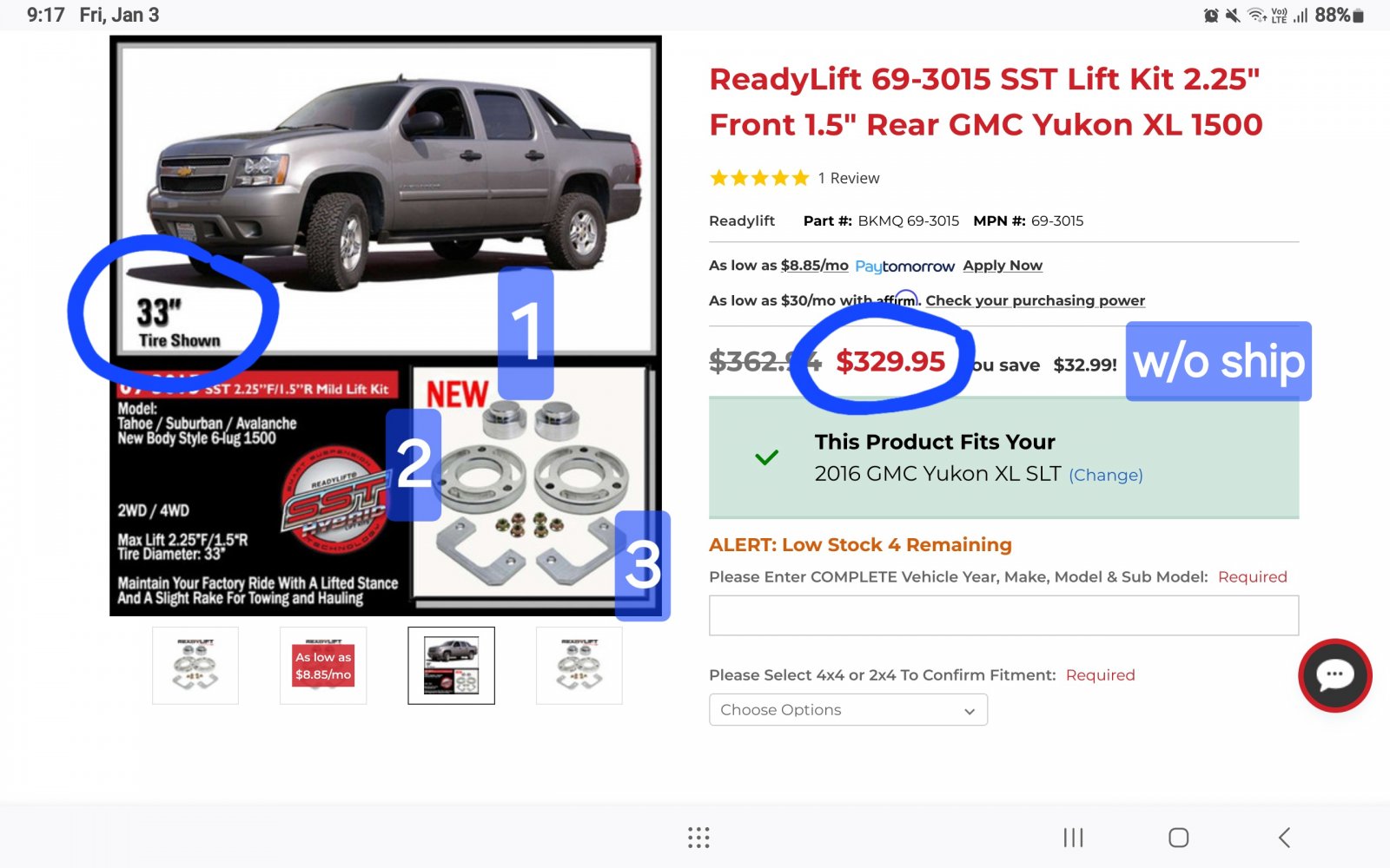

Good morning...
Would you advice me plz about this kit..
The price, brand, company, type..etc
Stock front (non-mag)/B4600 rear suspensions and stock wheels (265/65 R18) Is it ok? Lifting (hight & level),wheel/rim size and riding? I like the shape of face lift but not too much hight (like Sierra)
I saw some saying Yukon XL 1500 and some saying Yukon XL and others Yukon Base when I choose, what is the differences?
Thank you all

You can buy the same spacers separately on Amazon and eBay for around 100$ if not cheaper. No need to spend 350$ if you can spend 100$ on the same stuff..
Also the Tahoe Yukon and Escalade models of that 07-18 body style use the same suspension
Same for the front anything from a 07-18 Silverado sierra tahoe Yukon Escalade avalanche will work as the front suspension is all the same
Instead of both upper and lower front spacers I’d just opt for a 2” LOWER strut spacer as it’s much quicker and easier to install without having to remove the strut from the truck

60$ vs 330$ no real difference in the quality and I’ve ran that brand for years without any issues at all.
I think I did eventually swap out the bolts for some stronger grade 8 zinc plated ones but that was about it
