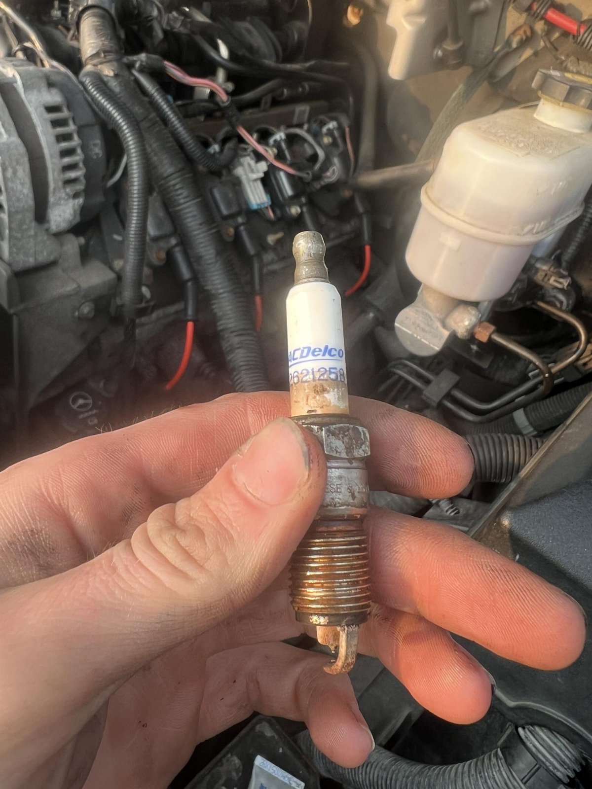

& why, yes, that
is the back plug really that bad?
makes me wonder if it's harder on the non hybrid trucks. I don't remember any extra hassle when doing mine.
amazing a plug still fires with 300k lol.
i didn’t find it to be all THAT bad. but then again, these plugs were changed by its PO (half-assedly, “changed” is debatable here)… so the wires were the ones without the metal heat shield & spring contraption thingy & from what i’ve gathered - that’s the part that’s difficult because it like locks on & it pretty much needs a special tool to release it but GM made theirs wider so the tool barely works anyway mixed with the fact that the space IS very tight.. i can see how that would be dreadful.. but not “f it - leave it in for 310k” kinda dreadful lol … i have small, very skinny hands & fingers so i was able to wedge my hand between the trans dipstick tube & the heater core lines & pull it off but like i said - i didn’t have to worry about the metal shield giving me hell. i was able to fit a 1/2 ratchet with a 1/2 - 3/8 reducer & deep 5/8 back to it without an issue & take it out. i couldn’t fit my digi torque adapter back there tho & i have a serious grudge against clique torque wrenches so i hope it doesn’t blow out that would suck but anywho… that’s what i did. lol
dude. 310K… can you believe that? i can’t. i am trying to distract myself from the thought process of “hmm. they’re not supposed to go that long. at all. i’m going to google damage of driving on a failed spark pl——-… stop” lol. it’s like webmding yourself but worse.

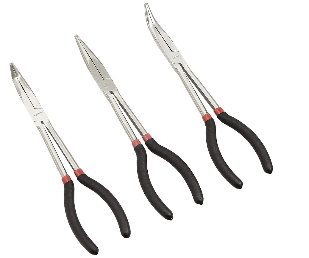

those shields and #8 are easy with the right tools
the shields can be handled with a set of these, bought the set of 3 orange handled ones from harbor freight probably 20+ years ago, come in handy for all kinds of things
the mildly curved one (far right) is perfect for reaching in and grabbing the shield and walla it is off and out of the way
don't even know how many times that same plier saved me for other things over time

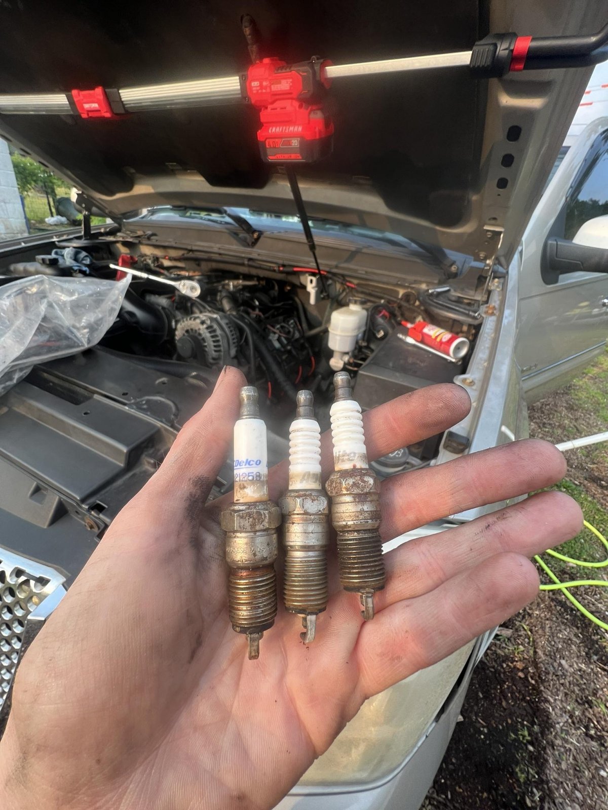

See them now. Does not look like a 300k miles plug.
i agree - but this was a limo prior to being mine & all service records are in the glove box & on carfax…. plugs were only changed one time …. so it really is lol… i thought the same thing. but compared to the others - it is the worst one. the wire is burnt on the inside also … i try to take care of my engine - i got it with 250 … one iridium spark plug tuneup would add up to those miles. & #8 being acdelco with the iridium GM part # … it’s factory

it definitely looks like it's been in there a long time. I believe mine had 140k on them when I changed them and yours looks more worn down. take a while to do that but honestly I don't think it hurt anything. looks pretty good.

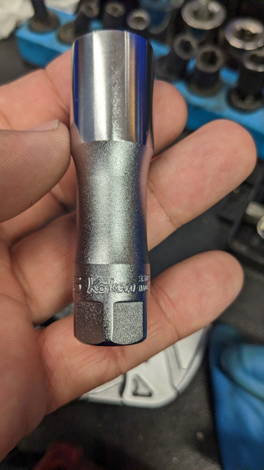

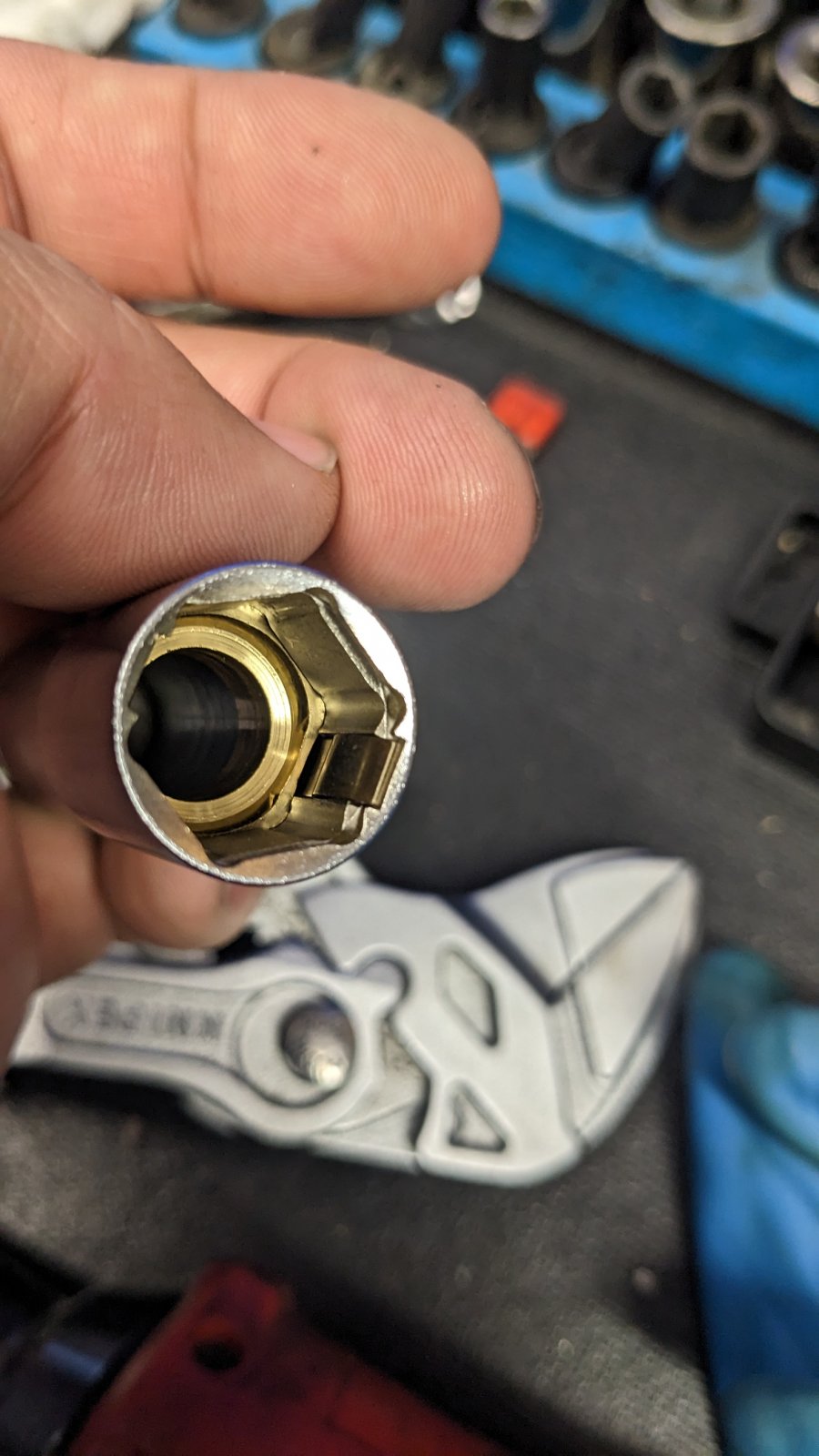

as for getting to it, I'll share a pic of the only spark plug socket I actually like.. it's a koken, made in Japan. last place left with any sense of craftsmanship in their hand tools. it holds the plug in without the rubber insert that gets lost and without a magnet. their hand tools are like holding jewelry lol. this, I nice flex had 3/8 ratchet and of all things the cheap black, (I can't call them impact) extinctions from harbor freight. it has this little 1in in the kit that I sware comes in handy weekly.
