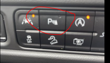

Hit the parking sensor button to the left of the steering wheel under the vent. This will disable the auto braking feature. My truck freaks out sometimes when backing out of the garage and automatically stops me and at the same dirties a set of underwear. So I usually disable it until I am out of the driveway. This button takes care of that.
This is also useful if you have someone back there and you are backing up, to say, maybe hook up a trailer...just sayin, while I appreicate the safety aspect...sometimes it is useful having a friend back there to hook the boat up for you while you are driving...
