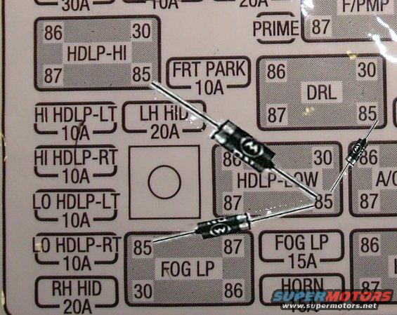

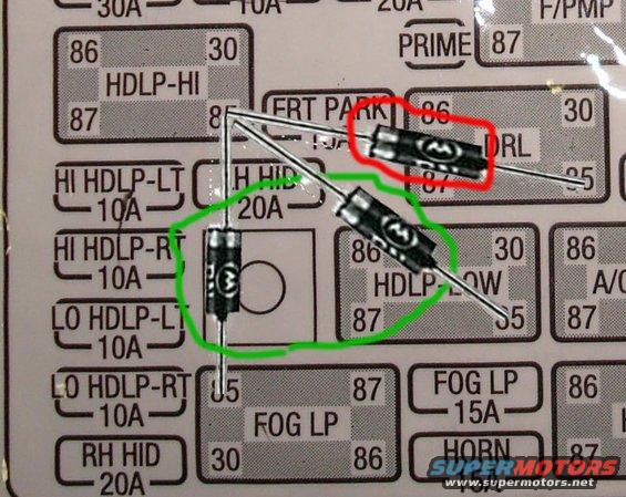

OK I want to do the High 8 Mod on an '04 Z71 but I want Low 6 (DRLs, Fogs and Lows).
I see the High 6 Mod like this (Circled in green)
For High 8 you add the one circled in red?
Would that give you Low 6 with Auto Headlights and only DRLs during the day?

still just DRLs during the day, and lows will just be lows. only when you hit the hi's when all those turn on. so no lo 6, just lo "2". i've got mine running from the DRL's and fogs to the lo's relay, that way I've got lo 6, but if I hit the high beams, just the high beams come on, everything else shuts off
