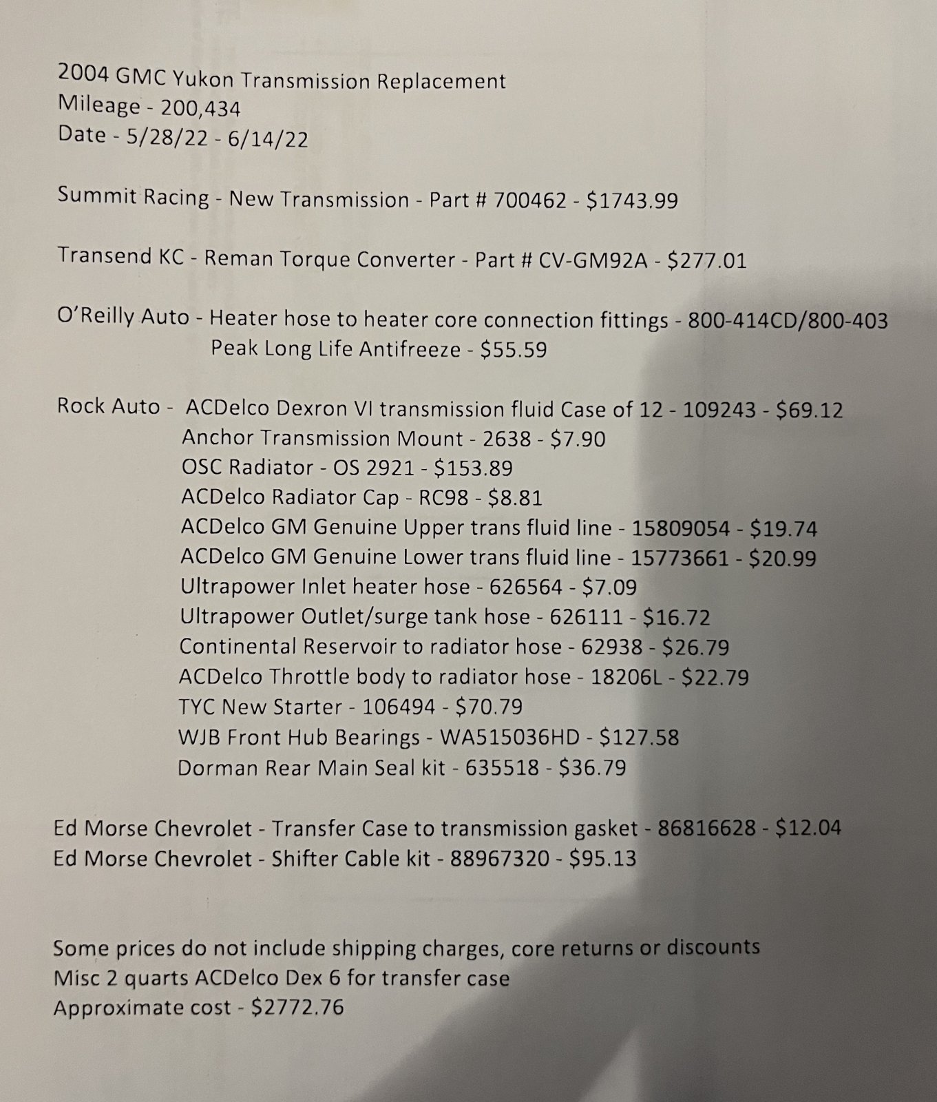

I then started to contemplate doing it myself and looked online for shipped to my door prices. Enter Summit Racing… They have an exact fit new transmission for our trucks that will support 450 HP and is advertised as correcting all of the factory defects that the factory ones were born with. The case and bell housing are stripped and painted, the guts are brand new, and they throw in a polished finned trans pan with a drain plug, all for the measly price of $1749 shipped to my house on a FedEx lift gate. I was sold. The only issue I had was the back order for the trans was excruciatingly long. I ordered it in February and got it in mid May. I ordered a converter from a reman shop in KC. I ordered a couple of parts from my local Chevy dealer and I ordered all the rest from Rock Auto.
I came in at approximately $2800 with all the parts I replaced and my labor. I had no help and spread it out over 5-6 days working here and there. The truck runs great and that transmission from Summit, so far, is worth every penny. Got about 175 miles on it so far and it has been great. I replaced the radiator, factory original, the trans lines, and a bunch of other stuff. Attached is my parts list with vendors, part numbers and prices.

I did the radiator and the trans lines because there was no guarantee that flushing would get all of the old fluid out. The radiator was also the original one so that was just a matter of time. I replaced the four hoses for the same reason and because I did the upper and lower rad hoses when I did the water pump and thermostat a couple of years ago.
The torque converter I used was a suggested part doing a search on this forum. I didn’t like my choices at Summit Racing because I just wanted a stock stall OE ride. The GM replacement was on indefinite back order. The trans mount is a no brainer. The starter got replaced because a stud on the solenoid snapped when I went to loosen a nut to remove the wiring and because it was oil soaked on the inside from the rear main seal leaking so bad.
The rear main was worse than I thought. A few months ago I replaced a lot of gaskets because of leaks and the Dorman rear main kit was one that I bought. I’m glad I didn’t do the rear main 8 months ago and then have to pull it all apart again for the transmission. Definitely do the rear main seal if you are DIY-ing the transmission for any reason.
Even though I dropped $2800 on this, the amount of work that got done could have easily hit $6k at a shop with today’s pricing shenanigans. I’d like to keep the truck for a little while longer as a back up car so this was worth it to me.
The Harbor Freight trans jack I bought in 2020 to do the slave cylinder on my GTO paid dividends on this job. I was also really surprised at how well things came apart with 200k miles on it. Besides the stud on the starter, the only other bolts that broke were the converter pipe to muffler pipe bolts. The heater core to hose connection adapters also broke on me because I leaned a little too hard trying to keep my balance working back there. They were original pieces as well. Overall, this was a time consuming but rather simple job to do.

Two more things worth mentioning about this replacement… I went to AutoZone and bought a Felpro transfer case to transmission gasket and it didn’t fit. It was off by half a stud on two of the studs no matter how I positioned it. Took it back and went to O’Reillys and bought their Pioneer gasket. Same thing, it would not line up properly. I am thinking WTF at this point. That is why I went with the dealership parts gasket and it was perfect.
The original shifter cable had been broken for some time where it slides into the bracket on the trans and locks into place. After determining it was time for a new one, a quick Google search led me back to the dealer for the part. The dealer price is right on with the parts stores and we know the dealer part will fit and work right.
