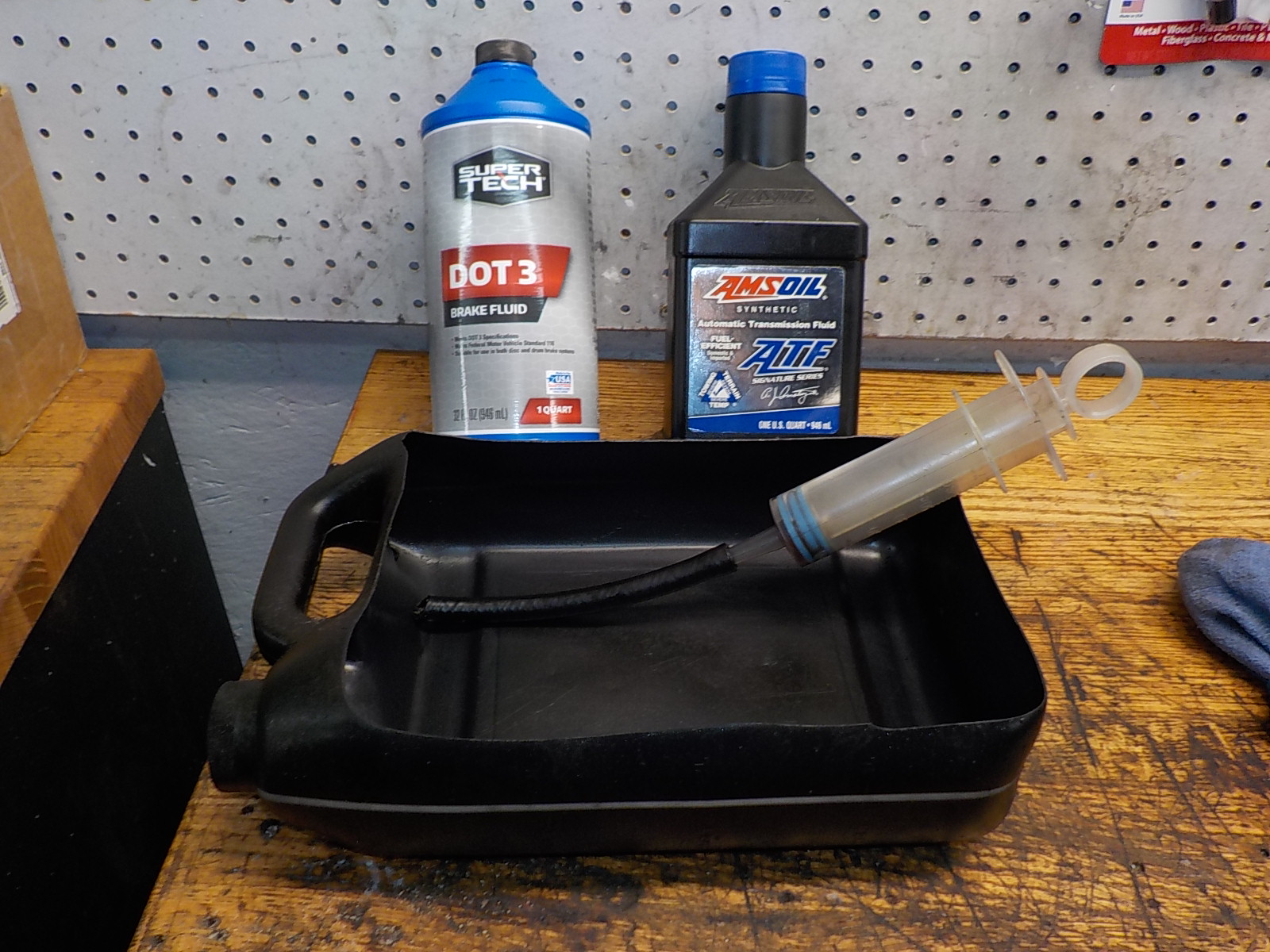

I suck out then replenish what I can out of the brake & PS reservoirs with a Tractor Supply 3 oz syringe.
Do you find the syringe degrades after use?
It seems that the things I use to move gas or lubricants tend to have the seals on the plungers swell and they offer quite a bit of resistance on the subsequent attempts at usage. The effort needed after the first use makes for nervous sessions.

D
No
The syringe in the picture I provided is at least 10 yrs old.
It's used for brake fluid and atf/ps fluid extraction at least 10 times/yr.
