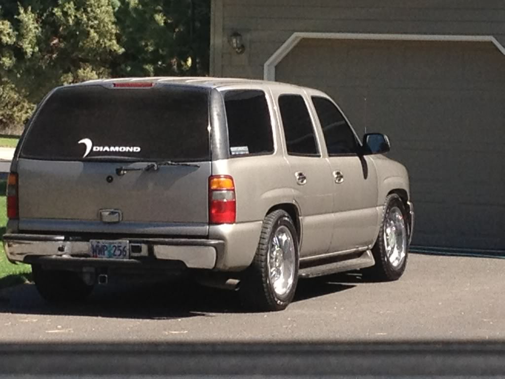

I got one con for BOTH sizes...tires are gonna basically be rubberbands on the rims which result in a very ****** ride
Yea deff gonna be rough ride. But how much worse can it get? It's got 20's right now with 45series tires and it already is super rough ride, well over bumps and bumpy roads. It glides like its floating on air on smooth roads.
And I was looking at the 25 series tires for the 26's... That should ride oh so nice haha would look sick though.
This is how she sits right now.
Thumbs up on the diamonds ;)
Beautiful ride....damn 45 on a 20.....ouch lol
I have had all kinds of different sizes and the ride difference isn't that noticeable.
Nah bro.....my hoe came with 265/70/17s and the difference is HUGE compared to my now 275/55/20....I would cry hitting what I hit in ny on 26's and I like my kidneys stirred not shaken :D
