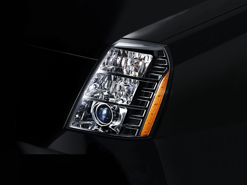

Threadjack:
How about compatibility between those sexy new Escalade headlights and Yukon headlights... is it possible?
