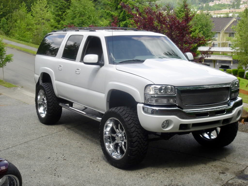

Oem cleared Denali headlights
eand28
May 6, 2017
250
283
Pennsylvania
45,012
As stated, OEM Denali headlights would be easiest and best quality-wise. Most cheaper aftermarket projector assemblies, even the aftermarket Denali copies, have projectors with subpar light focusing. The OEM projectors at least have been engineered to meet specific guidelines for focus and brightness. Also, as stated, the OEMs can be improved with quality aftermarket projector retrofits if you're not satisfied with their output. If you're gonna do a retrofit, you could get some of the higher quality aftermarket housings to save a few bucks over OEM housings.
