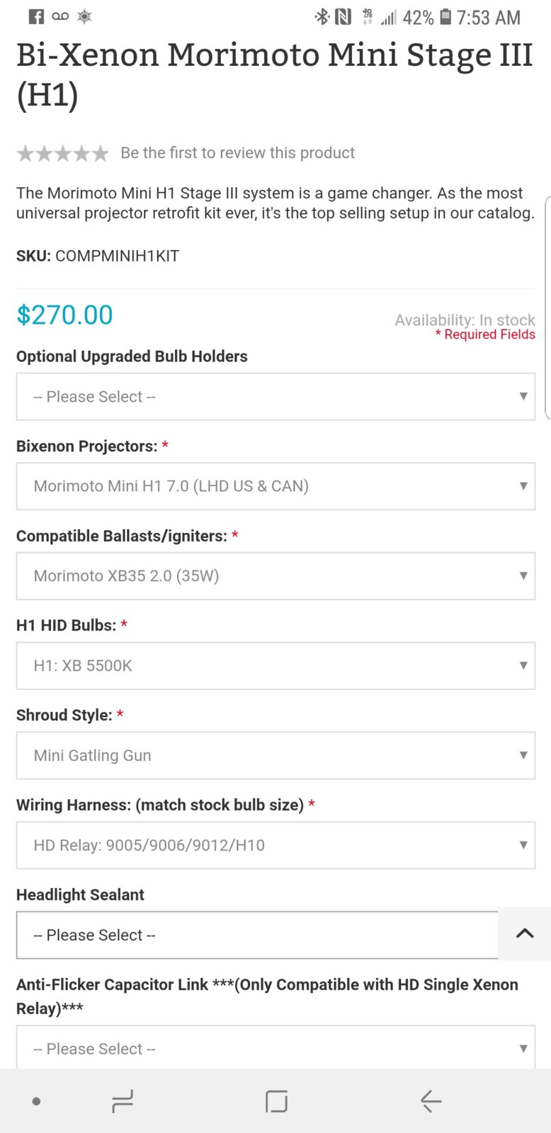

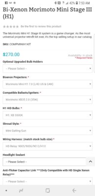

Reached out to Lightwerkz for a retrofit which I will probably do. Looking for opinions from guys who have experience with HID's with the proposed setup. I have listed them below. This is the only option available. Thanks fellas.
H1 7.0 bixenon projectors
Custom brackets
H1 HID bulbs
Hylux ballasts

As far as shopping list goes. I got these brackets.
https://custom-brackets-designs.mys...6-gmc-yukon-denali-mh1-7-0-retrofit-c-bracket which comes with hardware (I painted them with high heat black so they dont rust)
And I got the Morimoto MH1 7.0, Morimoto 35w kit with 5500k bulbs with harness. I recommend the high beam splitter for ease (unless you do what I did and modify the harness on the headlights).
https://www.lightwerkz.net/index.ph...al-kit/bi-xenon-morimoto-mini-stage-3-h1.html
With these options.

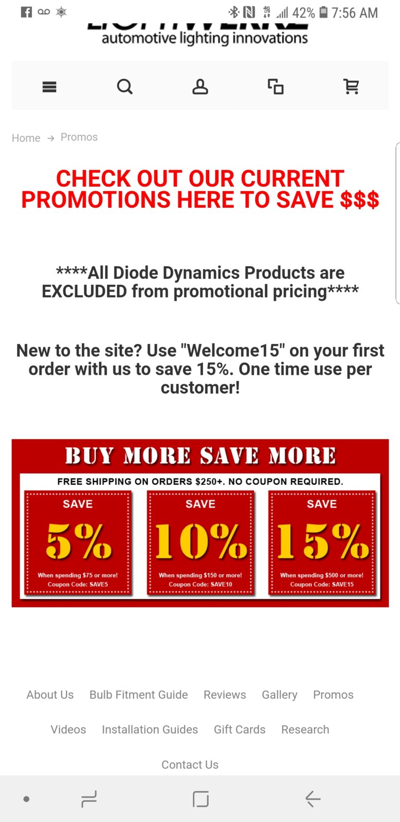

Oh yea. Use discount code "welcome15" to save a few buck selecting the options I posted I think brings it down to about 250 shipped plus the 66 for the brackets. That's a nice ser of lights for how much some ebay lights cost
