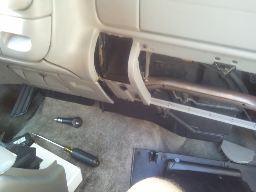

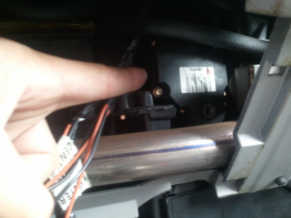

So with that said... Made a discovery 2day...
I found the 3rd accuator..!
But as you can see sunlitcomet was rite... With this obstruction in the way its damn near impossible 2 remove this thing...

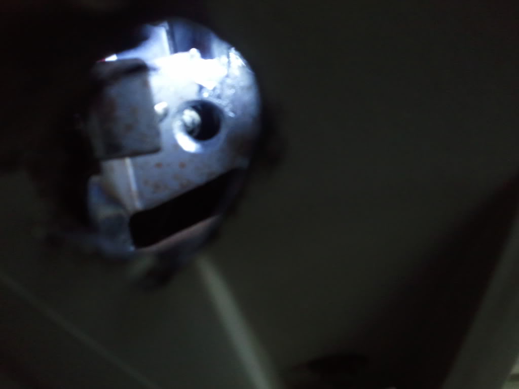

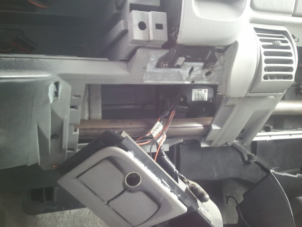

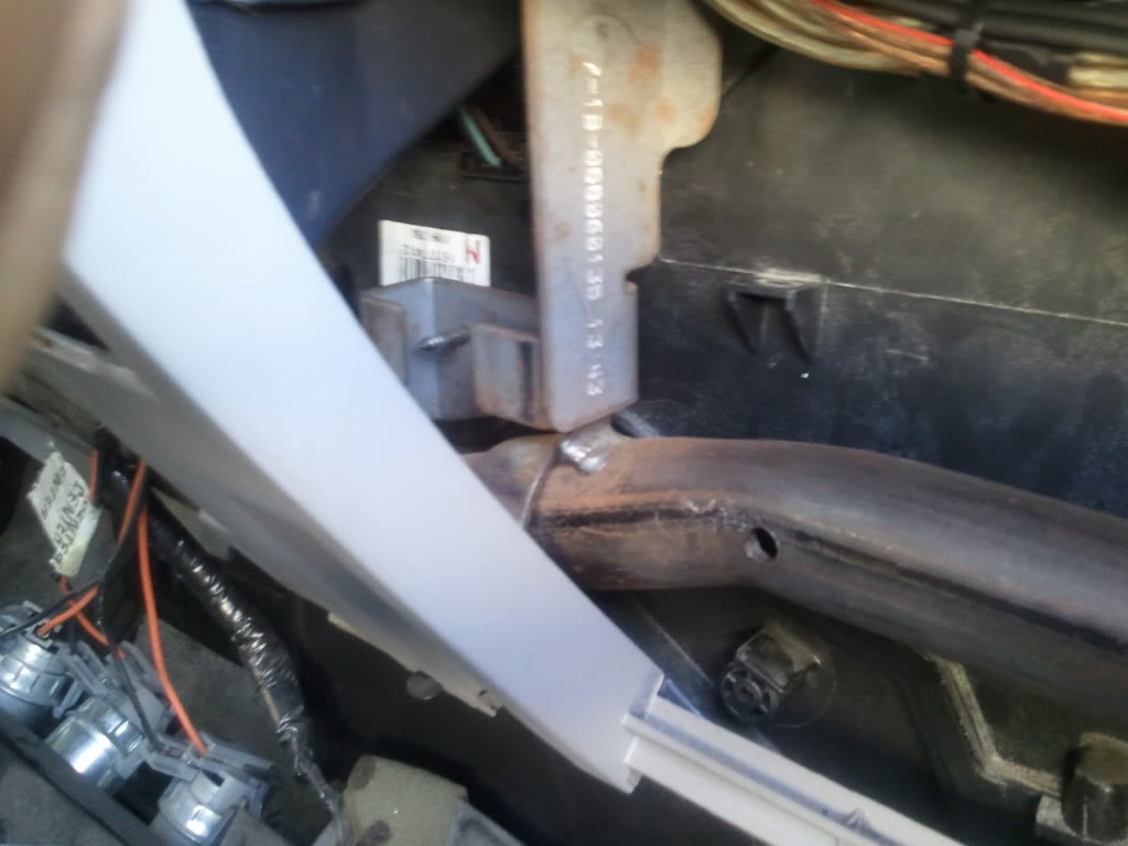

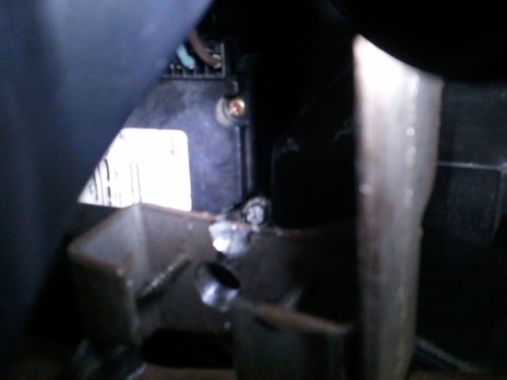

Sorry to leave you guys hanging... But this the progress...
So I was to chicken to remove the dash, so I drilled just under the A/C vent left of the glovebox...
And the metal braket behind that as well...
And vawla (im sure I misspelled that)..!
There she was...
And after all that it still didnt fix my problem... So a new HVAC unit is in store next...
