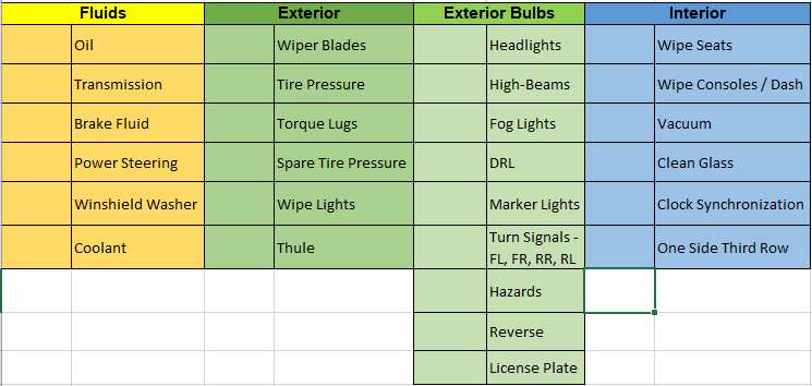

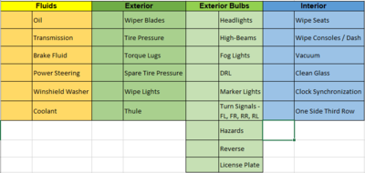

Hey all,
I have a 600 Miles road trip coming up this weekend. Headed to Bend Oregon to hit the Ale Trail for a buddy's bachelor party. As I'm getting the denali prepped. I figured I would throw a post on here and see what sorts of things you all do for pre-trip prep just in case I am missing anything. I've attached the usual list of what I check and sign off on before heading out.
**The one side third row is specific for the trip, but the rest is pretty standard for all trips.
Thanks!
Chris

check for any screws or nails in tires, inspect under vehicle drivetrain with a flashlight for leaks or missing parts, belts & hoses condition (including the front/rear heater core T's by firewall passenger side). and I always take into consideration the estimated remaining brake pads before a long trip.

That's a good thought, I don't know why I didn't think to include checking the belts / under carriage. The brakes is a good one too, those I know are good, I did a ful brake job last summer - Calipers, pads, discs. Only thing I didn't do that I wish I had is the SS lines. That may need to happen this summer.

For me:
1. Pack of various fuses.
2. Go through the actual process of removing the spare (to make sure everything releases as it should and all tools are present).
3. Flat wood block cut to add potentially needed support for jack on bottom, and one for extra lift on top if needed (depending on the scenario you're in and what the road surface looks like).
4. Simple but fairly complete tool kit
5. Zip ties
6. Duck Tape (made from real ducks)
7. Contractor bag (thick garbage bag)...to use with the duck tape if a window breaks or stops rolling up.

Great info here. And like that spreadsheet checklist as well.
Same stuff I did before my 2000 mile trip last week. And I did drop the spare to make sure it went up and down and that it was aired up. I see a few things you guys added that I will include on the next excursion. Thx for the reminder.

I drive a ~550mi round trip fairly regularly. Once a month give or take. Generally I'll just give a check over for tire pressures, fluids, leaks. But that being said I do my own maintenance and have a good idea where everything else is from memory. Nothing is more than 100-150 hours/3-3.5kmmi of run time since I last laid hands on it (my own service intervals)
If you're not sure: Here's a good list
Rack it up, give a shakedown. Check for freeplay in wheel bearings, steering components, torque wheels and wheel bearings.
Check brake pads, calipers, hoses, brake fluid, e-brake actuation
Check tire pressure incl. spare. Check for foreign objects
Double check engine oil, p/s, trans, coolant, diff fluids, t-case, condition of air filter, make sure all intake hoses are secure. Give the engine a start and listen for any peculiar noises, check oil pressure.
Verify 4wd operation if applicable
Inspect radiator, WP, hoses, heater core connections incl. rear
Check belts
Check for any fluid leaks
Check wipers if it's been a while since you've used 'em and don't know how they're doing
Verify all exterior lighting
Check heat, a/c, defroster operation
Have battery/alternator tested and verify condition of cables and visible grounds.
If you have any check engine codes, take a peek and see if it's something you need to deal with immediately.
Check alignment if you've not done so recently.
If you don't have a roadside kit, I'd suggest getting one. Mine has a multi tool, blanket, flares, reflectors, air compressor, fix a flat. I also have a jump pack with me and a fairly extensive hand-tool kit I've pieced together.
Oh, and grab a clean, dry microfiber and buff the shit out of your interior glass. You'd be surprised the scunge that builds up without realizing!

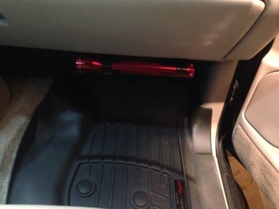

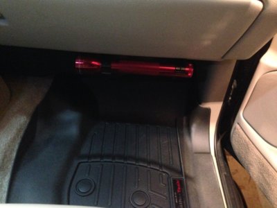

I would have and do all thats listed-and i like to make sure you have a light with fresh batteries.
I have the same red mag light mounted there in my tahoe. I just grab it and throw it in the denali when I take it on trips. My wife didn't want one mounted under the glove box like that... Still not sure why...
