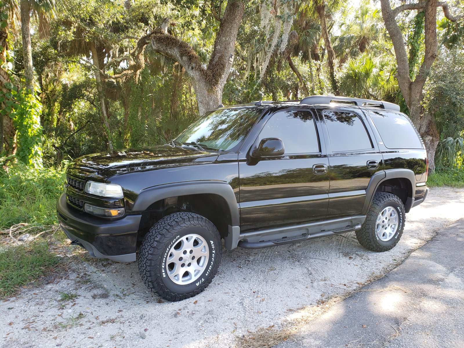

Oil is clean and has regular interval changes. Tahoe has been gone through from top to bottom and has 308k on the clock with original paint.
