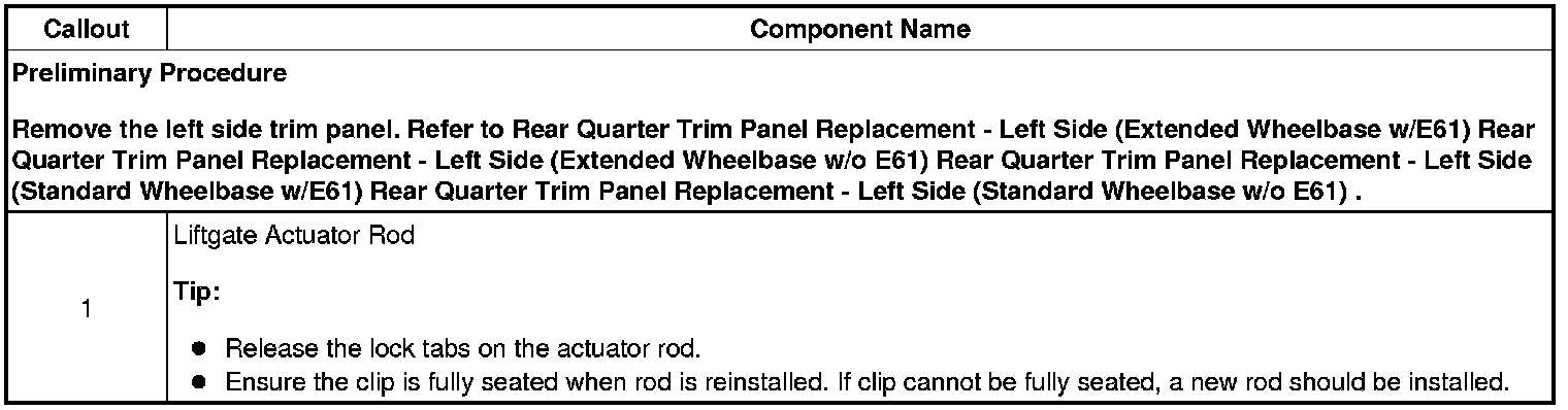

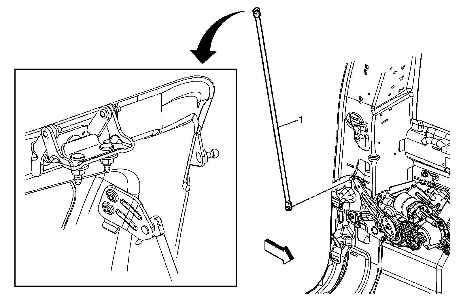

Sounds like it should have a clip like the top part. ? I haven't looked myself..
Need to remove trim panel first.
Images below from charm.li
