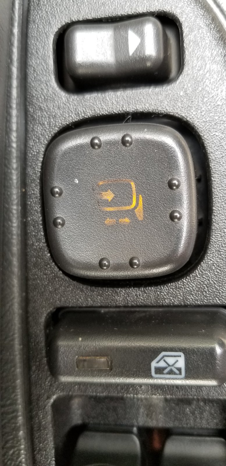

All Denalis have powerfold mirrors originally. Does your switch look like this?

Does the center of your mirror button light up, like in the pic? Should work with the truck off too.

My switch does not light... so maybe it is bad.... I do not hear the motor even trying to move them in, even when I help it manually... but there is no hesitation moving them back out, hit the button, they move fine...

Is it the same exact switch as in the pic? If not that may be why it's not working. It might've been swapped by a non power folding switch for some reason. Is that mirror icon in the center of it?

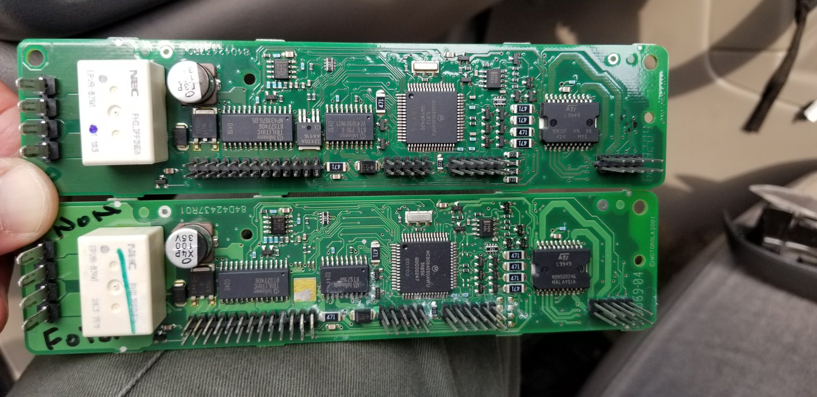

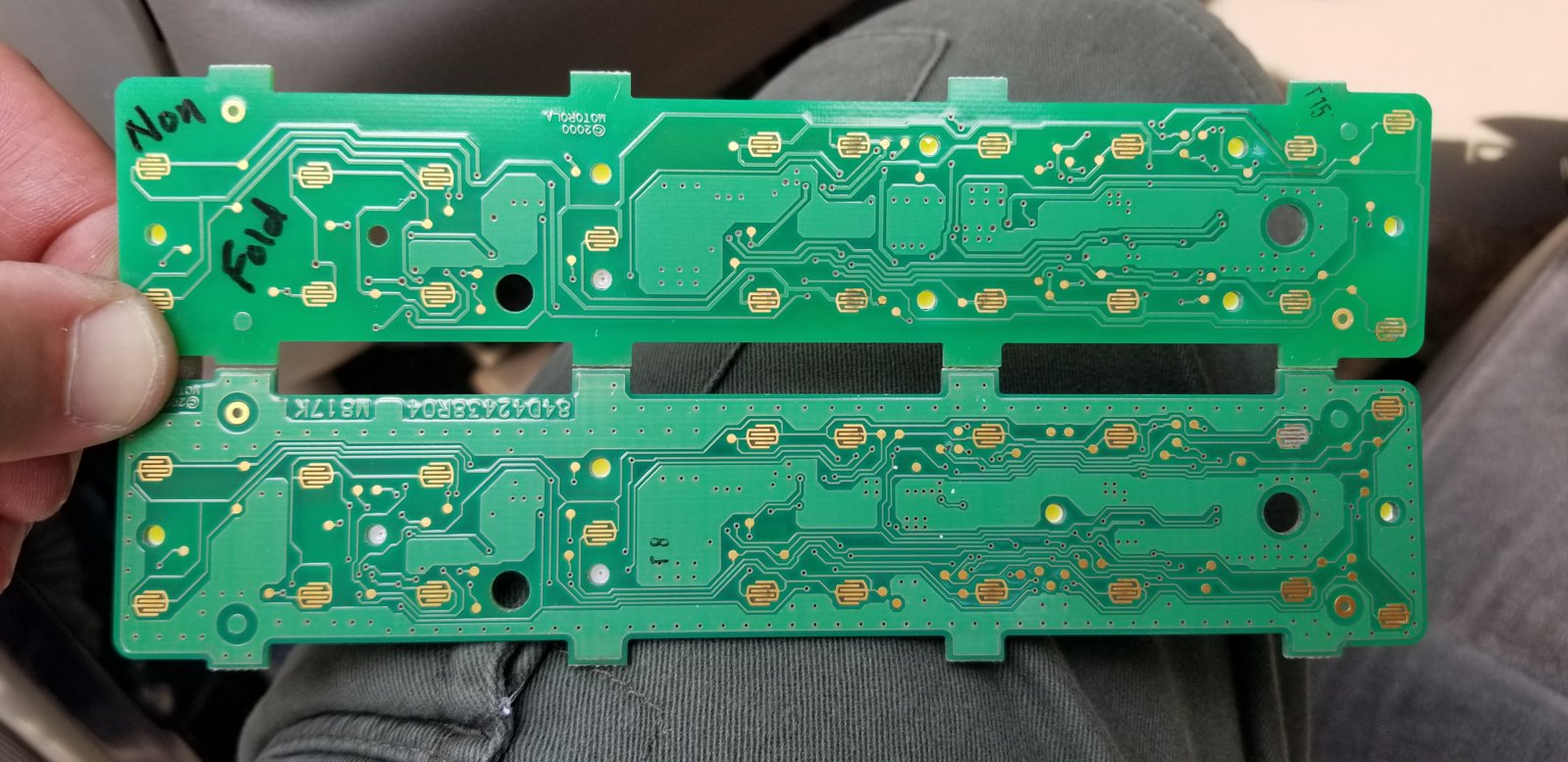

I had a similar issue with a switch. I took it apart and there was some corrosion on the brass contact. Cleaned it up, and it still works.
26,678
52,943
I had a similar issue with a switch. I took it apart and there was some corrosion on the brass contact. Cleaned it up, and it still works.View attachment 211229 View attachment 211230
Nice. Mine wasn't corroded, on either. They would actually work if I pushed hard enough on the switch. Very obnoxious when I would hit all 4 down at the same time and one would stay up. The aftermarket one... brand new wouldn't even fit into the bezel without trimming with a razor knife. After I got it to fit, one of the switches had the same exact symptom , brand new (different switch than original) so I used a tiny piece of plastic to shim it and it worked every time. Then after a month the same symptom hit the driver side front. That's when I gave up on aftermarket. The OEM one was the driver front and was just worn out. Hopefully the new OEM keeps working, it had better for $30.
