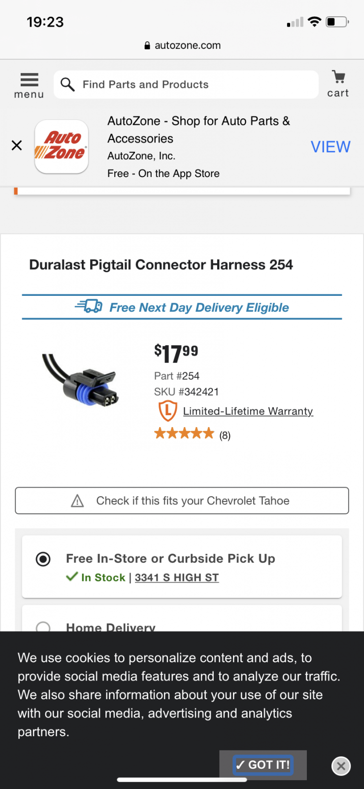

lol these are funny.....
does it have voltage with the key on or off?
what is the ohm reading between the pins? key on/off
short the 2 pins together turn the key on and see if anything pops up on the cluster
my money is on deleted coolant reservoir level sensor, my 2005 does not have one

Sure looks like the coolant level sensor plug

Based on the original photo, and the fact that mine doesn't have that extra connector, the surge tank would have to be on or near the firewall. My surge tank is probably 2 or 3 feet away from the firewall, up closer to the radiator.

I guess that it could, but my vehicle harness plugs right into the bottom of the surge tank (the sensor). Hard to believe that an extra connection would be added. The penny-pinchers would not be happy. Bet your surge tank has its own local connection.

when I changed the tank on the 05 the new tank had a sensor but there was no harness I thought maybe it had been cut off or something the same harness goes all the way up the front
