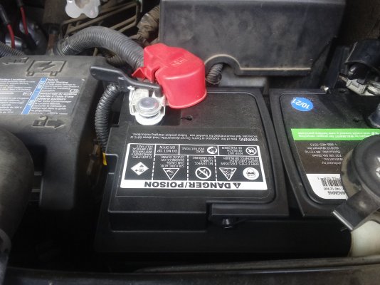

make sure it's sitting FULLY seated to the post and clean clean it good with the battery cleaner tools...

MAKE SURE TO DISCONNECT the 12V+ battery before cleaning to avoid shorting anything out

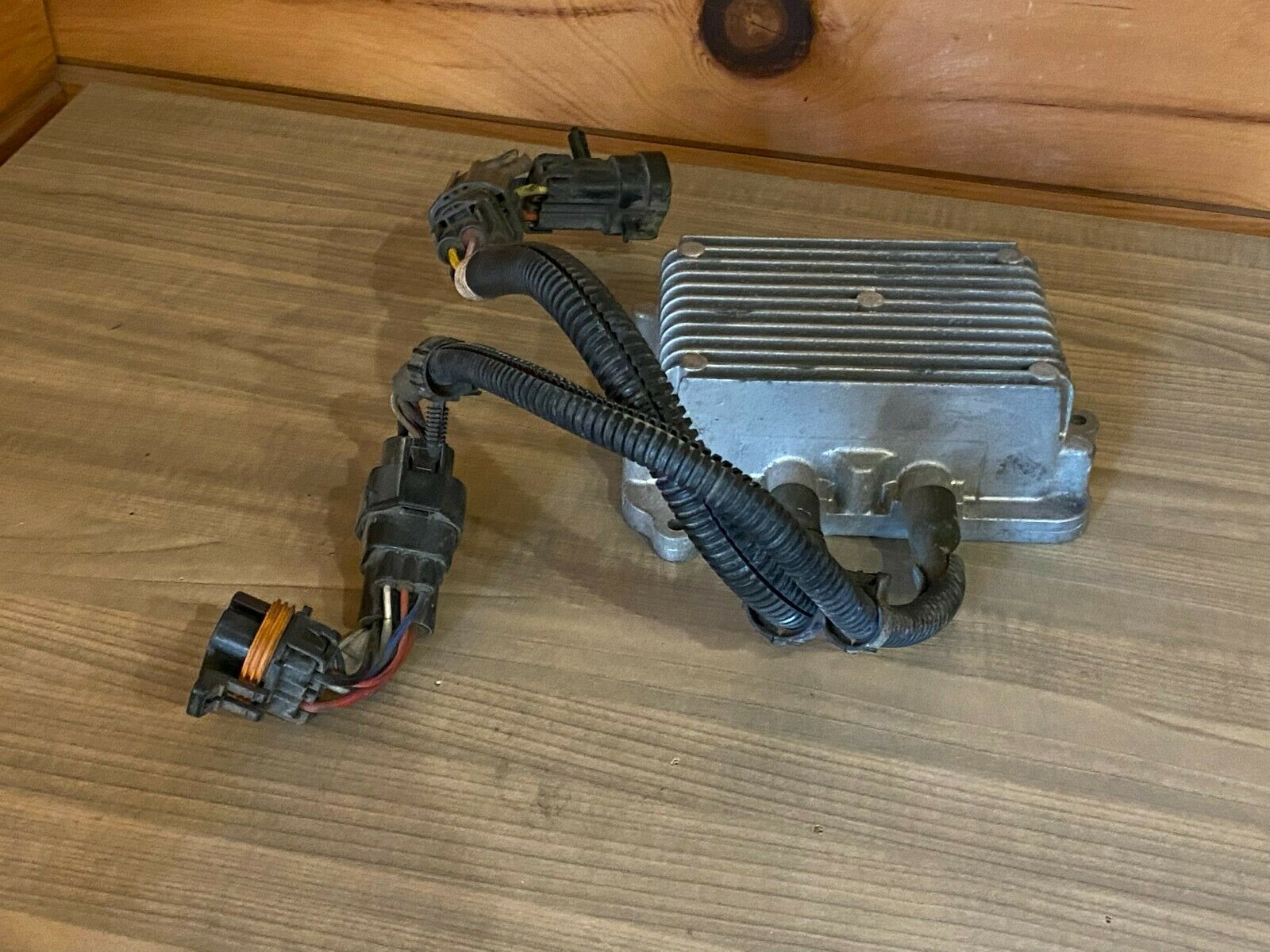

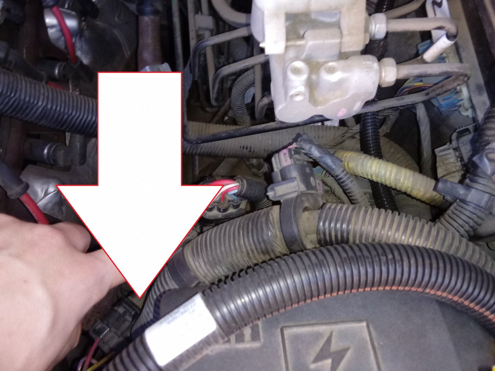

ALSO clean the connector on the 3 phase AC /DC converter input side as well (assuming you get the terminal cleaning tool)
follow the cords to find it it's buried :)
