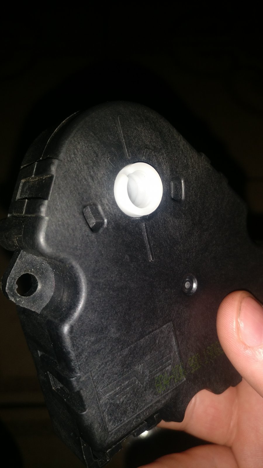

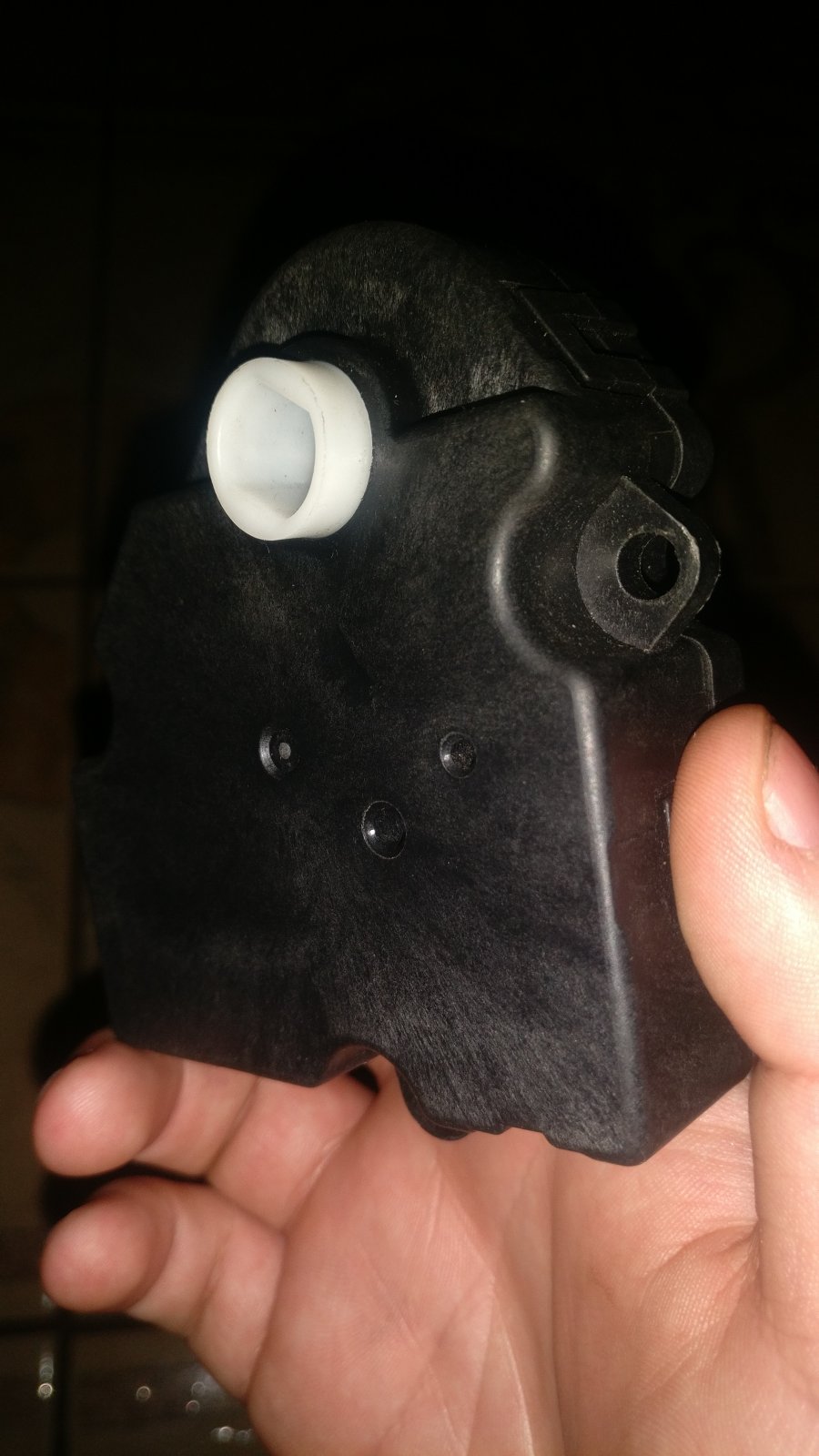

15868318482923801884431415033050.jpg 15868370774221913304255334884012.jpg Do you remove the white plastic piece of the actuator or leave it as is. Just trying to be as careful as possible and not break it by accident

leave it, that's part of the actuator besides you couldn't get that off or out without opening it up and then you would see it is part of the gear inside

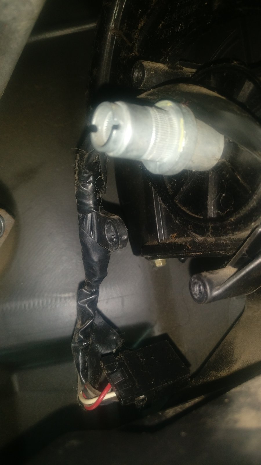

Thank you! But i have this metal gear but that prevents me from putting this new piece in. It seems to be attached to plate behind it. What's up with that?

the gear is notched, you may have to turn the gear to match up with the notch on the new actuator, then it will slide on.

That metal piece is what's blocking me

i see what's going on now, take a pair of pliers and pull that metal piece off that you show sticking out in your photo, then your actuator will go on, looks like the old actuator just came completely apart and left the gear behind. go easy and wiggle it off you don't want to break that piece that it is attached to.

Yep got it off. I've put the new piece on and I finally have air blowing through after five years! This forum is absolutely fantastic!
