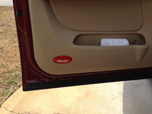

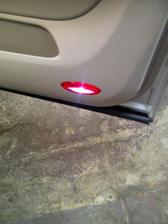

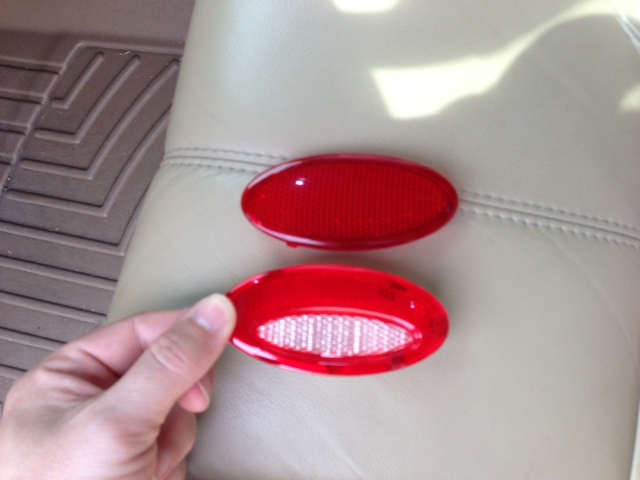

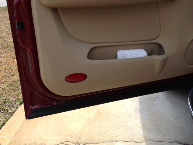

Just did this today, part numbers above are correct and include everything you need. I'll explain the wiring in detail later. I also put cool white LEDs (194 bulbs) in there like the rest of my truck.

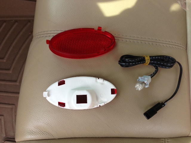

Alright, so it's really hard to get pictures of it, but what I did was ground one of the wires to a ground wire in the window harness. Then, for the power wire I ran it all the way through he door grommet to underneath the drivers side dash. You "could" wire it to the puddle light on your door itself, and I'm pretty sure that's what the OP's shop did, but then it will ONLY come on at night when the puddles come on. I wanted them to come on when my interior lights came on.
Underneath the drivers side dash, directly behind he parking brake is a computer box with 5-6 different color plugs coming off it. Grab the set of wires that come off the white plug towards the top. In the harness will be a solid grey wire, that's your interior lights, T in to it and that wire is the wire you want.
