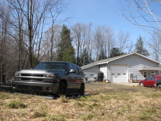

I got pretty far on my turbo set-up this weekend so I figured I would post up some pictures of the progress so far.....
Here is where my Tahoe has been sitting for over a year with no motor. so you can imagine the frame is pretty rusted.
