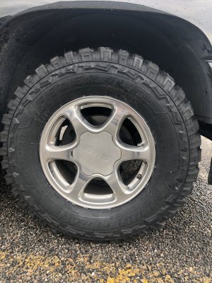

effeckt,
yes stock suspension, and the only rubbing i get is at full lock one way... the driverside wheel well has a slight bulge for the washer res. so it rubs just enough to take any dirt off the wheel well

Whats the tallest tire I can put on these stock rims to fill up the wheel well? Will 285s be the tallest?
massivespl
I'm not mean, I'm honest.
Nov 25, 2013
2,197
1,876
Michigan
My buddy has 285/65/20 stock Tahoe just keys in front no rub
I've had 305/55/20 no rub
285/70/17 no rub with+12 offset.
305/45/22 no rub
275/65/20 no rub
33x12.50x20 no rub
Right I'm 33" off the ground with 305/35/24 no rub at all.

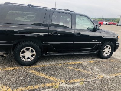

I am getting new tires and maybe wheels for my Tahoe. I wanna see what the bigger tires look like and hear your opinions on what sizes will fit under the stock suspension. I want to keep stock wheels and suspension and fill that wheel Gap. I want to go with a 32 inch tire or a 285. I also want them to be a little wider with no problems. Not too wide but wider than the 265/70/17's what is taller and wider that will fit a stock truck? Also I wanna see some pics of your stock Tahoes with your bigger tires. I am also new here and my name is miles. I live in Athens Ga:Handshake:
Mine before lift with 285/45r22.
All terrains. Around 32.1 inch
No rubbing. Great handling.
I like Highway tires better
Now I have 3" lift in front and 305/45r22 AT and they rub
