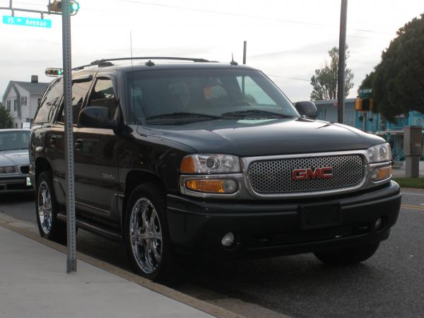

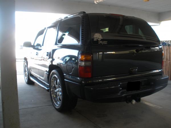

I've got 305/45/22s, ie a 33" tire...
but my hoe has factory flares.
Shot of general fitment
Better overall shot?
Full Lock and off camber (ie out of driveway) it barely kisses the liner on just one side.
Just enough to wipe the dirt away.
